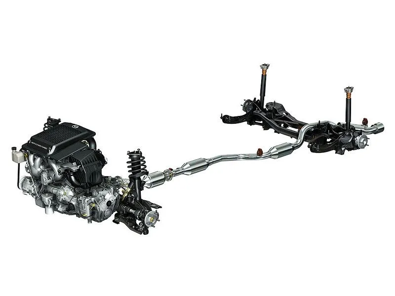

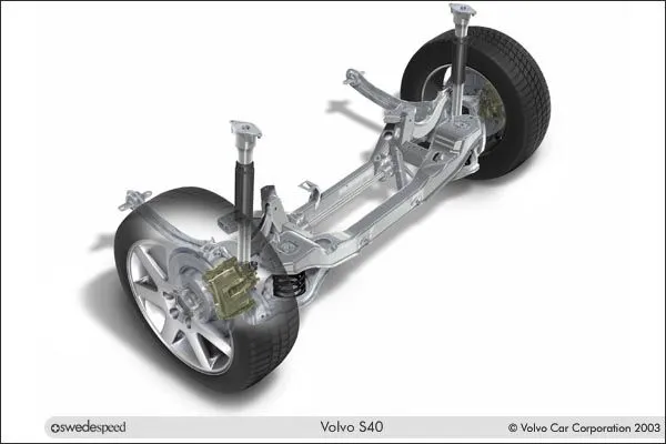

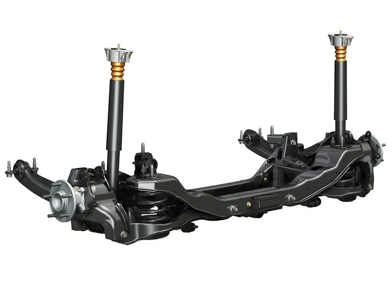

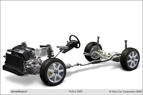

And for the Volvo s40 setup, I found a couple of pics for the suspension layout, but the pics are for the fwd model. Looking at this pics, the layout is very similar to the ms3, I dare and say, the same? These are ms3 and S40 pics for comparison.
