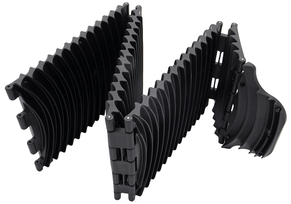

Although being high centered doesn't help it would have been TCS off and I would have doing some braking along with the gas pedal to send power to wheels with grip.
I also keep a set of these GoTreads with me. They fold up nicely too, have a lifetime warranty even if you find a way to destroy them and are stout enough to be used with 18 wheelers and military vehicles.
https://gotreads.com/
