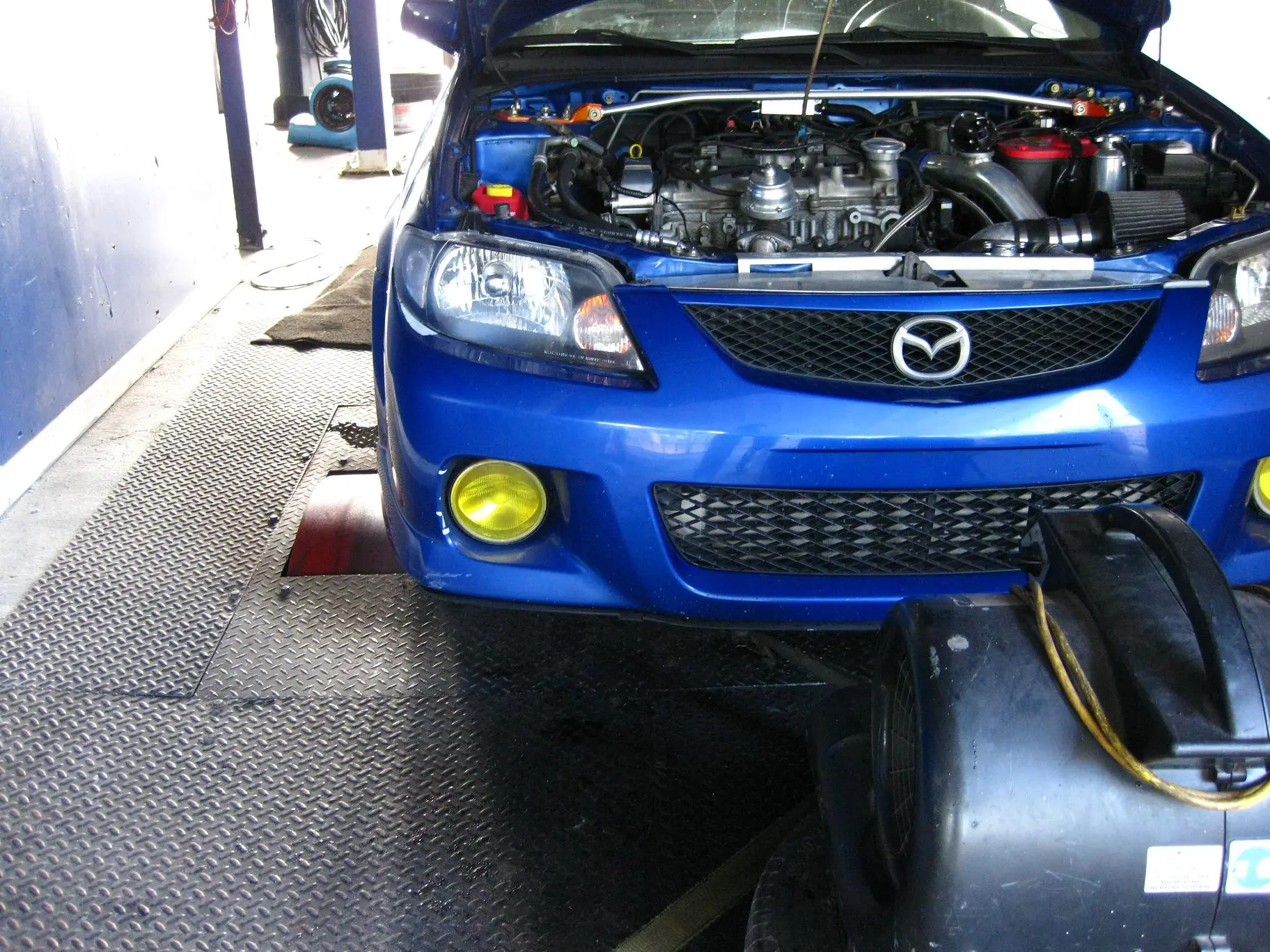

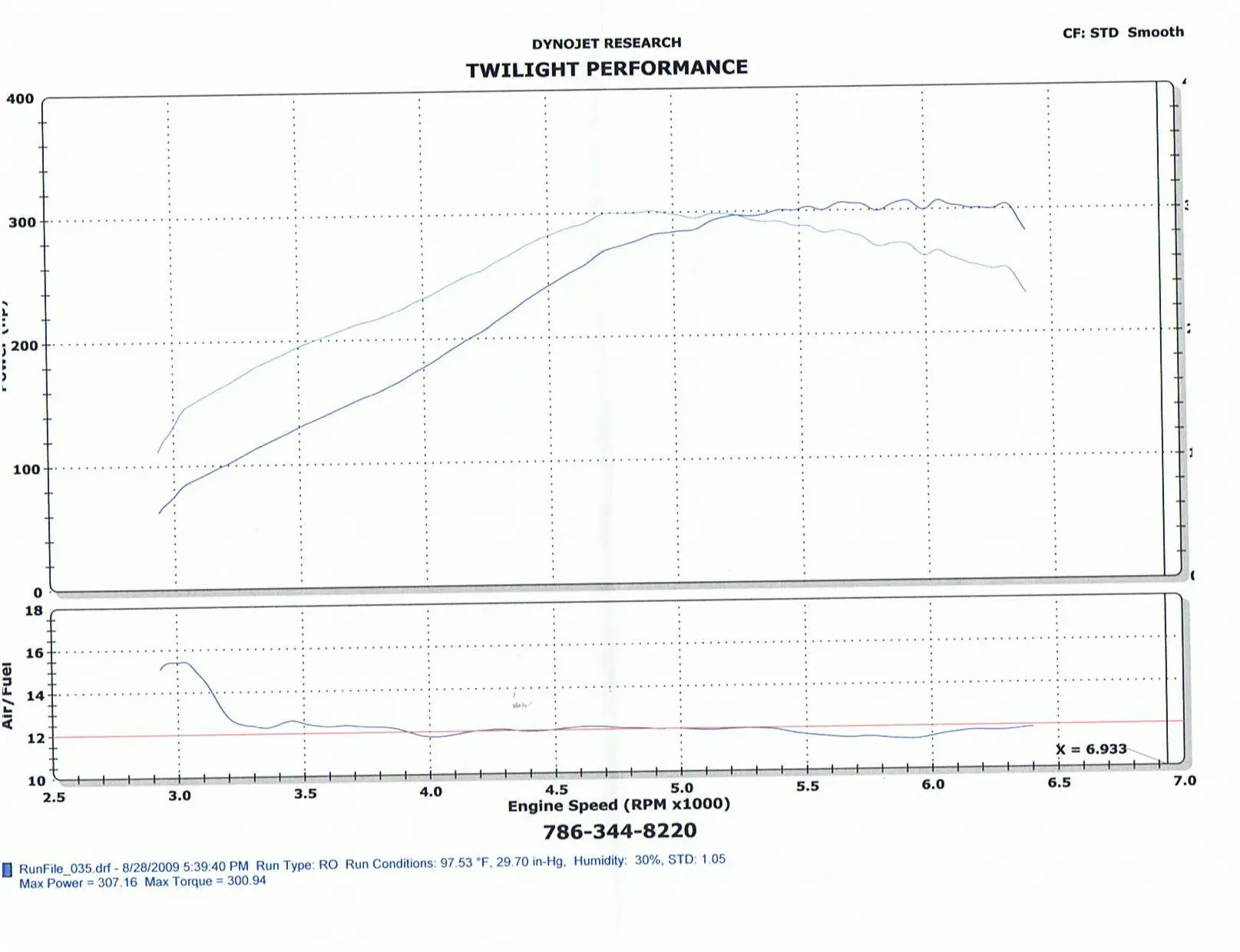

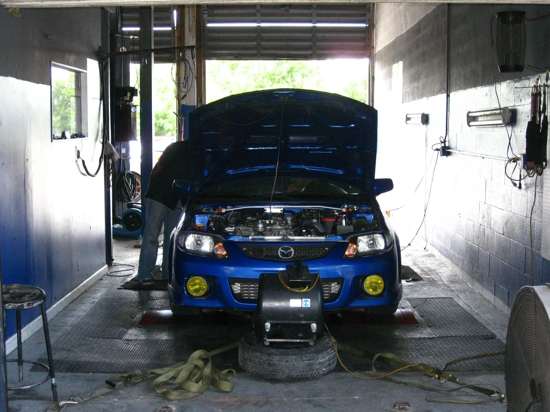

So I was able to sell the F10X and now am running the E8. Im glad I went ahead and got this system in because the car off the line pulls SO hard with the timing retarded and also the advanced timing with the Methanol Installed is great up top. Went to the Dyno and made little more than my target goal of 300 wheel, ended the day with a tune for 12PSI at around 260ish and 17PSI at 307WHP and 300WTQ. The tune still needs to be worked on though imo but im very happy with the results. I want to go back and get my Wideband installed to the E8 and also setup the launch control possibly and definitely want to take advantage of the anti-lag feature. Here are some pics, want to hit up the track soon to record some videos.
ENJOY!!

Glad you decided to listen to me, and keep the E8. Those are some pretty good numbers for the boost you are running. The Anti-Lag, I wouldn't use. It is hard on the manifold, and the valves.
