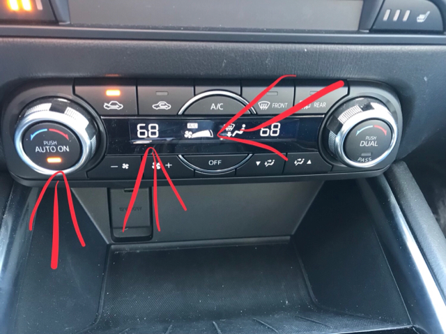

Exhibit A
It wasn’t blowing cold. This was after the engine was warmed up and 15 F outside.
I’m showing you don’t need to set it to 90 for it to heat aggressively once the engine is warm enough. I say it’s working properly.

Thanks for the pdfs!, but if I understand correctly, since US models don't have ECO feature nor a humidity sensor, AC on probably indicates compressor running.
I don’t think so as it’s not safe to run in sub freezing temps and even when it was -15 F here mine said ac on. I think it just always says that in auto. We should stop reading into it.
In the one instance I had my ac running I could hear the compressor cycling off and on. It must be the typical Nippondenso compressors as the sound they make is obvious
I think AC on is driver permission to the car to use AC as necessary. AC off, means compressor will not come on.
