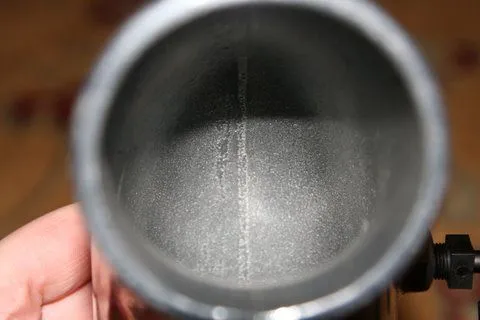

Atp wont fit unless you do some of your own fitting..... I tried it with the MSCAI and the COBB SRI both a no go. Also the angles are all off they dont provide enough silicone tubing and send the wrong size(I.D.). I called them and they sent me 2' of extra tube but the angles are all off as well as the (I.D. of the tubing for stock fitment) for the stock BPV placement. I think its more suited for there FMIC kit as it moves the location of the BPV. The kit was just not designed for stock fitment ITS GOING BACK!

I did speak to ATP's Tec for about 20 min and we went over the issues at hand and he did agree with me that the kit needed a little wk for aftermarket SRI and stock BPV placement, they even sent me 2 extra feet of there silicone tubing free to see if I could get it to work. I could have yes, but like I said b4 I would much rather have a kit that fits rather then a kit that I "make" fit. We agreed that it was more meant to work with there FMIC kit. They were very understanding about having the product returned (as they should be)
With all that said the Install was not hard at all I had the car apart in about 30 min (YES YES you need to remove the batt tray makes life easy)

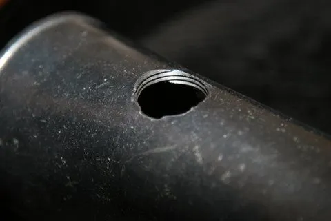

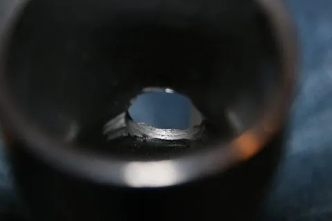

in the last pic its hard to capture but the inside lip is not all grinded smooth its all jagged
