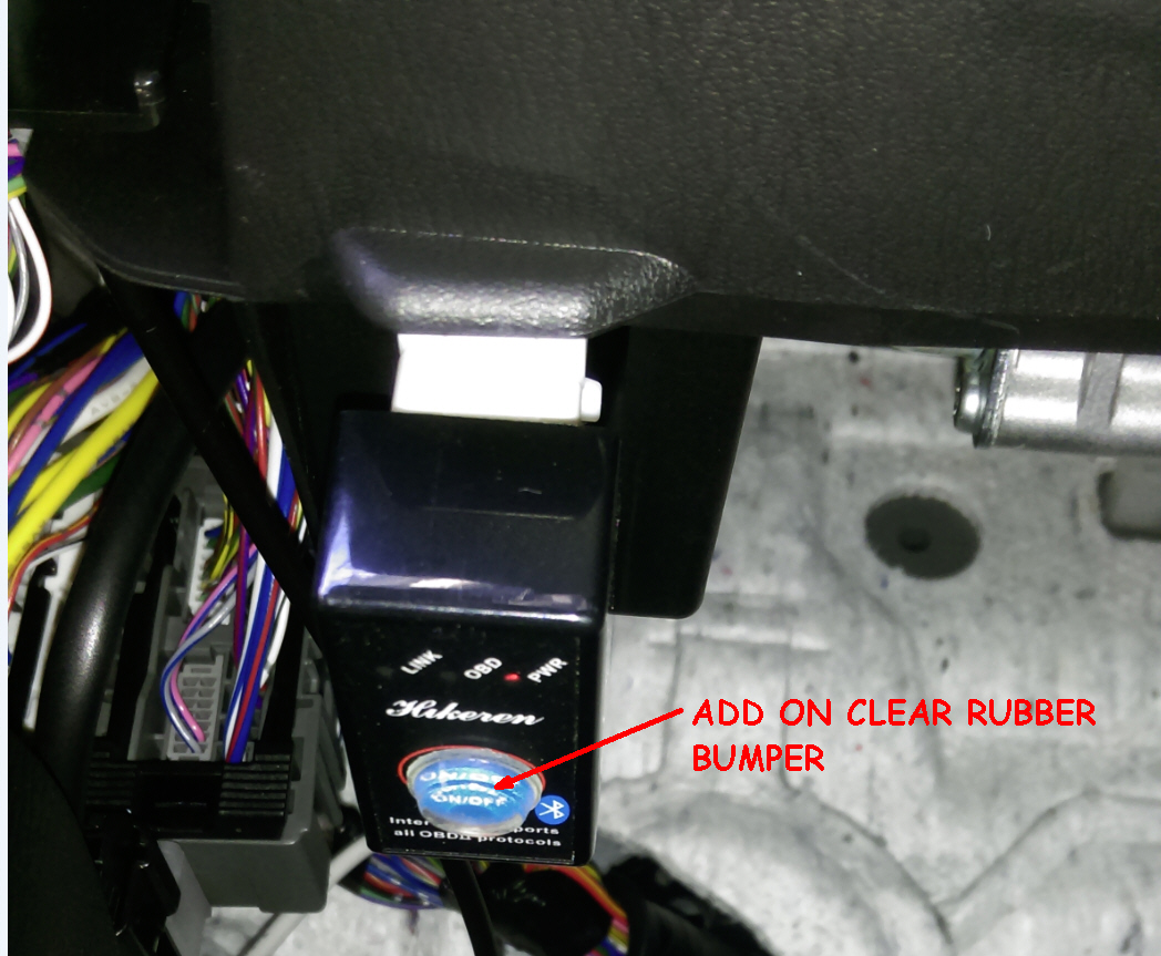

This is the Hikeren installed in the CX-5, I added a clear rubber bumper (you can get at any hardware store or even the local RiteAid/CVS) for a no look on / off operation, all these type of bluetooth scanners continue to draw battery current even after engine is off so it is good to have an off on switch. the CX-5 OBDII white plug is just above the driver's left knee, you just plug the Hikeren into that and make sure the red LED is lit

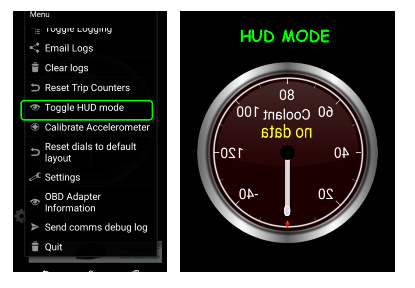

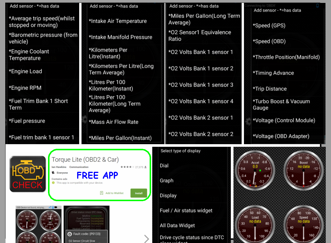

You will need to download a free app called TORQUE LITE (APP), these are examples of what it can read
There's also a HUD mode, so you can monitor what ever you want while you drive, in this case, it's the ATF coolant , you place your smartphone up against windshield and reflection will show as HUD, it works better at night when it is dark
and finally, these are my 2016.5 CX-5 readings, I have never drained my ATF before and my car a relatively new 12,000 odometer miles, coolant reads as 69C after driving for 20 minutes and all my DTC emissions are good to go for inspection
