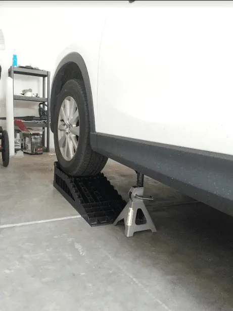

Lifted via: Sceptor ProRamps Model# 08226, HF jackstands as backup, wheel chokes.

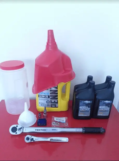

Fluids, filters, other: 5-quart bottle Pennzoil Platinum 0w20, 4 quarts Mazda FZ transmission fluid (blue). WIX 57002 for Skyactiv engines, Pennzoil oil wrench, ziplock bag, 9-quart oil container, Dollar store 4-quart clear container with markers an 4-inch wide cooking funnel, rubber gloves, rags, ATF drain plug washer (same part# as engine oil drain plug washer).
Tools: Tekton torque wrench, regular craftsman ratchet, 10mm socket, 8mm hex socket, 3/8 to 1/2 inch adapter, 3/8 extention, flat head screwdriver, OBD2 Bluetooth scanner, flashlight.

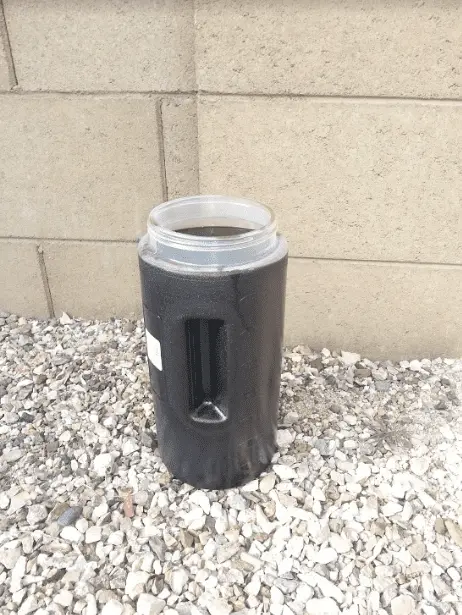

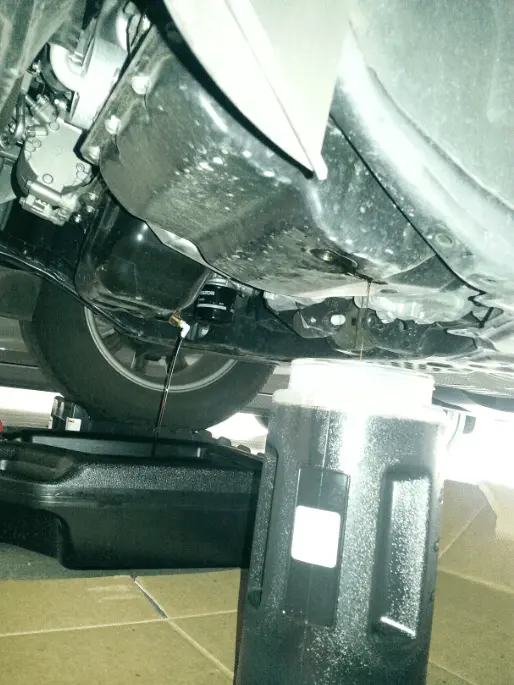

Amount of ATF "I removed": 4 quarts measured. Likely explanation: I used ramps. I noticed that both the engine oil pan and the transmission oil pans had plugs designed with a bias for being angled back. Ramp raised the front 8.27 inches.
I poured 4 quarts of new ATF and the dipstick measurements were consistent prior to my ATF exchange session. A bit high. Glad I torqued drain plug at 25lbs. I removed a tad bit of fluid from the drain plug. Re torqued drain plug at 29lbs. I remeasured at 147F while engine is running and the dipstick fluid measurement is now in spec. Just at the "high line" going up to 154F. In spec at 122F.
ATF Drain plug washer torque spec: 22-30lbs.

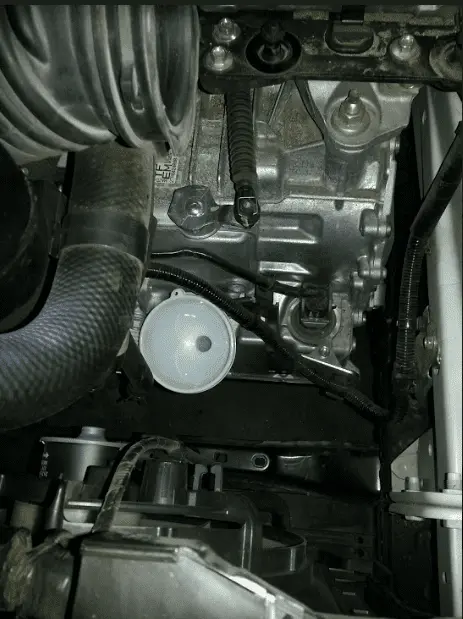

I would like to sometime create an entry point/door for the ATF plug. It saves a good 20 minutes not removing and installing the splash shield.

Items used:

I agree that safety should always come first but using jack stands with ramps is unnecessary. Of course it doesn't hurt anything either.
My wife's co-worker recently died. Last time she saw him he was heading home from work to work on his car. I don't know the specifics. His car collapsed on him that night. His kid discovered him. Had a wife and 2 little kids. Sad story really and totally avoidable. Working on cars, always safety first. The best we can do is 1. spread the word. 2 practice what we preach on car safety. Who knows, maybe someone may just listen.
These ramps are exceptionally tougher than Rhino ramps you see at Oreilly's or Pep Boys (local auto stores here in the states). The design is very stout. Made in Canada by Sceptor. I use wheel chokes for the rear wheels. I purchased the jack stands as more of a visual reassurance for my wife really. But also as a backup. Adds a few steps to the process but you can't be too safe. http://www.scepterconsumer.com/auto_accessories/autoramps/
oh man, that's rough, agreed safety always first, I think your ramp/jack stand set up is good, I kind of like Avidien's set-up, 4 inch solid concrete blocks with quality chokes on rear wheels........ I'd probably get 3 blocks for each wheel just so the wheel rests on one solid block in the middle rather than resting between the gap of two blocks though.

also don't trust jackstands by themselves, always have backup, they do fail sometimes
I'm kind of weary of using cinder blocks or concrete blocks. I guess the heavier the better. Though you never know when they'll break. I wonder if you can buy something like thick solid rubber mats or solid metal blocks- nah that would be heavy and aluminum blocks are expensive. I think investing in good quality ramps like the ones I've got or expensive race ramps (a bit out of my price range )are good investments if used a couple times a year and will last a very long time.
