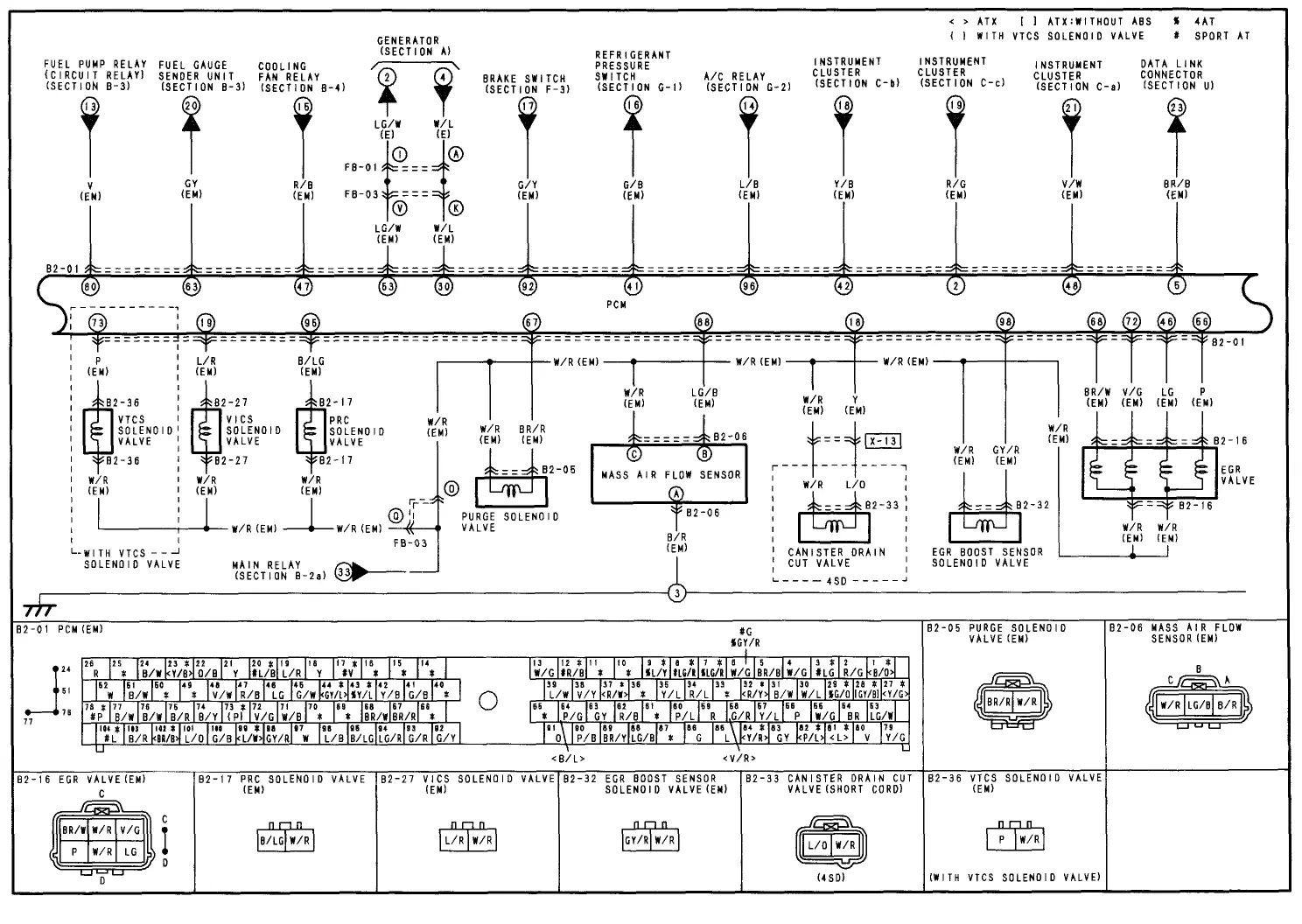

OK so all hope is not lost I think the information on the MAF sensor wire to tap into was wrong. Anyone have any recent pinouts of the P5 ecu?? Or does anyone know if we use the same or similar MAF as a Miata? Can someone anyone contribute something? Flying MIATA sells something that will allow me to tune the S-AFC at full throttle. I just need to figure out some things. Oh for pics of it go here http://groups.msn.com/MINDGAME/shoebox.msnw

Yes I think the diagram I got here was wrong......well the only wrong one seems to be the MAF pinout. A guy at mu local dyno shop suggested that the wire that is tapped into is wrong because with the key on and when doing a sensor check with the S-AFC, there is a voltage reading of ~5.5. Now the guy said that the correct wire would not have a voltage this high with the key turned on. So there can only be 2 more possible wires I think. They will be looking at my car soon to determine the problem.

ProtegePoe I got a copy of the ECU diagram maybe this might be of help... If the wire in question is the Mass air flow sensor wire it shows here that it's wire no.88

OK I will say this again and again the S-AFC WILL NOT WORK ON A PROTEGE the S-AFC only read 0-5V or 5-0V MAF voltages period the protege is 5-10V so stop trying it DOESN"T WORK!!!!!!!!!!! SEARCH!!!!!!!!!!!!!
I did, I was there when that thread came up back then, chill man, where did you get the information about the MAF voltages readings? I started it back up only because I also heard others saying APEXi indeed have a fuel map programmed in their S-AFC for Protege (which I don't really believe but who know if you don't find out yourself first hand?)
