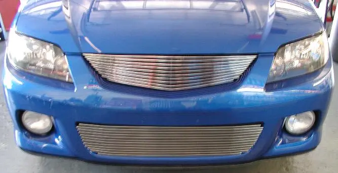

Mods:
Billet Grilles
Altezza Litez
Hose Techniques
MHP Carbon Fiber CAI
NOS Port System
Dual Thumper Sas System
Folia Tec Caliper Paint
Speed Bleedrz
Redline Synthetic M&T Fluid
Auto Sunroof
