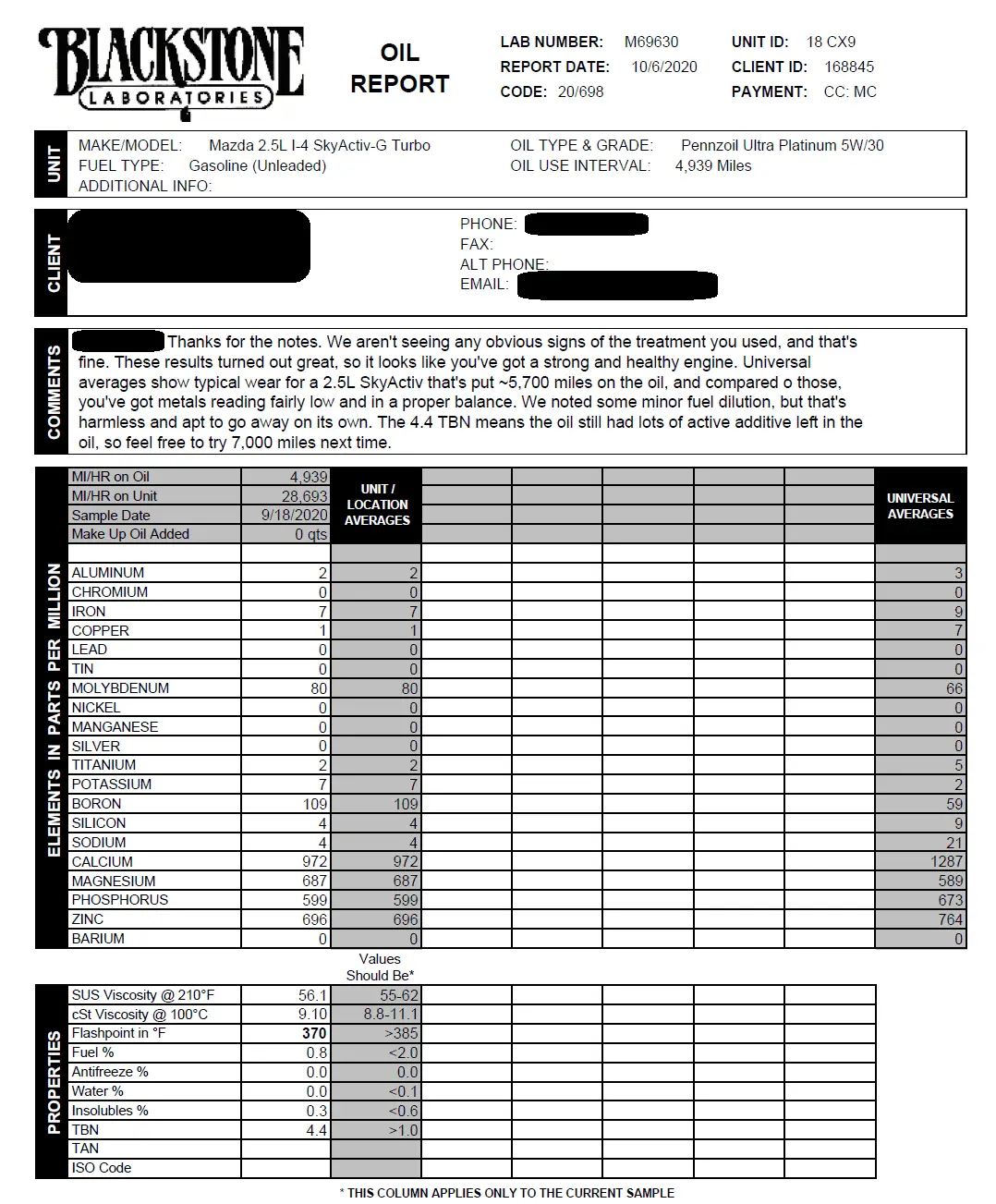

Yah yah yah, I type a lot, but my responses are thorough. You want more power without sacraficing reliablilty? STOP using K&N filters, CAI's etc. on non-performance cars. Focus on maintenance and reducing friction losses through the use of In Situ Hydrogenated DLC coatings and run motor oils that use MoDTC (organin moly) additives like many of the newer formulations from Penzoil, Valvoline, Mobil 1 etc. You don't need AMSOIL etc. or other boutique oils that cost 2x to 3x, just find something that has UOA's showing a decent amount of Moly.
In regards to Hydrogenated DLC coatings, in particular I'm referencing TriboTEX (Synthetic Magnesium Silicate Hydroxide) which has undergone extensive R&D (SBIR phase 1 and 2, multiple ASTM tests, Wedeven Hypoid Gear test etc.). There are engine and gearbox formulations now available. You'd be surprise at how much power you can pick up by reducing friction losses all without messing with gear, ECU calibrations, intakes etc.
The research data is attached to this post. I have more that what's below, but that's a good start. Researching Tribology isn't for everyone (yes, I have a degree in Electrical Engineering and I"m an auto enthusiast, so I apply my ability to learn to other fields as well).
This is not an oil additive. It is a DLC coating that forms in operation and reaches super lubricity levels. Typically lasts around 40k miles depending on application in ICE's (Internal Combustion Engines) and round 80k miles in automatic transaxles or manual gearboxes. The wear rates of the DLC coatings are lower when used with organic molybdenum compounds (developed by Infinium in 2009) aka MoDTC (NOT MOS2).
What is so great about TriboTEX is you don't need to buy a brand new car that has a factory applied DLC coating during the production process. Also vapor deposited DLC coatings are a one time use, so once they wear off the parts inside the engine, you would need to take the engine apart and re-apply it to that part or replace the part entirely. And that does nothing to help existing designs that do not use DLC coated wear surfaces.
Since this forms In Situ via heat and pressure over 100,000's of cycles (it does take time to form, typically about 500 miles worth of use anywhere that is lubricated by oil and operates in boundary layer lubrication regimes or mixed lubrication regimes), it can be used in any existing car to reduce both wear of the rubbing pairs (aka bearing surfaces like cam lobes, cylinder wall to piston ring contact areas and rod bearings WHEN they drop out of hydrodynamic and enter boundary layer lubrication regime at start up and shut off, particularly on hybrids that see 10x the dropout of a normal engine).
It does not alter your oil's formula either. It simply uses a small amount of Ester base oil as a carrier. IT also works in harmony with the Zinc anti-wear additives that are in all motor oils and are increasingly being reduced due to EPA restrictions (they are toxic to biological organisms and on older worn engines that burn oil, the zinc binds to the catalyst and causes higher emissions, hence why they keep reducing it). Although I'd argue that because zinc is an anti-wear additive, higher levels of zinc (aka ZDDP) reduce wear which keeps rings sealing better and for longer consequently reducing the amount of oil that gets past the oil control rings in the first place...but I digress.
When the opportunity presents itself, I try to share these technologies. They may or may not ever become a standard due to the lengthy wear in process (500 miles approx.) and cost, but they definitely have value to anyone who knows how and where to apply them.
BTW my plug about K&N filters / CAI's is primarily due to wear and maintenance. So you get 5 maybe 10 HP on a high power engine from a K&N filter + CAI yet you allow 12x the dust contamination into the combustion chamber...so how much power are you going to loose after 50k miles or 100k miles due to compression loss because there is a direct correlation to piston ring wear vs. particulate concentration?
I"d rather make a few HP less now but make the same power later on. Also K&N's dust capacity is MUCH lower than a paper filter. So they need frequent cleaning and their clogging curve is very exponential (meaning once they fill up they become very retrictive very rapidly). Typically they have only 1/2 to 1/3 of the dust capacity, so instead of 30k intervals for replacement, you should clean a K&N every 10k~15k miles or so to keep it flowing well, otherwise it will flow LESS than a paper filter.
Ever wonder why OE's, even makers of high horsepower track cars (GT350 with the 5.2L Voodoo engine uses a paper conical filter and CAI air box, not a K&N cloth / oil filter) that are street legal typically still use paper filters? The trade-off in long term reliablity and maintenance just isn't worth it for even performance street cars.
Lastly oiled cotton is risky for getting oil on the MAF when you have to clean an re-oil it, which will really mess up engine performance, then you have to remove the MAF and clean it to get proper air flow readings...just not worth the hastle / risks unless it's a track car that only sees a few thousand miles a year under race conditions.
They have a place, but in my opinion there are far better ways to get more power on street cars that operate under very diverse environmental conditions (temperature, altitude, humidity and fuel octane variations, highly loaded vehicle conditions etc.) over decades unlike a dedicated track car (which is where a dyno tune may be appropriate as a track car does not need to run a varying altitudes / humidity and temp changes, varying fuel quality, maintenance variations, cargo variations). That's why modern ECU maps are very complex with thousands of values in the data tables the ECU uses to determine optimal air flow, fuel and timing for a given load condition at a given altitude, humidity level, temperature and fuel octane. Phew, hopefully I've convinced any Mazda owners on there to seek more reliable and long term solutions to increase power train performance via maintenance and more well proven / researched technologies.
