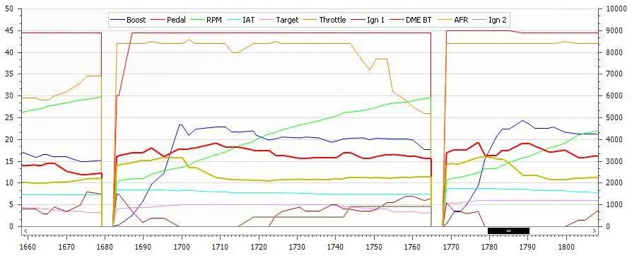

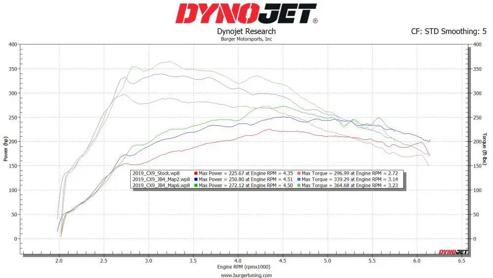

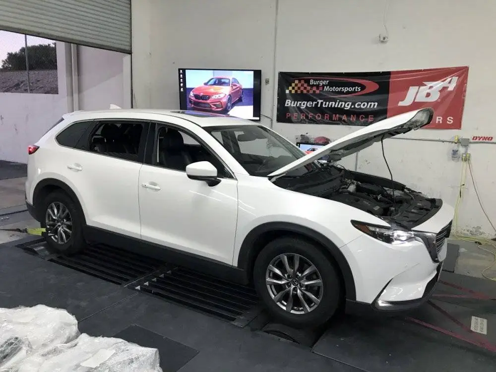

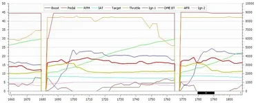

Was able to get a 2019 CX9 in the office today to test out the new JB4 V1 Application MAF control. Worked like a charm! Testing was done on 91 octane fuel. I used "rigged" connectors for this dyno testing but we're hoping to have the real connectors here in a few weeks and then will start mailing those out to V1 Application customers. CX, Mazda6, etc.
