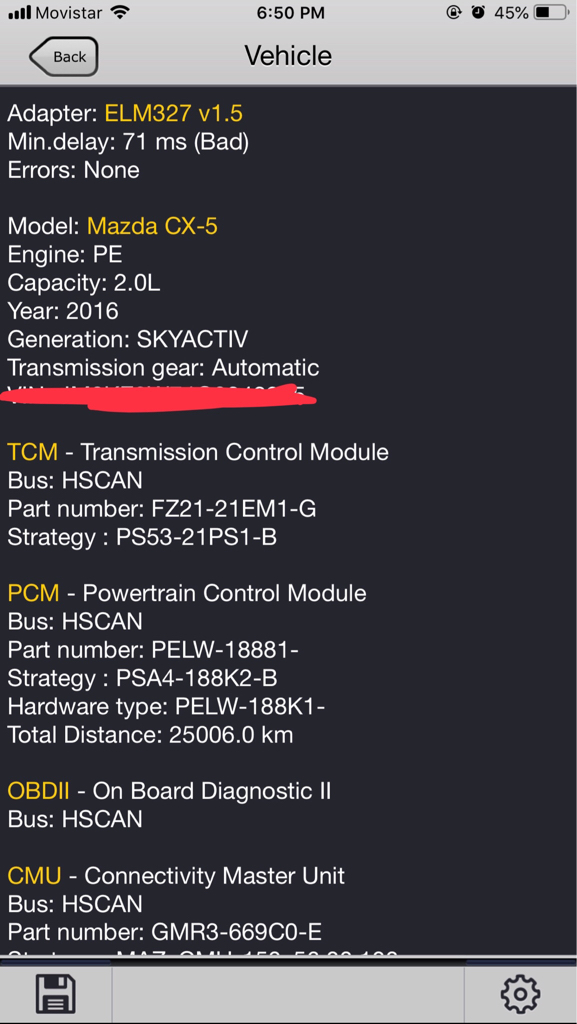

Also, if I leave the OBD tool connected the car suffers from some hiccups from time to time, I thought it wasn't related so I stopped using the OBD reader for more than a month. Today I decided to use it and the car threw errors and misfired twice, I will upload a picture. Anyone experienced anything similar with their OBD2 readers?
Upload a pic and link to model you are using...I'm using some pretty generic ELM327 adapters and don't have any issues. As long as one isn't trying to run multiple OBD devices at the same time it should be fairly benign to the car.

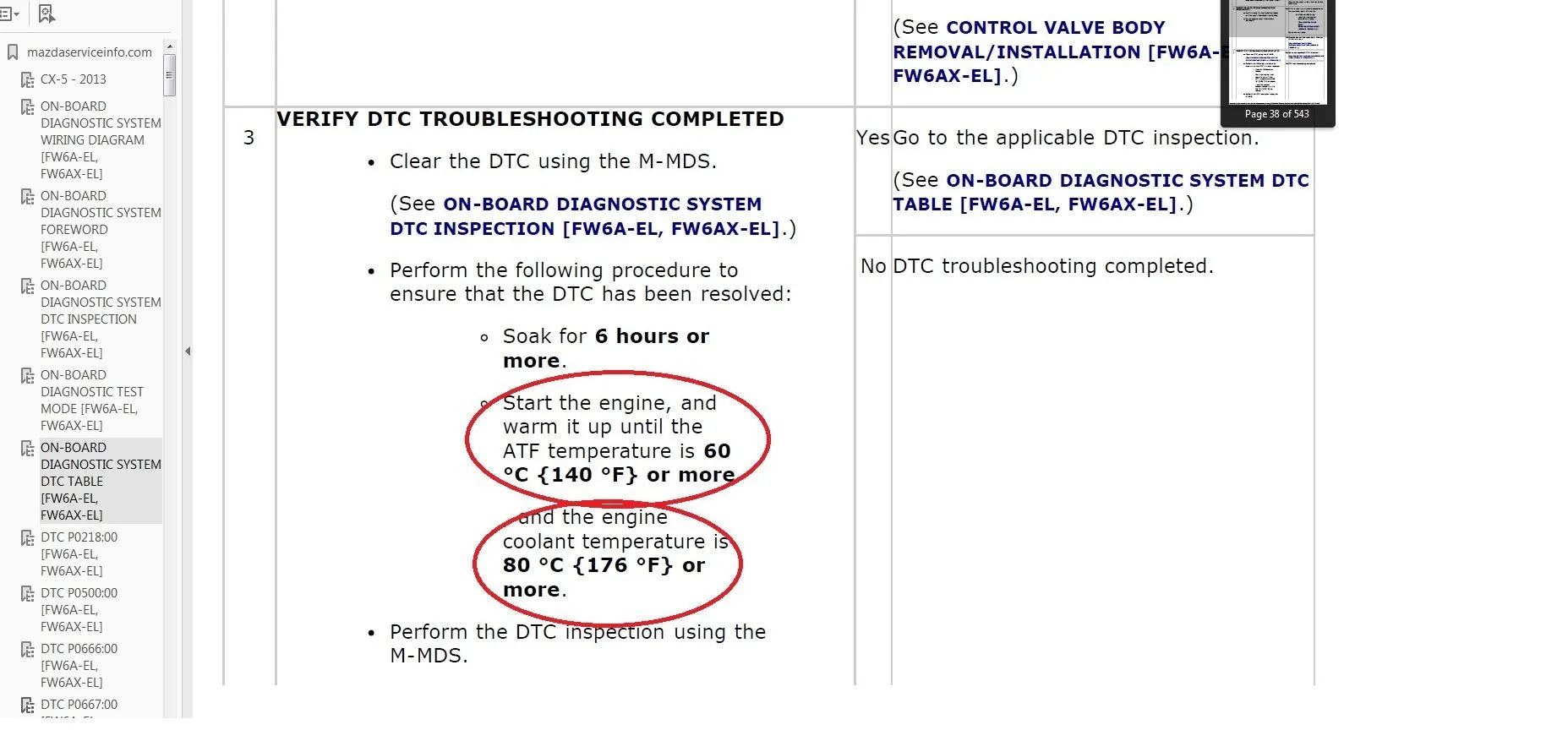

So for gen-1 CX-5 theres no true ATF temperature sensor, but two coolant temperature sensors at different location displayed as engine coolant and ATF temperatures by Forscan App?
Has to be a trans temp sensor somewhere, this is out of a 2013 service manual, the manual makes numerous references to trans temps
attachment.php
I assume it would be onboard the valve body itself within the AT if not a separate sensor.
I've also been looking around at AT rebuild documentation. It is listed as---> FW6A-EL
http://www.makcotransmissionparts.com/mm5/graphics/Catalog-pdf/FW6A-EL.pdf
I thought I saw 3 different M-MDS temp sensors listed in FSM in regards to that ECM with #465 i diagram above.
Thanks for digging into the service manual for these information. So we can assume Forscan App displays ture ATF temperature, while some other apps such as Torque App displays fake ATF temperature by using coolant temperature data as both temperatures shown always the same.
