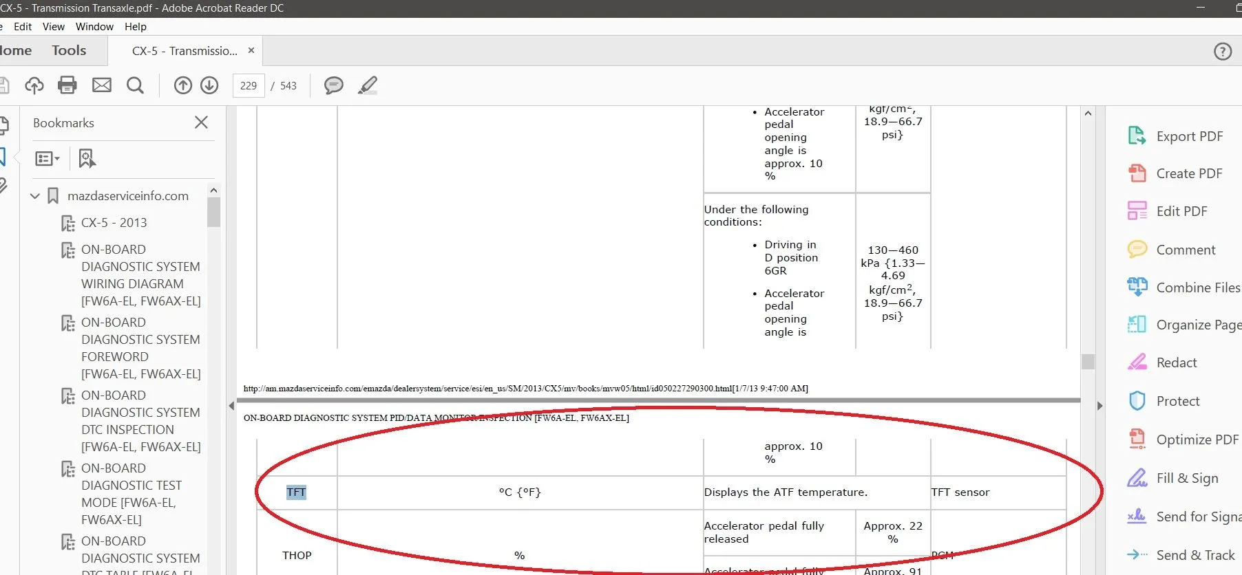

Again, from the service manual that was posted on this website a few years ago.
attachment.php

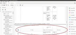

attachment.php
Thanks for the info. So we can get a true TFT sensor data from Forscan App directly without custom PID setup on CX-5?
Yes, using Forscan. Just about everything and anything is there, trans temps, rear diff temps, duty cycle of fuel pump, what gear the trans is in, rear parking brake motor voltages, fuel pump voltages, etc.
