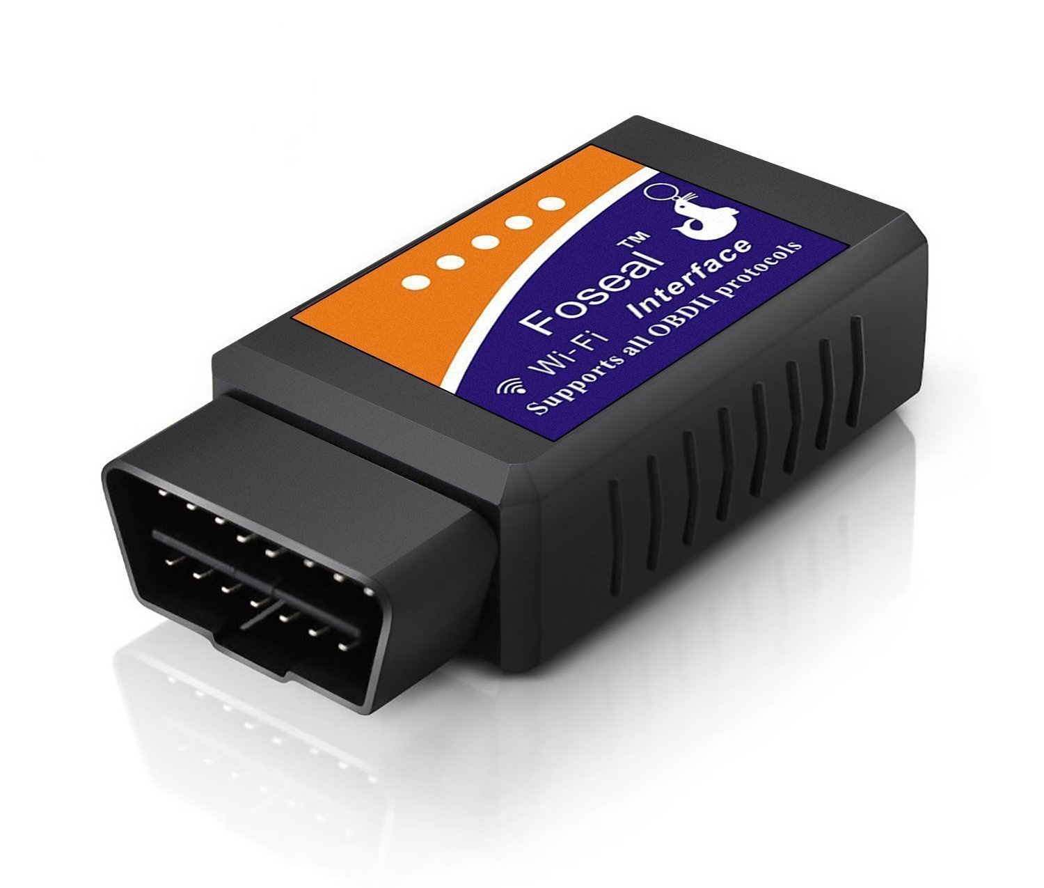

Just using one of these ELM 327 Wifi adapters with Forscan
https://www.amazon.com (commissions earned)

This is the OBD2 Reader that I've had for quite a while now and use with Torque Pro for my 07 Tacoma. And yes, I had to add custom PID's for tranny temps. I've now set up the profile for my wife's CX-5 on the Torque Pro and added a transmission temp PID formual. Gonna test it out once she gets back from shopping.
