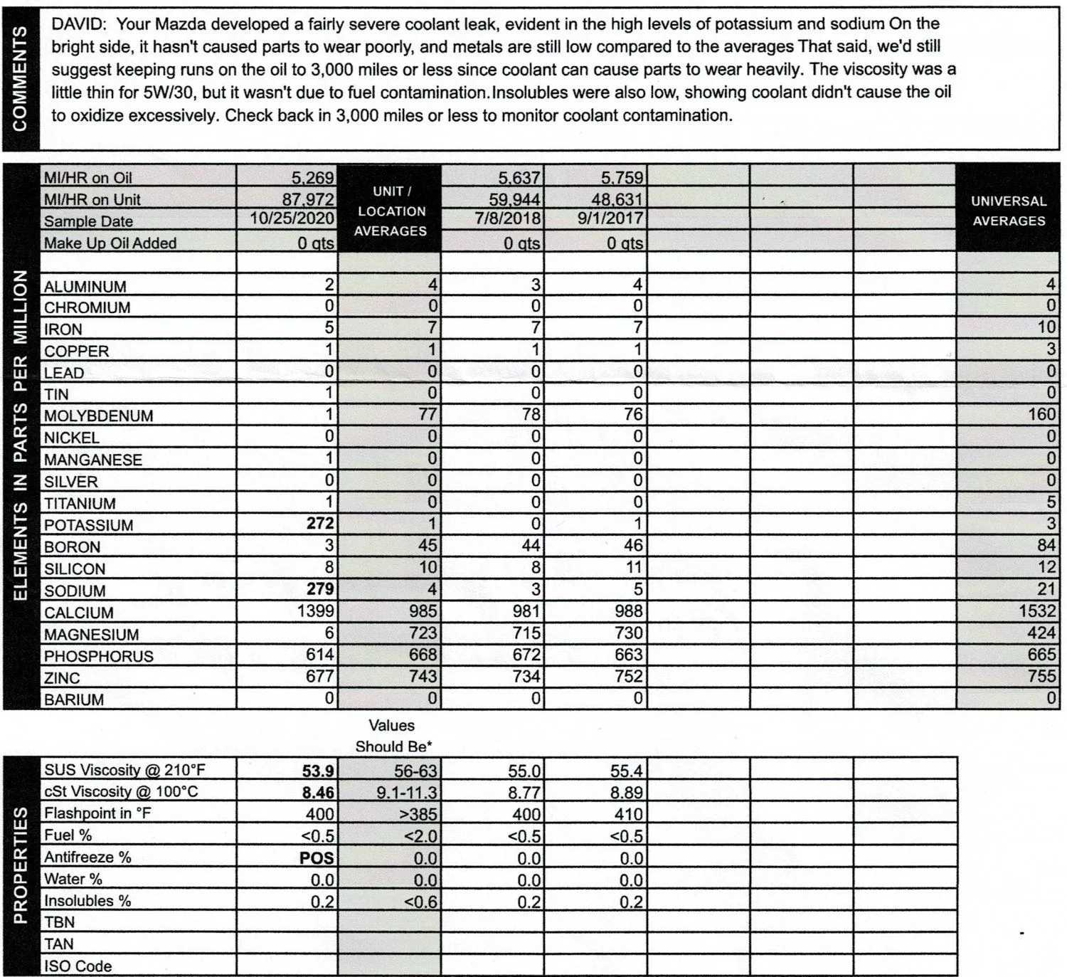

We’ve seen a couple of UOA reports from their CX-5 which indicate severe coolant leak with high levels of potassium and sodium. But those are all 2.5L. I guess not many CX-5 owners with the 2.5T are willing to DIY on oil change, and send sample for a UOA. Or we may see more of this complaint on the 2.5T CX-5.

SkyActiv Oil Analysis Thread
Glad to see so many great Blackstone reports for the 2.5 SkyActive! Mine was also, until now......

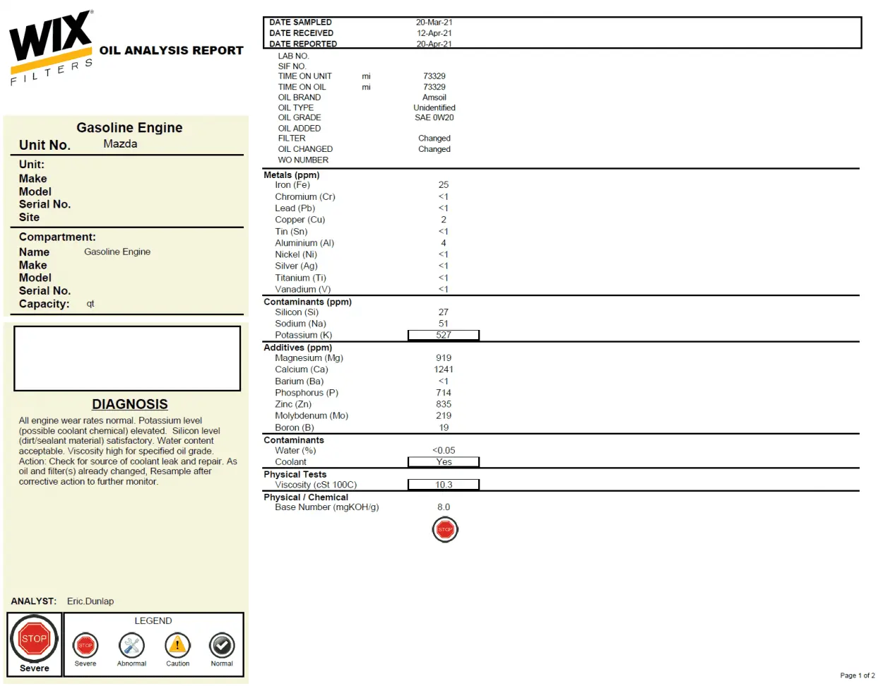

I did my oil analysis at 73K and apparently there's a coolant leak. I brought my vehicle to a mechanic 2 months ago and he did a pressure test but did not find any sources of a leak so I am not sure. I did put some UV dye in the coolant reservoir to see if the funny smell coming from my heater was due to a heater core leak but there wasn't anything noticeable.

Based on the coolant leak report on 2.5T from CX-9, they claimed the dealer saw the coolant from the rear side of the engine. Which to me most likely is external cracks developed on cylinder block, or less likely the cylinder head. The head gasket or cylinder head coolant leak normally can only be detected from UOA or the oil stain in radiator and coolant reservoir. You can’t see the coolant from outside. Of course when the coolant level is dropping, it could be the sign of coolant leak. But it can be from leaking water pump and there’s a TSB for it. Many, including me, have found the coolant level will drop gradually over time with no reason can be found.
