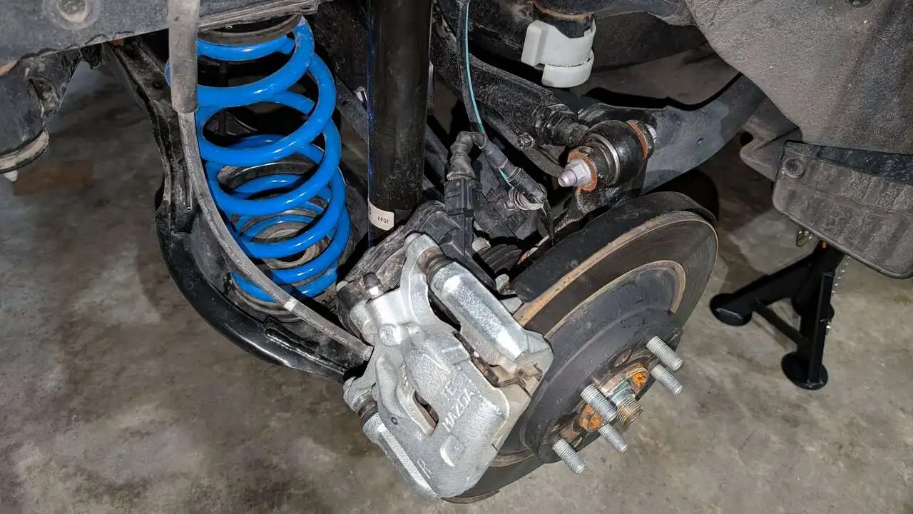

Installed ACT1258 up front and ACT1846 in the rear and they are working perfectly. Very quiet pads. I used Sil-glyde as I couldn't find Molykote.
Also the car did NOT want to come out of maintenance mode. It took me nearly 10 cycles of the procedure. Each time it whirrrrrrrrrrrrrrrrrrrrrrrrrrrrrrrrrrrred for about 30 seconds before ending in a critical malfunction. I remembered I forgot to get pressure back into the brakes, so I depressed the pedal several times until it felt normal. Still wouldn't work. Frustrated, I left it and came back about 15 min later and tried again—it activated within 5 seconds. No idea the reason for the tantrum.
pxl_20240615_201548911-1-jpg.329180
Now I have very good condition (3,000 mile) OEM pads to find a use for.

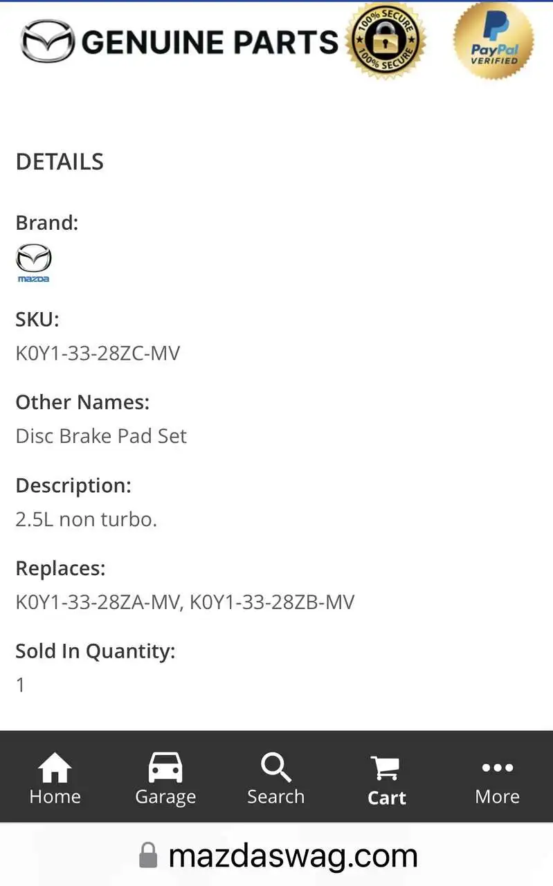

Here are Mazda OEM front brake pads listed from MazdaSwag.com for 2023 CX-5 with 2.5T and 2.5L NA:
For some reason only Value MV front brake pads are available for 2023 CX-5 for both 2.5T and 2.5L NA. Yes, there’re different due to 2.5T has bigger dual-piston calipers at front and 2.5L NA has smaller single-piston calipers at front.

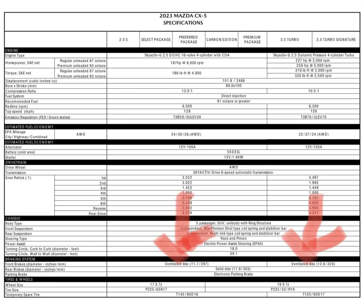

Based on 2023 CX-5 specification the size of front rotors on 2.5T is 12.6” but it’s 11.7” for 2.5L NA. So the front pads have to be bigger on 2.5T than the ones on 2.5L NA.

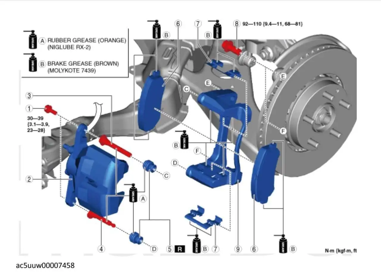

But a word of caution, the smaller front pads for 2.5L NA COULD still fit your front brakes just smaller on pad area, as they look similar on shape based on Mazda Workshop Manual:
Front brake for 2.5T:
Front brake for 2.5L NA:

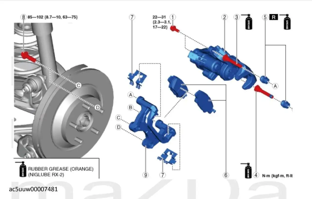

Rear brake:
So in your case when pads fit doesn’t mean you have absolutely correct front pads.
