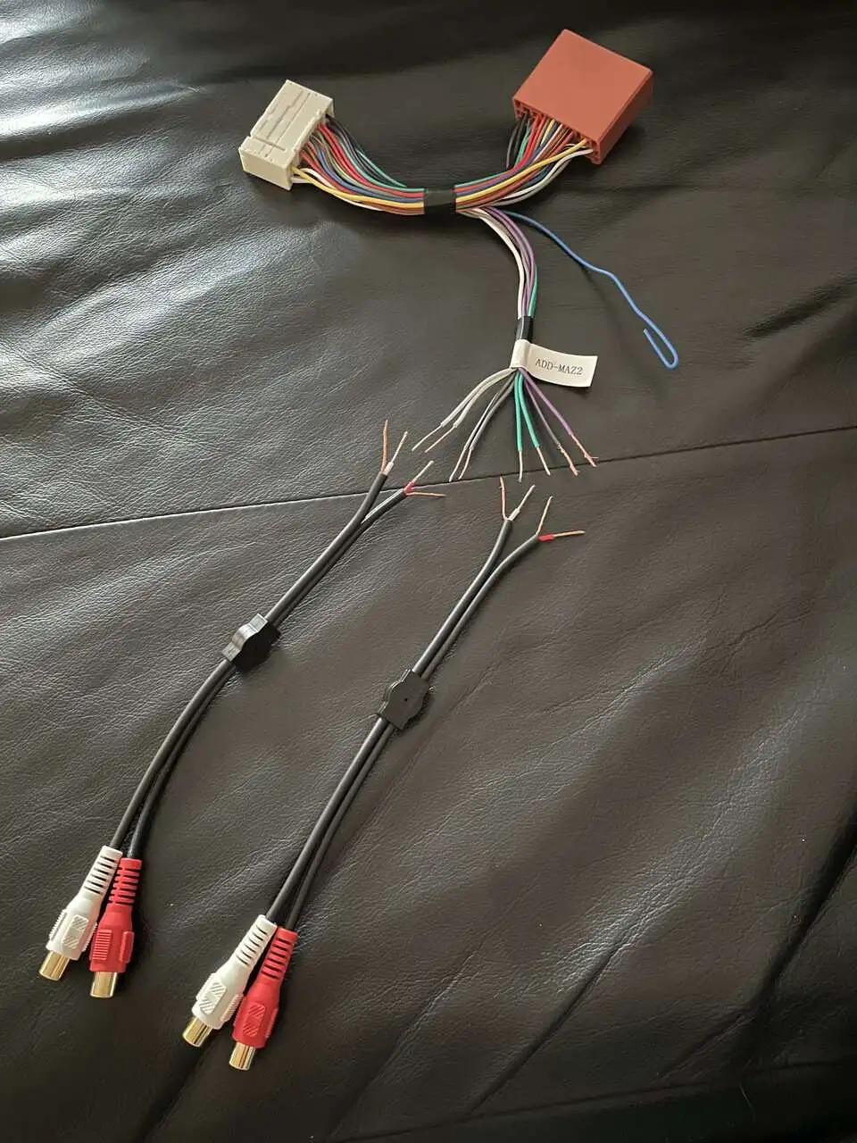

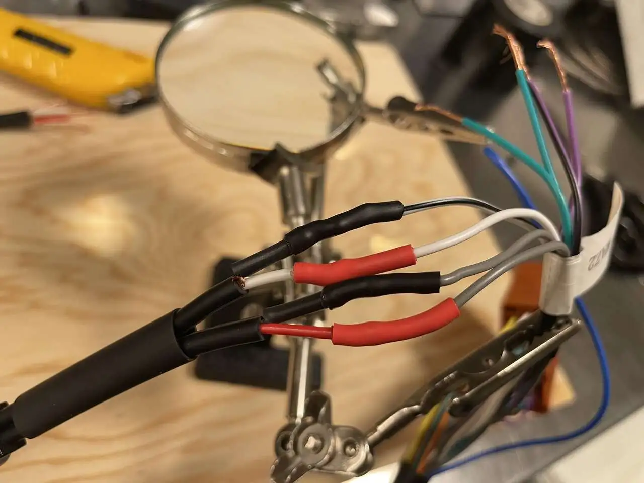

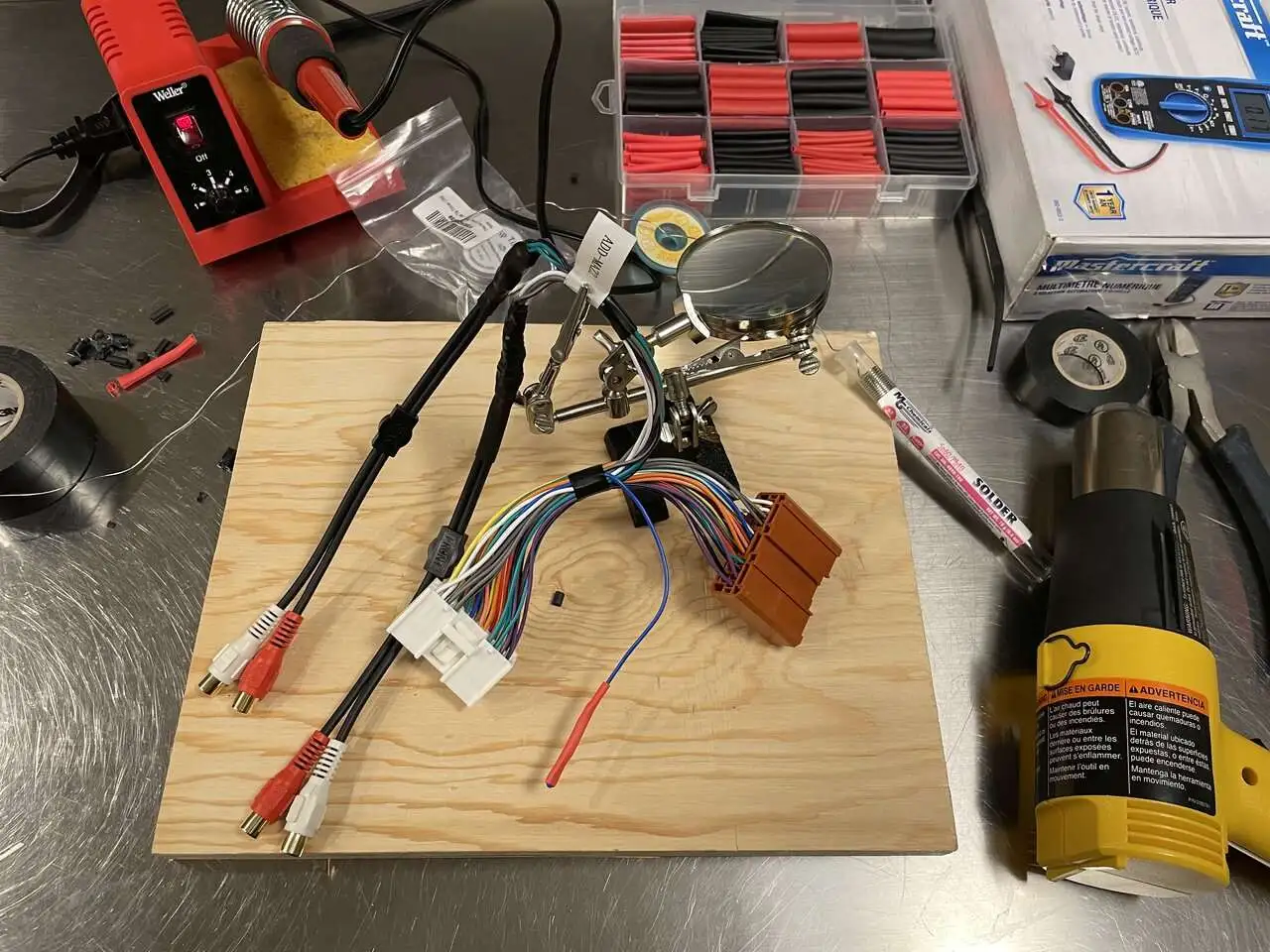

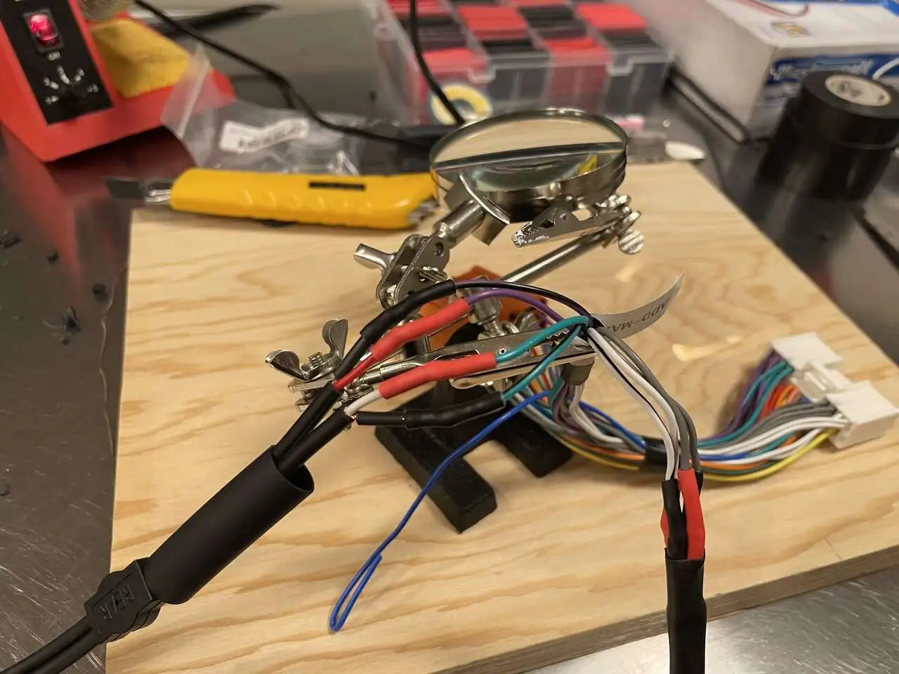

Finally arrived in the mail, time to get the soldering iron out…
Gray gray/black (right front), white white/black (left front), purple purple/black (right rear), green green/black (left rear).
Solid color is positive (red or white on RCA), black stripe is negative (black RCA wire).
All done, not really sure what to do with the blue power wire, guess could cut it at the terminal I just folded it and heat shrinked it for now.
You may want to put a piece of heat shrink on the front RCA's so you can easily tell front from rear after the harness is buried in the dash. Or maybe mark with a sharpie or something.

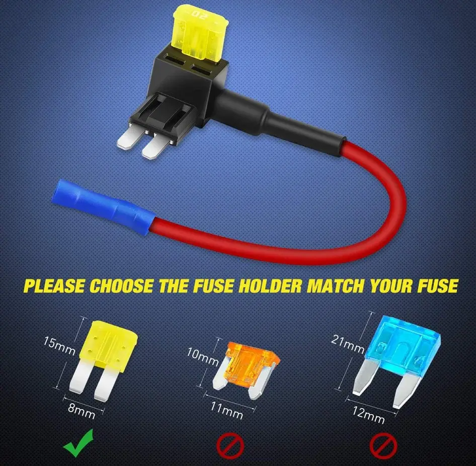

When I was running a factory head unit, I hooked the amp's remote wire to a switched 12V fuse in the fuse box. When the key is switched on, the amp turns on. When the key is switched off, the amp then turns off.
Use a fuse tap, it's easy.
