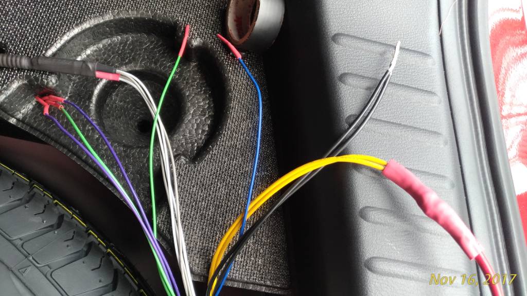

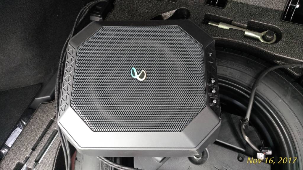

I already installed my Infinity Basslink DC. Signal coming from the speaker level of the stock Bose sub. I do not advice using the stock Bose sub with this sub as the lowest cutoff freq of the Basslink is 50hz. The stock Bose sub does around 40hz. Playing them together sounded horrible. But with the Basslink only, it blended well with the rest of the system. Footprint too is very minimal.
