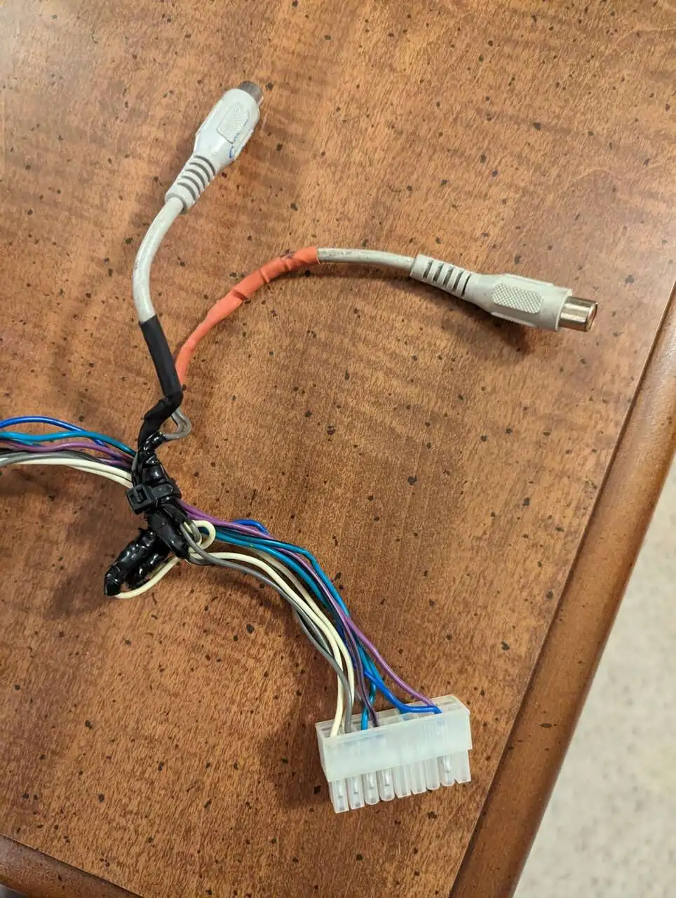

So can anyone please confirm the PAC AOEM-MAZ2 will in fact work with a 2016 Mazda CX-5 GT with BOSE as plug and play? Receiving conflicting info saying will have to slice RCA’s into the harness before the LOC which would defeat the purpose IMO.
You have to slightly modify it. And I do mean slightly.
With the Bose amp, you don't use the blue breakout box. Instead you use RCA's that you have to connect *to the harness*.
The beauty of this harness is, you don't cut any factory wiring. Everything remains 100% intact.
On the part of the PAC harness that leads to the blue box, that's where you splice in RCA's to feed your amps. And then you don't use that box.
So then the original post of this thread is wrong?!? I have the same CX-5 year model and trim (with BOSE) as the OP… very confused how it could (allegedly) work plug and play for so many before me.
I mean, if you run it through the LOC (blue box), and it will work, it's just you'll have to turn the gain on your amp WAY up to compensate. That decreases sound quality as it greatly increases the possibility of hearing hiss in the system.
To prevent this, take the 5 minutes to add the RCA's.
Besides, almost no modern amp requires the use of an LOC to begin with. I can't think of a single one on the market that won't accept speaker level inputs.
To be clear, the Bose head unit does *not* output a low Z speaker level speaker signal, it only physically looks like it does. It's a high Z output (same as an RCA), but in the physical form of low Z speaker.
