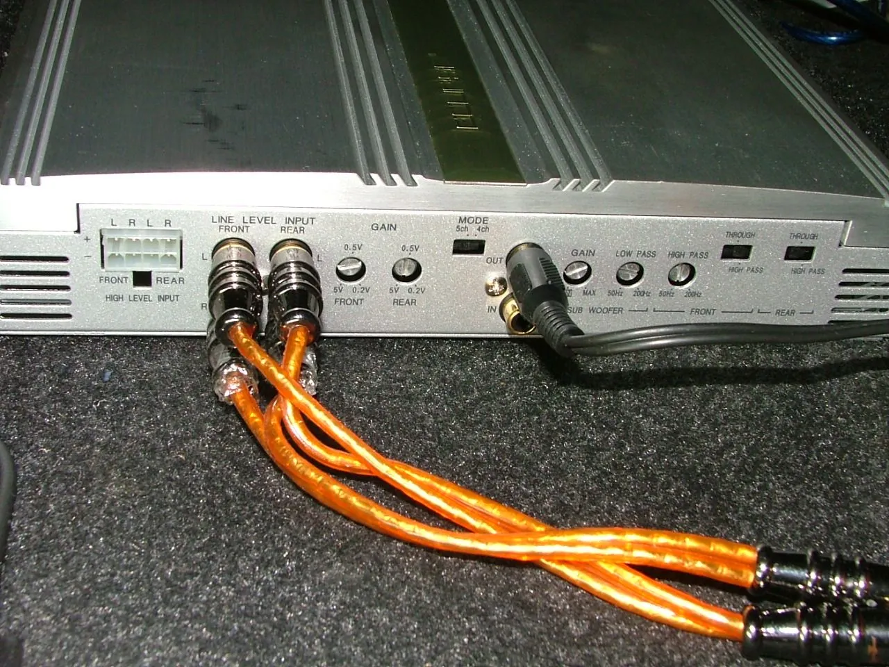

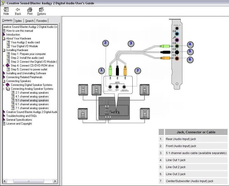

You know, it occurred to me tonight, that since I have had a halfway decent sound blaster Audigy 2 Value card for sound out of my car PC for a bout a year now, maybe I should try running 4.1 or 5.1 Surround sound? All it would take are a couple of cable changes to the AMP. The pictures below is how I first set it up (an how it is now), due to the fact that my old Carputer was a laptop on a docking station, with one audio out. Notice that I merge the Front Left, and Rear Left together, and then Front Right and Rear Right together, and then feed them both, via Y-Adapter to a regular RCA Right-Left, down to one line to go to the line out on my soundcard. The last picture is the reference I'm going to use to setup 5.1 Surround Sound for my soundcard:

Ok, So I just got rid of the old, krappy unshielded wire, and put in some new, less-krappier shielded wire. I may have just solved my alternator whine issue....

So it turns out that I can only run 4.1 sound right now, due to the fact that it doesn't make sense to power my stock sub with my AMP (as it would be too much). I will have to wait till I get a decent SUB to do that. So I went and got another RCA cable, and I will be setting it up shortly. Below is how I will have to do it:
