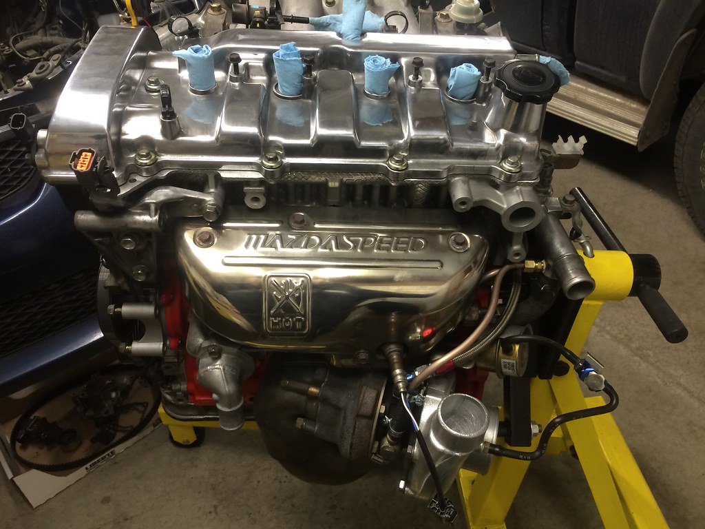

That is one good looking engine man, how much boost do you plan do run? Is the trans stock? I took the easy way out and bought a used forged engine, swapping it right now and working on it when I have time (which is rare)
Thanks. Start at 7-10 for break in. I fiddled with the actuator so in not sure what baseline would be. I have a GT2871R to swap on after break in is done and I think I'll attempt to find out what the top end of my 440 injectors will be and go from there. Ultimate goal is ~300whp.
Trans has welded msp LSD and Ferdi plate. (Hydra)

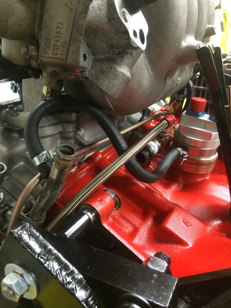

Lower rad hose and clamps are stock. Metal spring clamp did fine before.

I mean the P clamp you have holding your bent tube into the water neck. Not the thermostat housing.

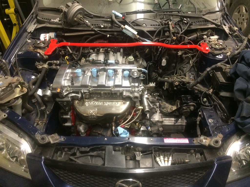

Worked till the crack of dawn last night. Trying to get the engine in the car Saturday morning.

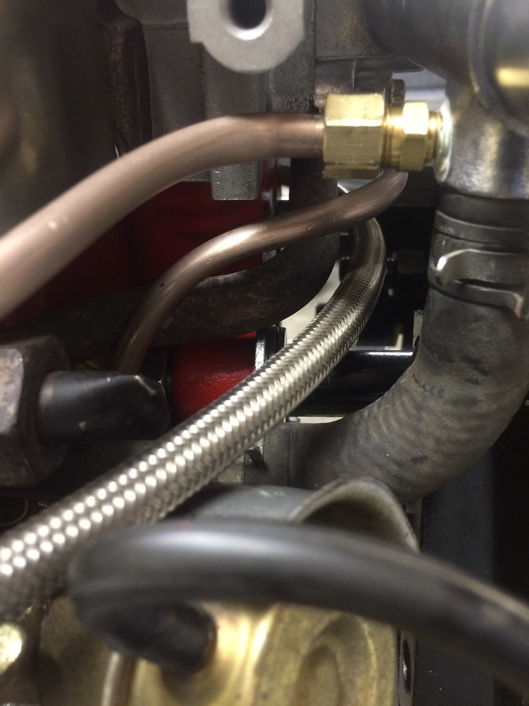

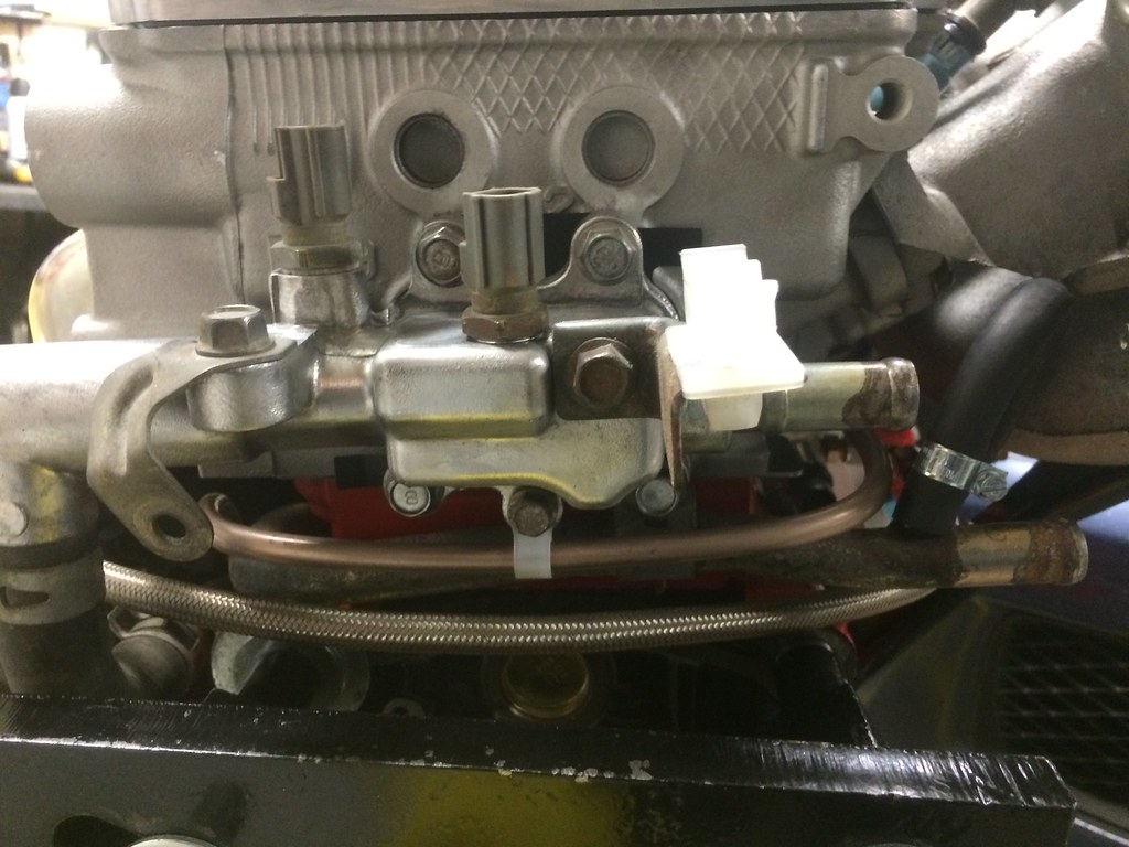

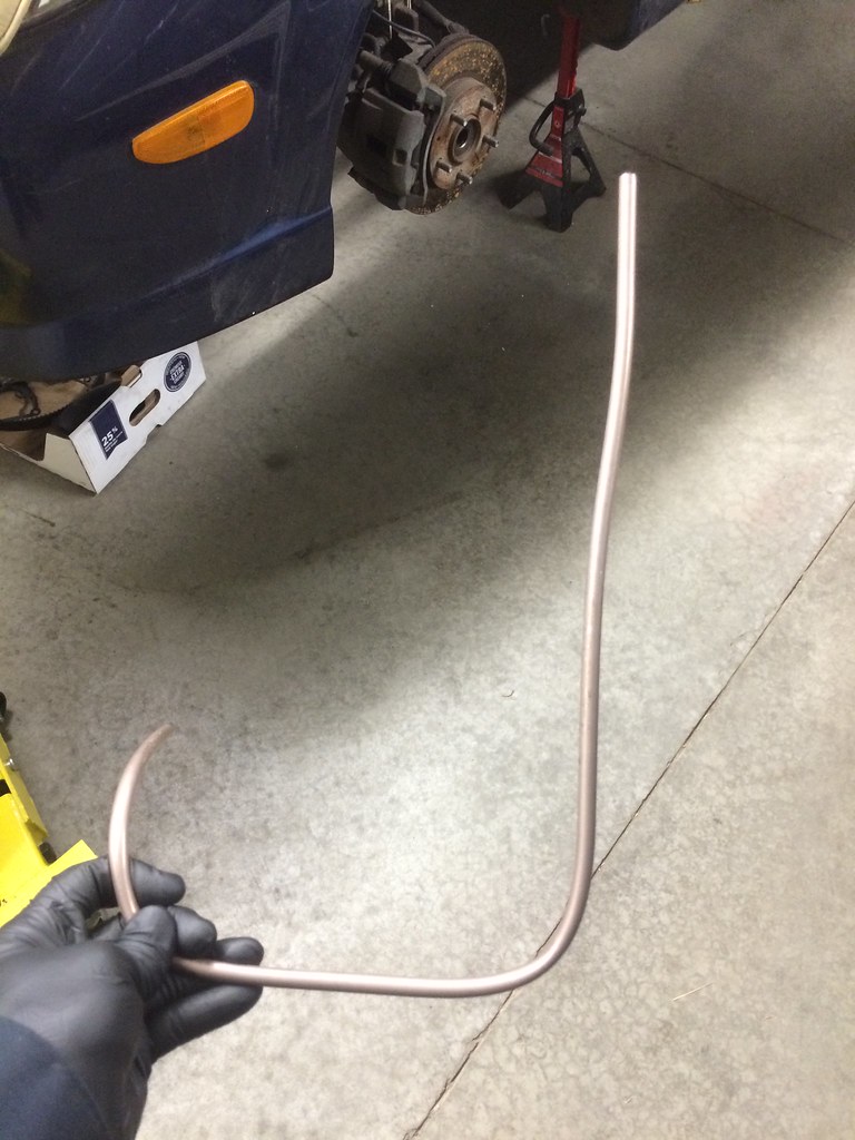

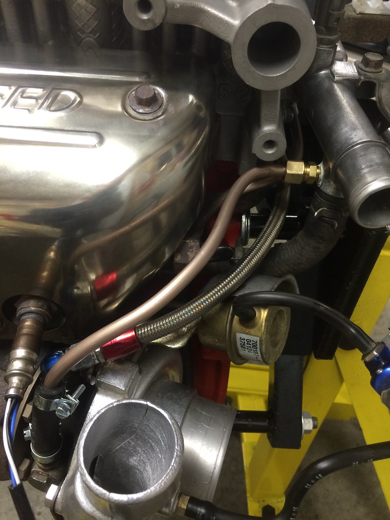

Fabbed the water lines Ive been pretengineering. I am really happy with the turnout, except maybe the connection from block to oil cooler (really close to the alternator). Used the ezbend copper brake line, 5/16 OD, and some brass compression tees and fittings that crappy tire (Canadian Tire for the American followers) carries. I used this and 5/16 heater hose as this is the size of all on the spigots that come off the stock pipes. Everything fits really nice and a lot cheaper than buying all of the stock MSP tubes. Got everything else bolted on that I possibly could.
I love what you did with the turbo water feed line
Gotcha!! Good catch!
Nylon 6.6 has a working temp of 125c. My water temps have never exceeded 96 even at the hottest point where the upper rad hose feeds the rad.
I'll keep an eye on it.
Sent from my HTC Desire 626s using Tapatalk
Thanks. It's about as close to stock msp routing as its gonna get without shelling out a ton of cash.
Spent a bit of my morning putting it in. Only got the mounts sinched down but the rest is down hill.
It's alive!!! Got it going yesterday. There was a bit of particulates in the oil/filter after the initial startup. I'll post some pics in a couple days.
