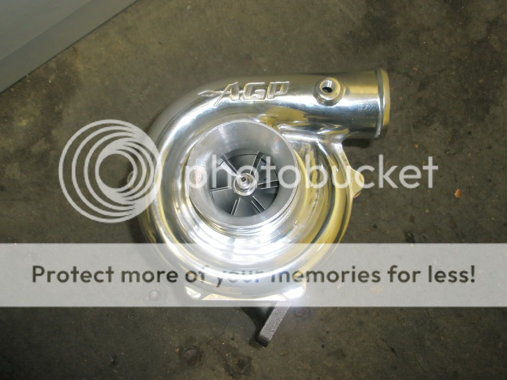

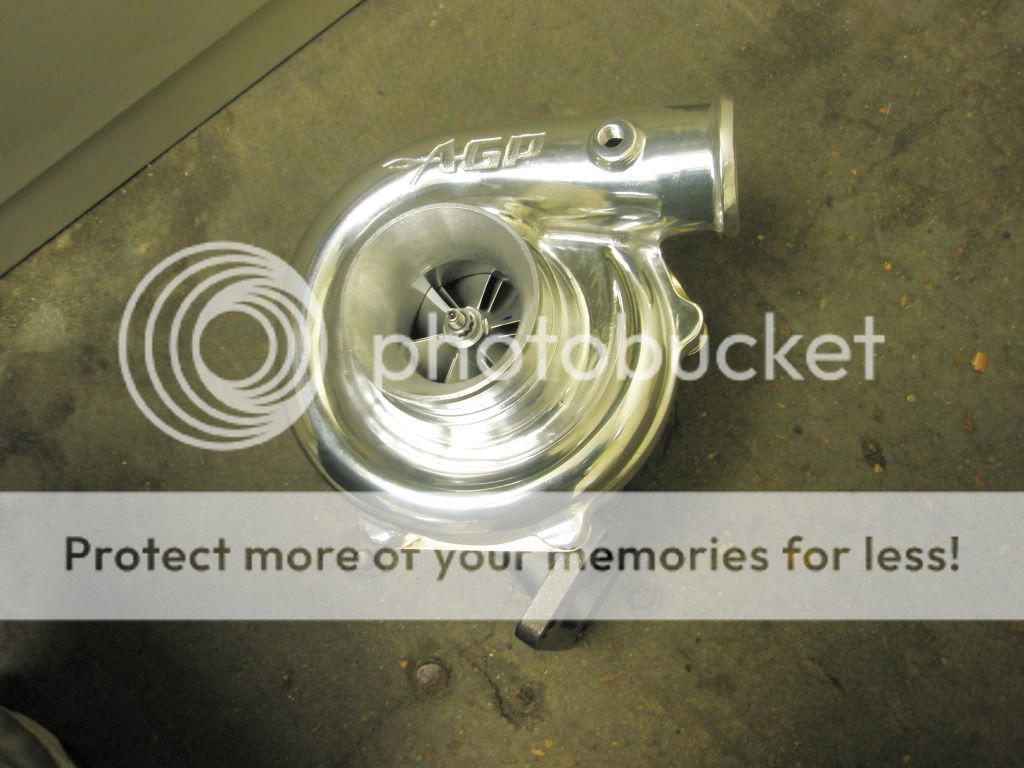

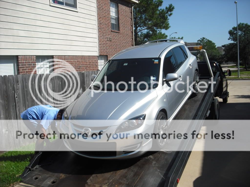

To make a long story short my engine blew a few months back and I decided to build it instead of selling it and getting another car note. I really wanted to upgrade the turbo on the car without forking over ATP gt series $$$$ so I ordered a T3/T04E AGP Delta 44 .48 a/r turbo to replace the stock turbo. I've seen this turbo on srt-4s and its sick. It spools very early and you should be in full boost around 3000 rpms. I'm excited b/c tomorrow my car gets towed in to the shop and they are going to start working on the swap/build. It should be done at the end of October or early November. After the build is complete I'd like to have the car tuned by Cobb in plano, tx unless i can get it tuned in Houston by someone competent in AP tuning for our car.

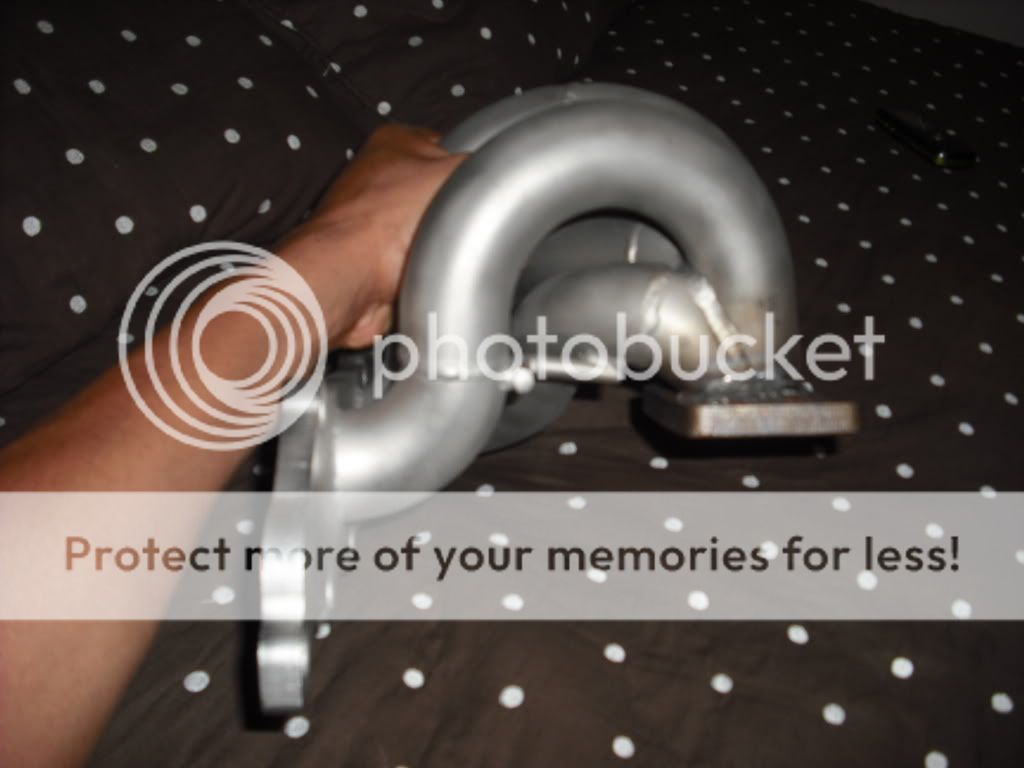

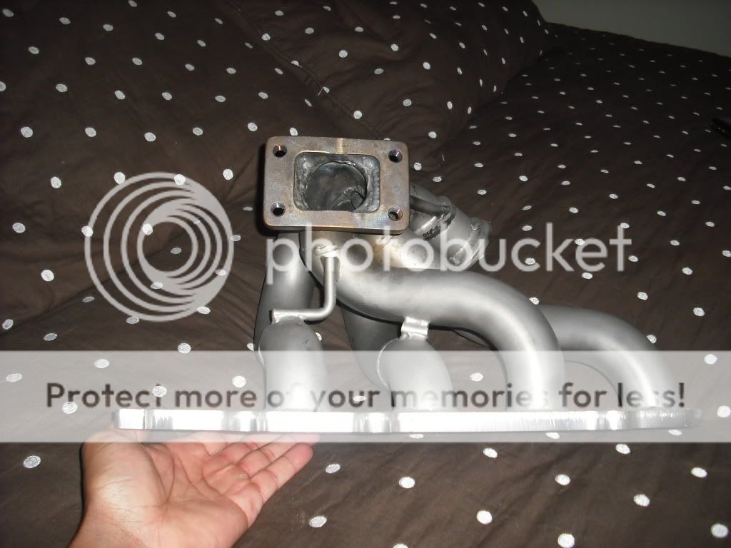

got the PG mani back today. Its not the prettiest thing in the world but itll do.

Manifold flange is going to be re-done by my shop. The local fabrication place F*&!ed up and warped the flange when they were welding it. I was told flow shouldn't be an issue after everything is said and done. I should have the AGP Turbo in hand on friday or Monday. Money, time, and patience will solve the injector issue. I've already been asked by a local shop if I could drop off a sample injector for them to work off of. I'll work on that after i get my motor broken down.

It's so shiny! Looks sexy.
GL with the build up. Looks like it will scream!
