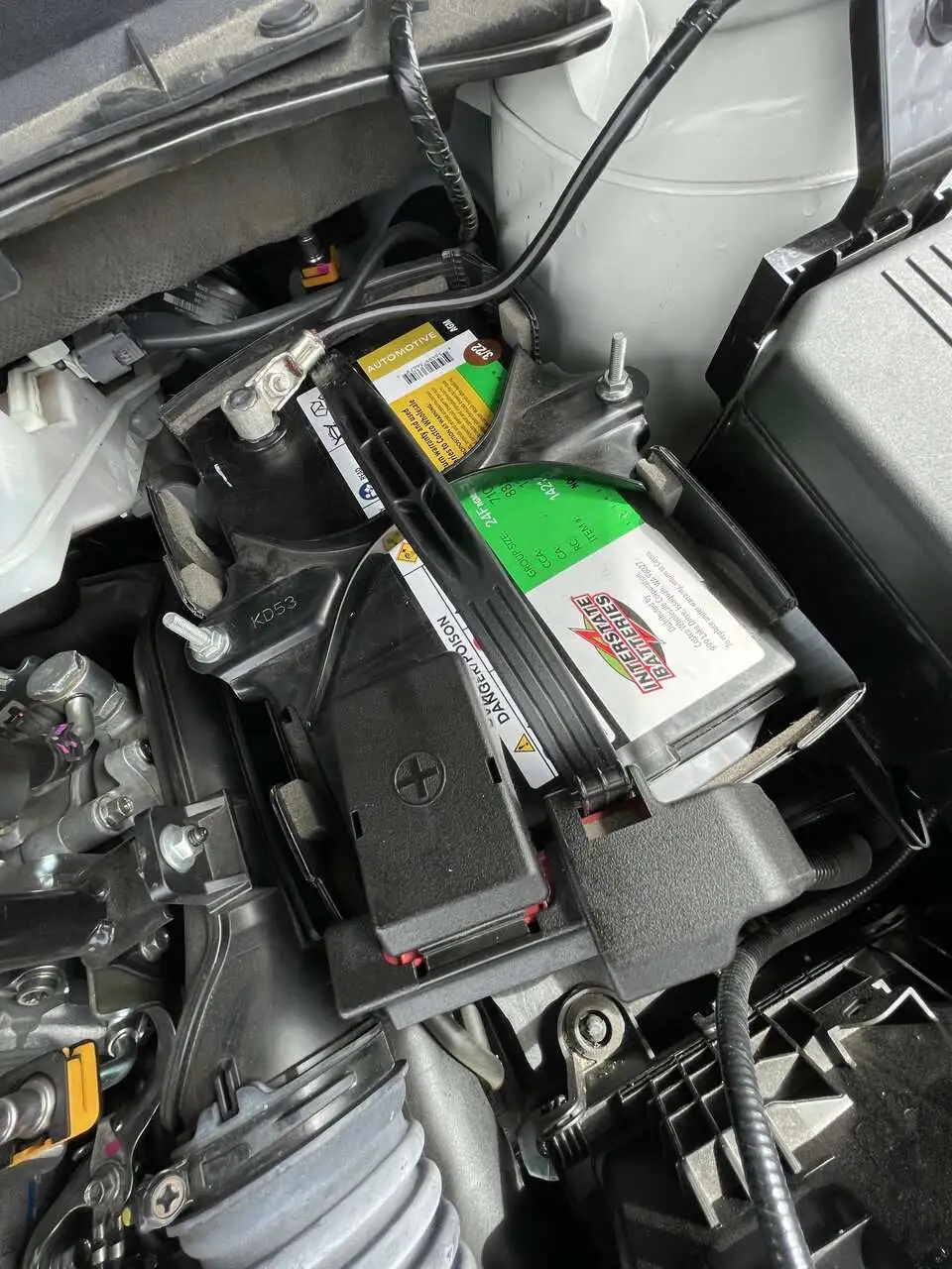

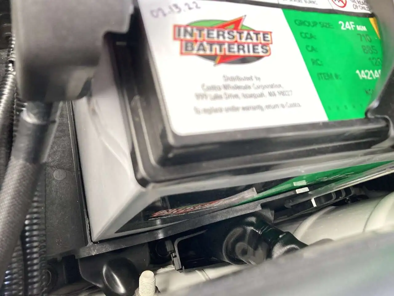

The CX-9 calls for a group 35 but I was measuring and a 24F will fit with very minor modification to the battery tray. Forward of the battery tray there are two things in the way (not sure how to describe it, Lol) all you need to do is snip them off with heavy duty diagonal cutters or use a cut off wheel. It fits prefect. The AGM 24F was also cheaper than the AGM 35 so it was a no brainer, less money and more power. I love how quick it turns over in the morning in the cold.
AGM batteries benefit from being able to discharge lower and not get affected by it, they usually have a longer life span, they’re more durable and not as affected to vibrations as a flood battery and for the same group size usually have better CCA ratings.
Just thought I’d share if anyone was interested in a bigger battery option. Also good if you have accessories like a sub or a dash cam or anything more than stock.

I think I have the same battery tray in my 2019 Signature. I'll follow your lead... I should be able to use a Dremel tool to cut that plastic are your referring to, correct? Did you have to remove the tray to make the modifications? The 24F has considerably more power and AND it's cheaper -- too bad it's an inch too long to fit in the factory tray. Thanks for sharing!

If yours is also a 2019, more than likely it’s the same tray. It’s probably been the same tray since 2016. I did the modification with the tray out. Very easy to do. I wanted to clean the whole thing before putting the new battery in that’s why. Here is a picture with it installed. It’s such a perfect fit!

That's it! Perfect fit. Thank you for the photo!

Someone copied you. 😃
