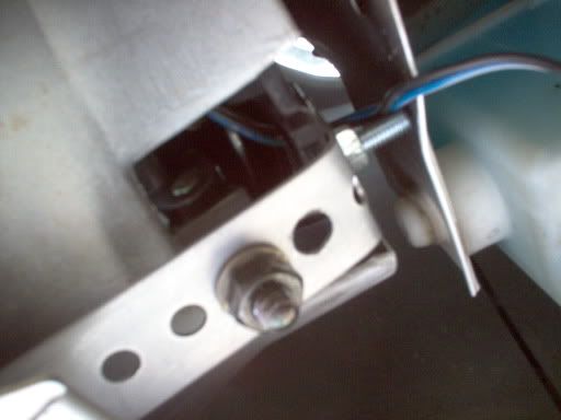

I dont get flashed and I run em daily. But, beware that they dont exactly "bolt right up". If you use stock mounting hardware they cannot be adjusted upward enough, they point down about 1 foot in front of the car. I had to make my own brackets so I could aim them up. I made em out of some thick pre-drilled metal stock, you can get it an any hardware store.
The bracket bolts to the stock hole then the light bolts to the bracket. When you get under there you will see what I mean.
http://img.photobucket.com/albums/v247/beau_m/IM000705.jpg
So, is that why our stock fogs suck? They're pointed straight down and not adjustable? I've brought em up as far as I can, but, that would explain why they still suck. Maybe I'll fab up a mount for the wife's while I do mine for the Catz so the PIAA bulbs aren't so useless in her car.
