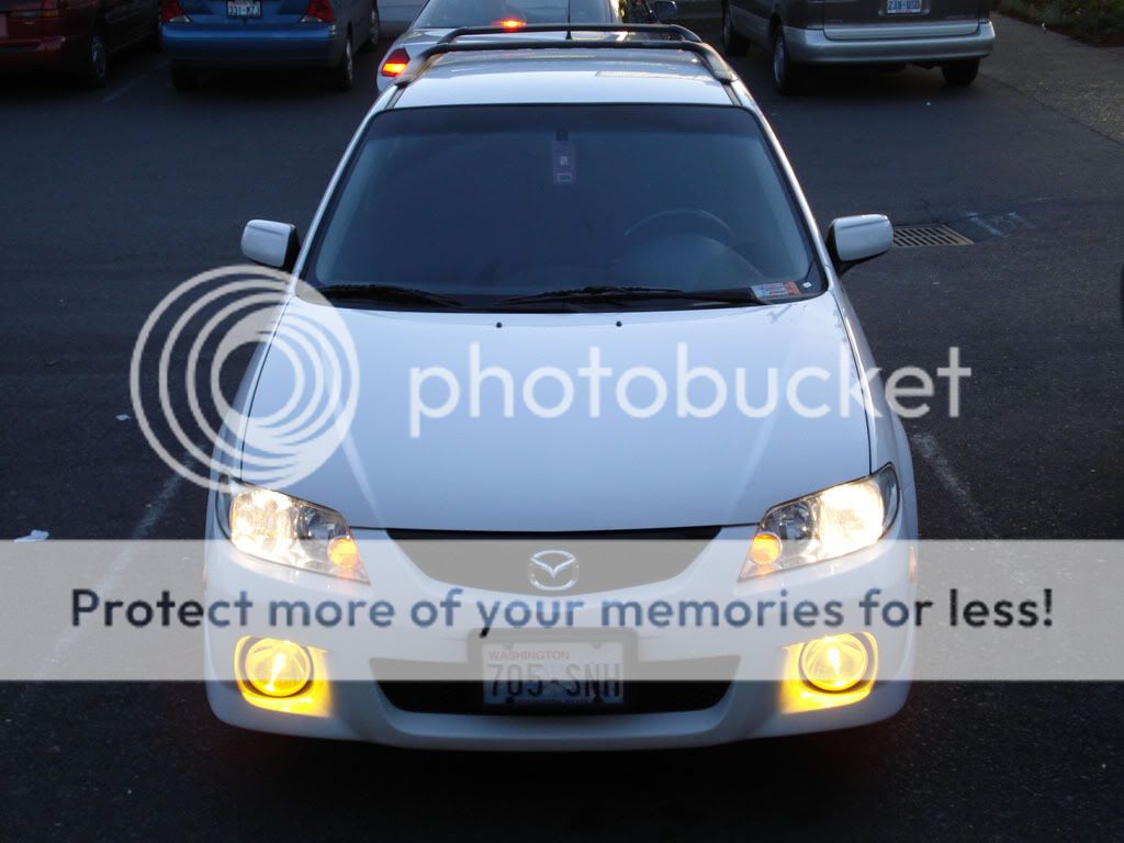

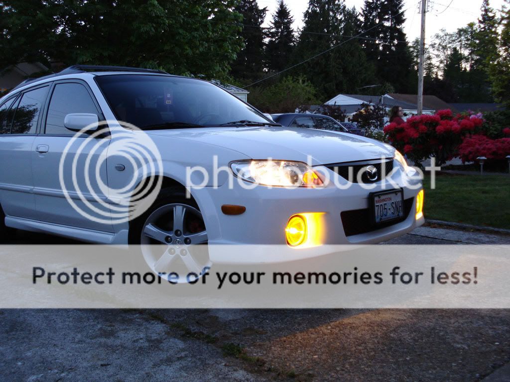

Hey guys, I've been getting some PM's about the aftermarket fogs that are for sale at WWW.JCWHITNEY.COM and for a while back they sold the yellow lenses for the fogs in my sig and avatar, as I was getting some replies I decided to call JCWHITNEY myself to help you guys get the part # for the yellow lenses, but they unfortunatley do not offer them anymore, they still sell the clear lens and the amber lens (which btw are nowhere near yellow, they look exactly like stock turn signals, very orange/amber). So buy the clear smooth lens and buy some decent yellow bulbs and they will work perfrect.
Again, I hooked it up to my stock wiring and for two yrs now run the same bulbs they came with and haven't had any wires melt of any kind.
INFO WWW.JCWHITNEY.COM PART NUMBERS 73ZX6025T (AMBER) & ZX736025T (CLEAR).
PICS: http://www.mazdas247.com/forum/showthread.php?t=94393<!-- / message --><!-- sig -->
Hope this helps.

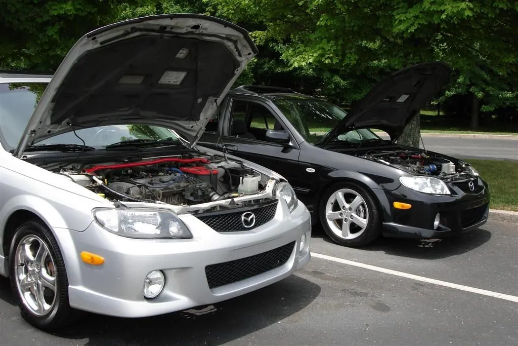

I have them.(silver one)
