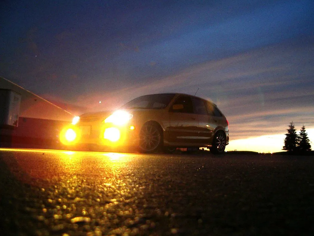

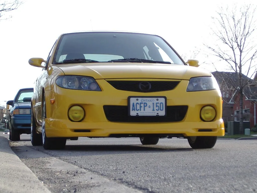

Here's a pic of Bijou-MP5's car with PIAA 40's, which are the same size as PIAA 520s.
Here's another pic.
