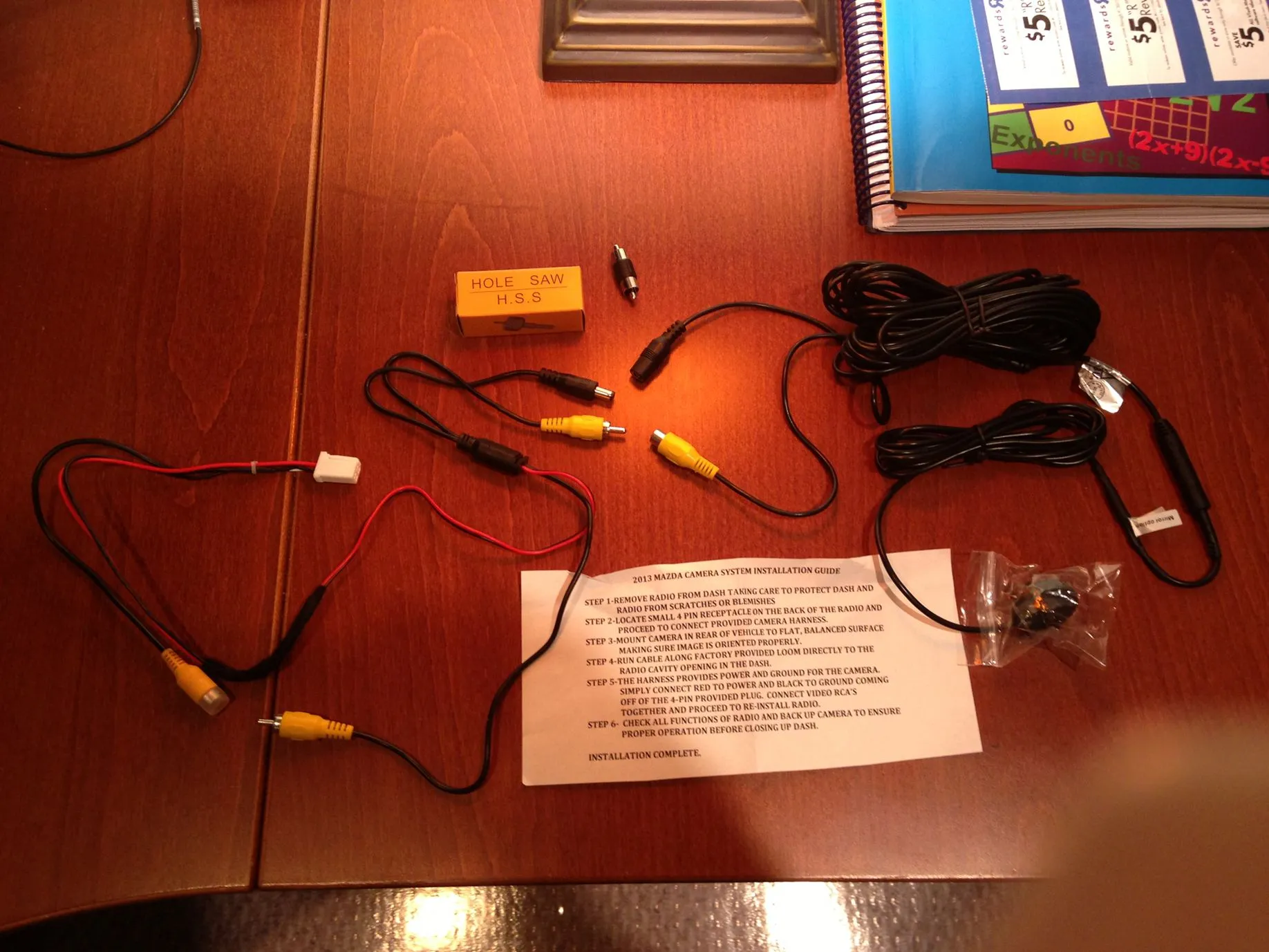

Received the Backup Cam yesterday and it works!
I pulled apart the dash and tried it out and it works fine with the correct image orientation(ie mirrored image right way up). I routed the cable behind the glove box area and reassembled the dash for now, and will route the cable to the back and install the camera in the liftgate this weekend
A few notes, the link i posted to the item was from ebay.ca, thats where i was logged in and bought from. Seller is in the US and it shipped form California.
For canadian buyers, was pre-charged for taxes on checkout, so no COD when it arrived.
It is a direct plug in, but you will have to do a couple wire splices in the supplied wires. Basically you will have to soldier(or crimp connect) the power and ground wires from the radio adaptor included in the kit to the camera harness. Once you've done that, it plugs directly into the back of the radio, and there is no modification to the factory wiring. Also a note on the included instructions. They are basically useless, just a few lines saying plug in and route wires. It is pretty straight forward though, the hard part will be routing the wires back to the lift gate and drilling a hole in the trim to mount the camera
a couple pics

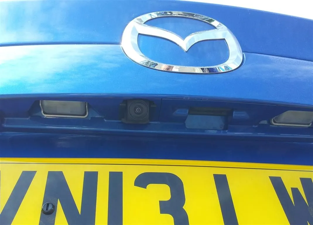

Did somebody actually installed this cam on car, where did you put it? Does it fit instead one of license plate lights?
Hi cx5,
I'm also hoping someone can tell us about the installation.
I took this photo of a CX-5 Sport model with OEM back up camera fitted. As you can see it has its own recess between the licence plate lights.

Thank you m4zda.man for posting that OEM picture!
I just bought the same camera from eBay and am waiting for it to arrive. I am very curious to see how others run the wires to the tailgate and how they installed (drilled) into the tailgate.
When I get my camera and decide to install it, I'll be sure to take lots of pictures and post them here.
Do not drill into tailgate. You can mount the camera next to the tailgate handle and run the wires between where the tailgate handle mounts to the body. Just loosen the handle, slip the wires in and retighten the handle
Great point. What would you recommend to hold it in place on the tailgate?
