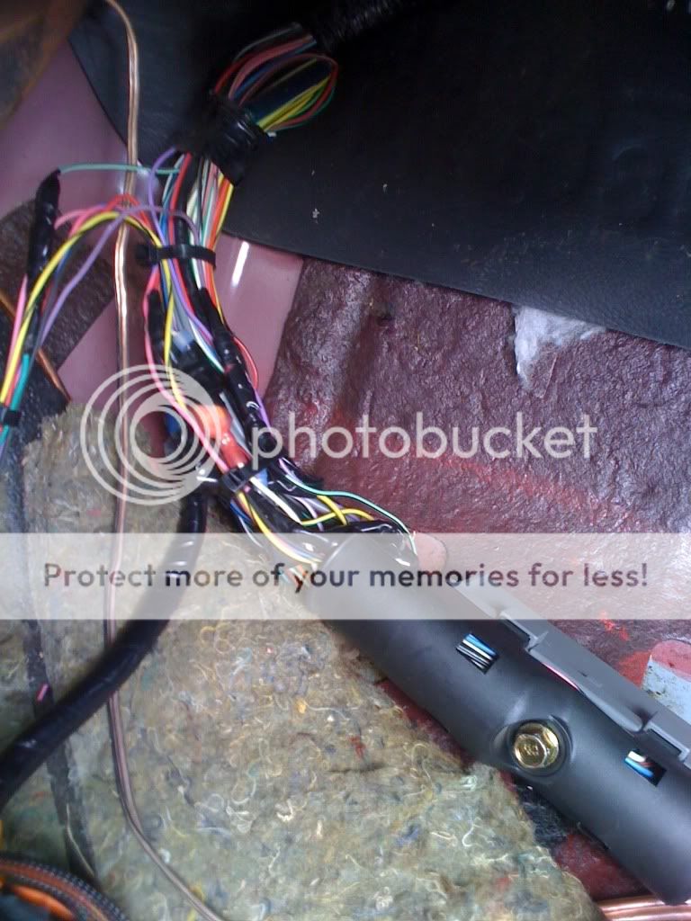

It was alot easier than I thought it would be. Everything is running fine except i need to get some real vac line. (just using regular tubing-and its the wrong size...lol)

and ya this install is really cake, people get all freaked out from all the wires and stuff, but it's really easy once you separate it, and I highly recommend getting some vac lines from http://www.siliconeintakes.com/index.php?cPath=18&osCsid=7b79c072b1896d5ca9afc8f07e959d54 the walls are really thick and they handle the heat very well too, haven't had any problems what so ever in the last 2 years about that I have run them, and I haven't had to replace any yet, and they are pretty cheap, just get a bunch of it and you can always have extra, it's nice, for $50 I got tons, some 4mm I think it was an mostly the size closest to 3/16" and I just used it for mostly everything, and still have some left over
