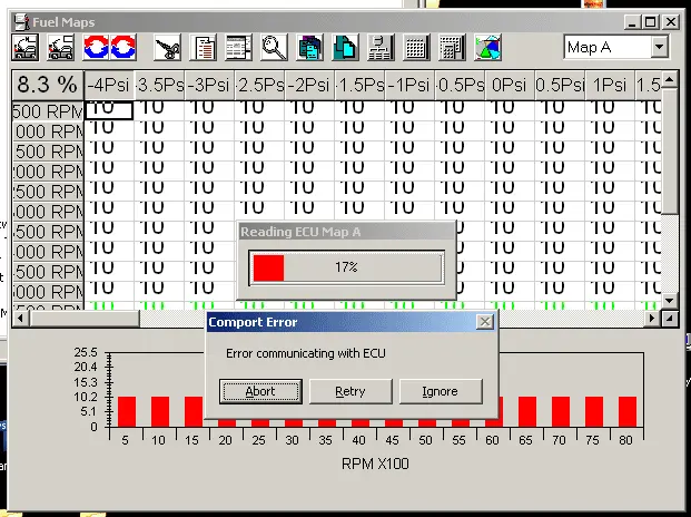

finally got a battery for my laptop. connected to my ssafc v2 and tried to download the map as a backup and ran into this error. now i remember why i never played with this unit much lol. anyone else have this issue? tried both of my usb ports which is mapped to two different COM ports.
attachment.php
i had that problem when i tried using a cheap chinese cable. After I got a better one from amazon with the correct driver I haven't had any problems since.
Ok maybe that's my problem. I bought it off eBay a long time ago. You got a link to the one you use that's tried and true?
i went ahead and ordered the gearmo cable as i'd like to be able to read from and write to my unit. i was able to datalog on the way home today but not on the way to work this morning. morning's log gave me an error lol. screw this cheap cable. i have the cable that runs off of the prolific driver which is cheap and unreliable (for me at least). based on my research the gearmo has a ftdi chip which is the better one.
