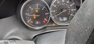

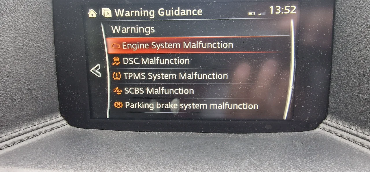

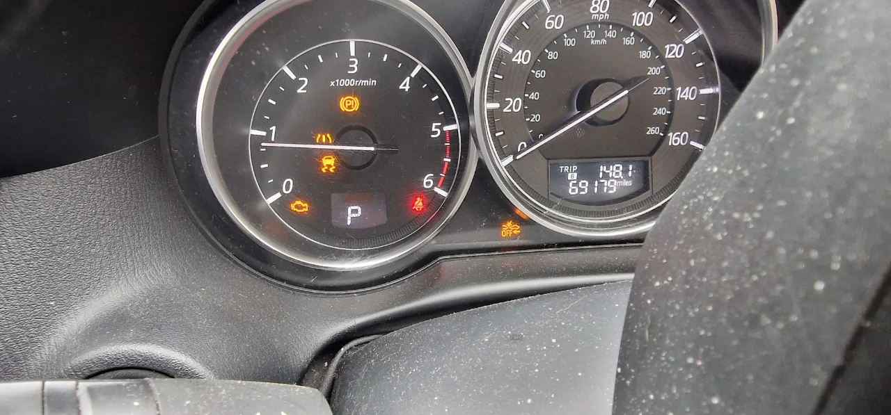

So I have a 2015 CX-5 and have all these lights on my dash..... I cant spend any money on it at the moment but I will be cleaning the dpf later today. Are the other lights a serious issue or are there simple fixes for this.....
On top of that, I am in limp mode and the DPF warning light has come on.
I have tried resetting the errors but they came back pretty quick.
PS. Limited funds and I have a spanner or 2

I have checked tyre pressures. All ok.
I have checked oil level. its ok.
I will be cleaning the DPF via the differential pressure switch later so will see how that goes.

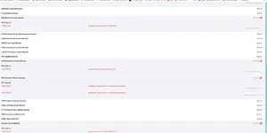

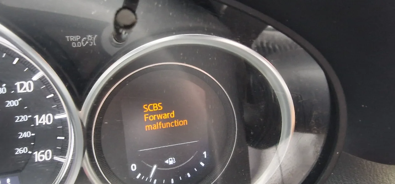

The scbs issue did yes but the DPF issue just happened. I have had it hooked up but i got no further and they all lit up at the same time. see report.
Coincidentally, when I got the car I decided to update all the software to newer version. The battery turned out to be dodgy and I replaced it shortly after the software update so, I dont know now (after reading something else) if the dodgy battery caused a dodgy install of software. I will reset the computer and see what happens.

Do you have a device that plugs into the diagnostic port under the dash? You said you cleared codes so I assumed you had a device or are you just pulling the battery terminal off.
You should be able to get a useful code reader/diagnostic tool for 25 pounds. On my side of the pond, many parts stores will read the codes for you, free.

I've had a dashboard like this on my previous 2013 CX-5. In my case, it turned out to be a weak battery ground. Disconnect the battery and clean the cables really good. Reconnect and secure it tight. See if it works.
A bad module can cause the canbus to glitch out also...eg if the abs module goes faulty it can drag down the rest of the communication system causing all those codes
Have you ever replace the exhaust gas pressure sensor? If not replace it with an upgraded one.
Then unblock the DPF and all will come naturally.

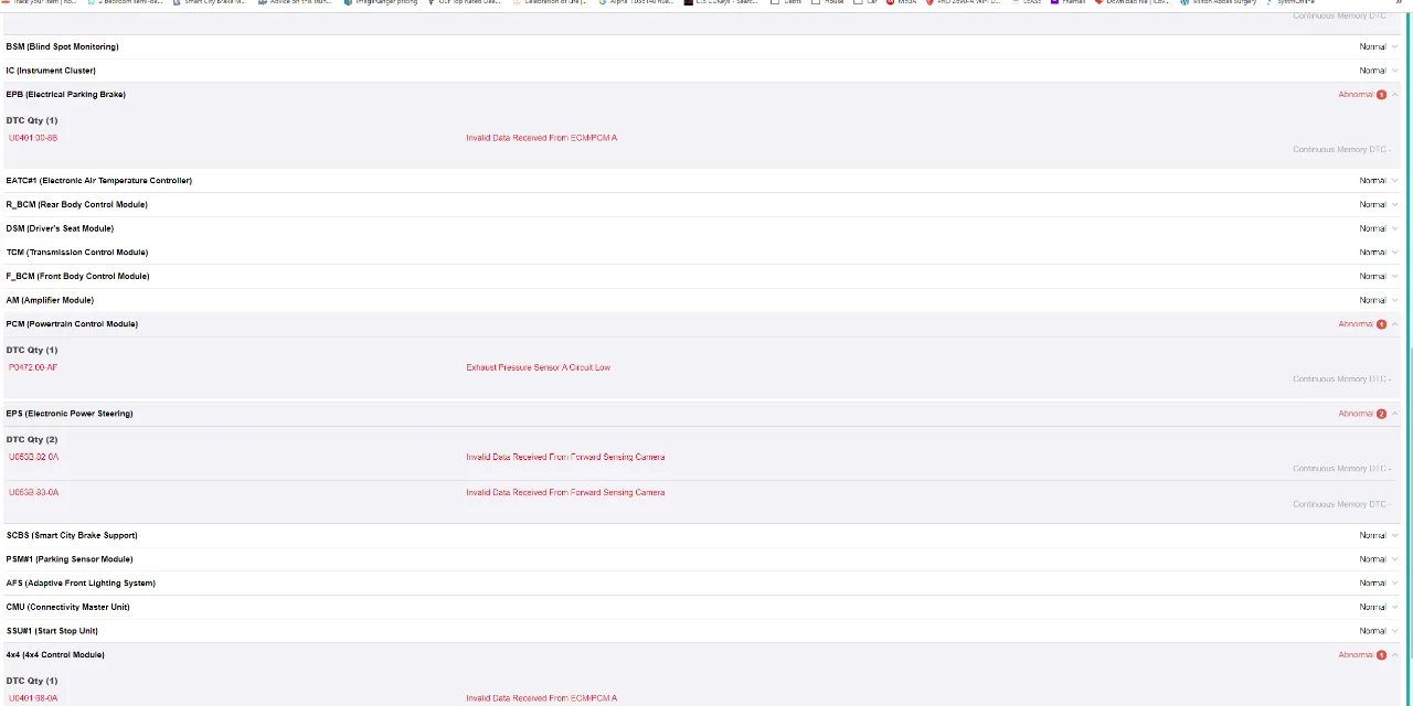

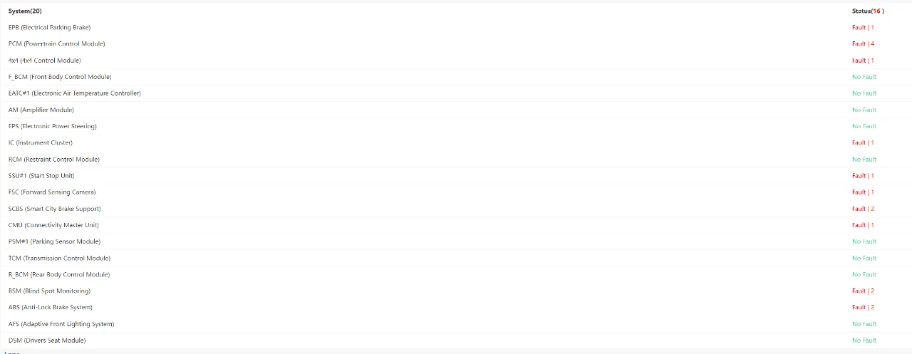

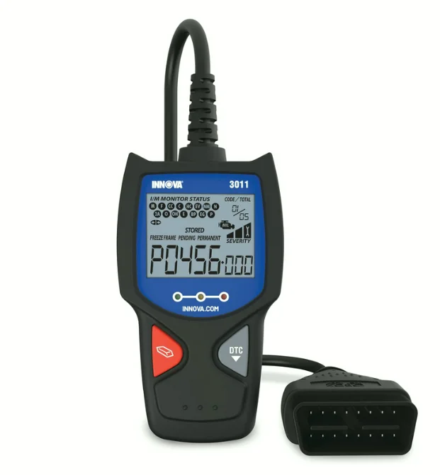

Ok guys, I spent a few quid on a diagnostic tool and I have the error codes as in the attached. I tried to clear them but I obviosly didnt spend enough on the tool lol. Can any one help???
I wonder if the "undefined data" is due to corruption.
Your tool can probably clear the codes but it might be tricky to figure out how. Just keep trying.
