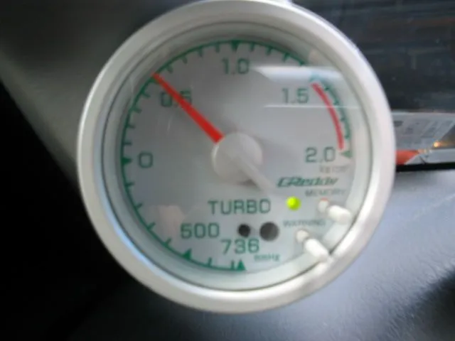

I have a 60mm Greddy electronic boost gauge. I am having trouble adjusting the warning. Can someone please give me a how-to on adjusting the warning. I have had a play with it, and when the memory button is pressed the gauge shoots up to 1.5bar, but the red light comes on at 0.5bar.
Also, does the Greddy have a buzzer to act as a warning as well as the light?

It comes with a small key to adjust the warning.. i think you need to buy a special harness to hook up the buzzer warning, all it is, is a light.
just turn the one button, so the boost gauges shoots up. then use the knob to adjust where you want the warning to be set. it is much easier with the key they give you, but can be done with your fingers as well. The warning knob is very sensitive.
also to reset your max boost warning hold in the button you can push in and it will flash, then reset.
It is a sweet gauge, great for checking for spikes, or upping the boost.

if the memory button goes to 1.5bar hold it to clear the max boost. I hope it came preset to 1.5bar and you havent spiked that high (eek)
at what boost do you wanna set the warning?
