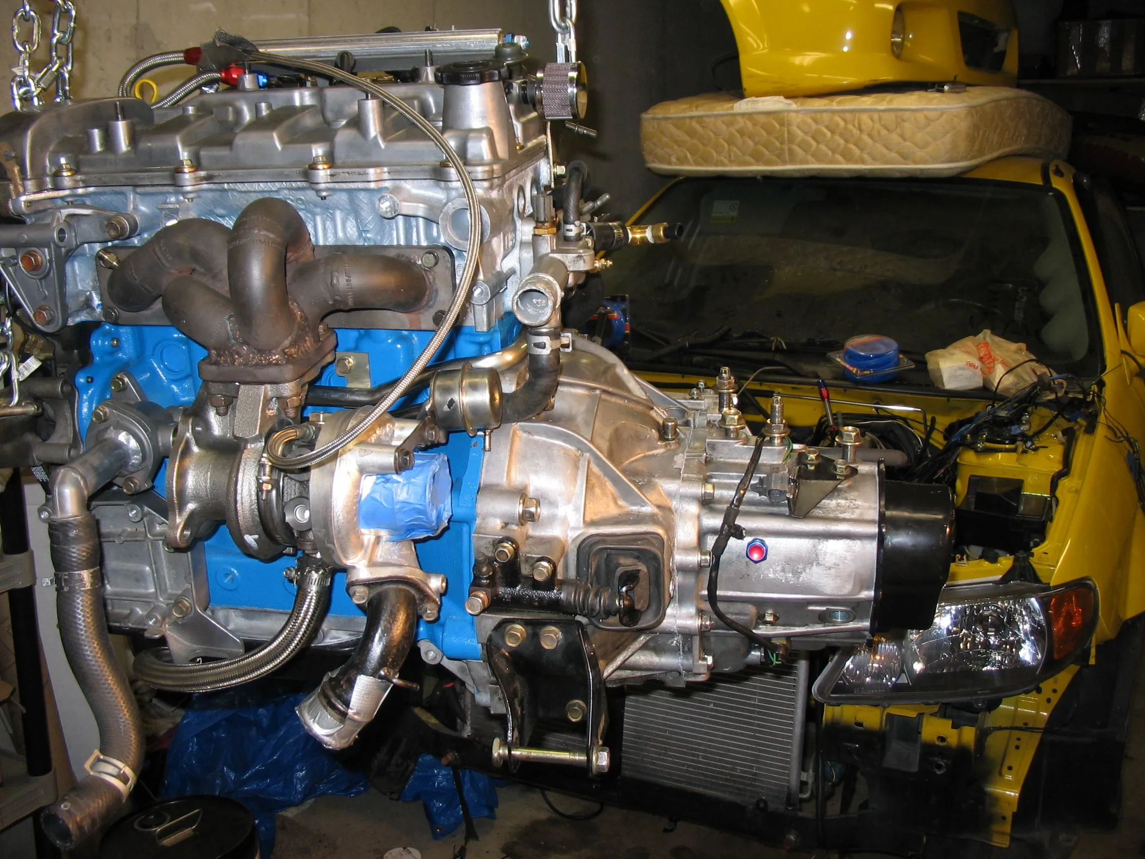

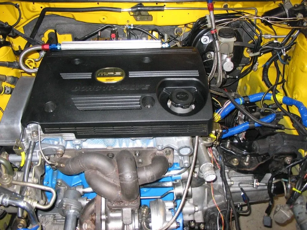

Pic of the motor in it's first days
Bump... added more updates to the first posts explaining how everything went as the motor was put in and broken in.
I love your attenion to detail, and great descriptions to help other in the future.
Great write up and picture.
Good luck getting the numbers and performace your looking for.
