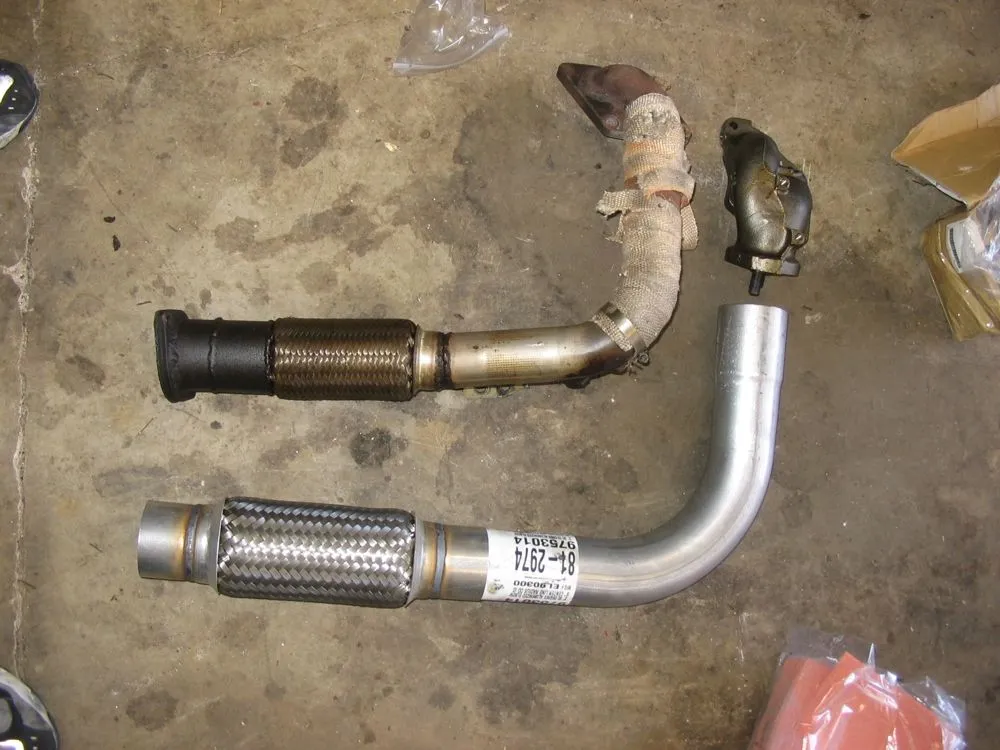

Big modifications that i want to make to the car.... remote mount of the thermostat so I can run my true 3" DP and cast O2 housing which should make an absolutely MASSIVE difference in the performance (my DP is like 2-2.25" right now and welded like crap). And also fixing a warped flange on the exhaus manfiold. Once that is done I'll also be doing some cooling and gear changes on the transmission to get that to hold up better... those couple of things should get the car fitte dmuch better..

Glad to hear she's coming along. So what's this DP/cast O2 assy look like? Any pics we can look at?
here is the dp comparison pic... it doesn't do the size difference justice... in person it's like WTF!!! LOL :)
