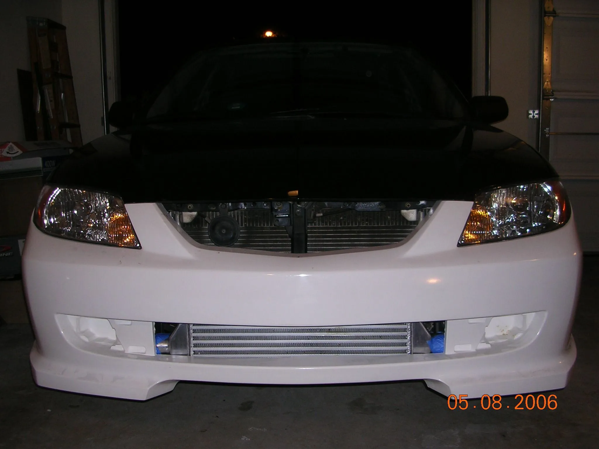

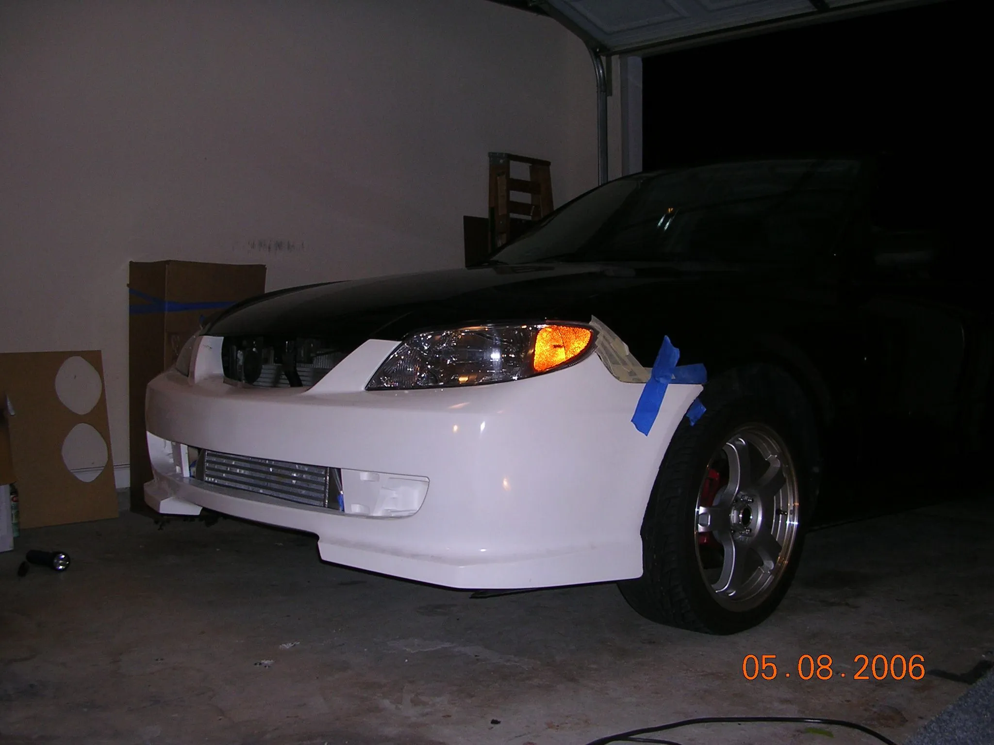

So I got my IC core mounted today which officially kicks off my boost project. all the hardpipes I bought will have to be redone but Jay gave me a bunch of extra pipe and urethane connectors so I am hoping it works out.
Sedan to turbo won't allow you to run msp pipes because of the radiator. The guy who had the turbo before me ran the pipes right where the wiper tank is for the hot side because he had a cf hood and didn't need it. I want to hold onto that so I'm following Mam's IC design hoping for the best. Not sure what to do with the device that sits above my stock intake by the throttle body. Read something on that somewhere so I gotta track it down.
Been working for two days on this damn bumper. It's not ready to bolt on as they say. I'll go into that on the next post.
Pics
Bumper on with core mounted. It's a tight ass fit. I pushed that thing all the way back to my hood support and even banged on that for a while to flatten it out. that b**** isn't going any further back and I still have to cut the bumper.

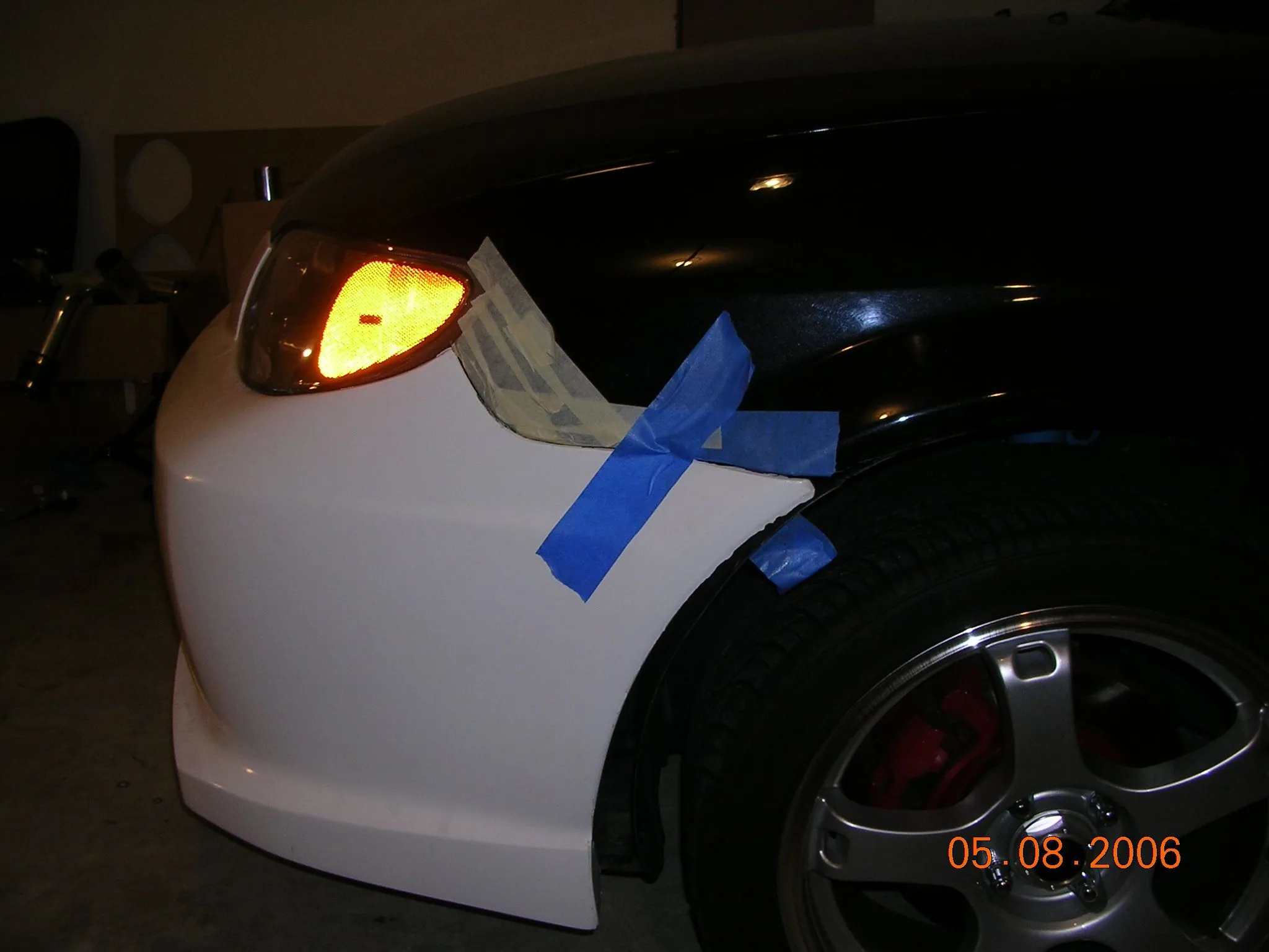

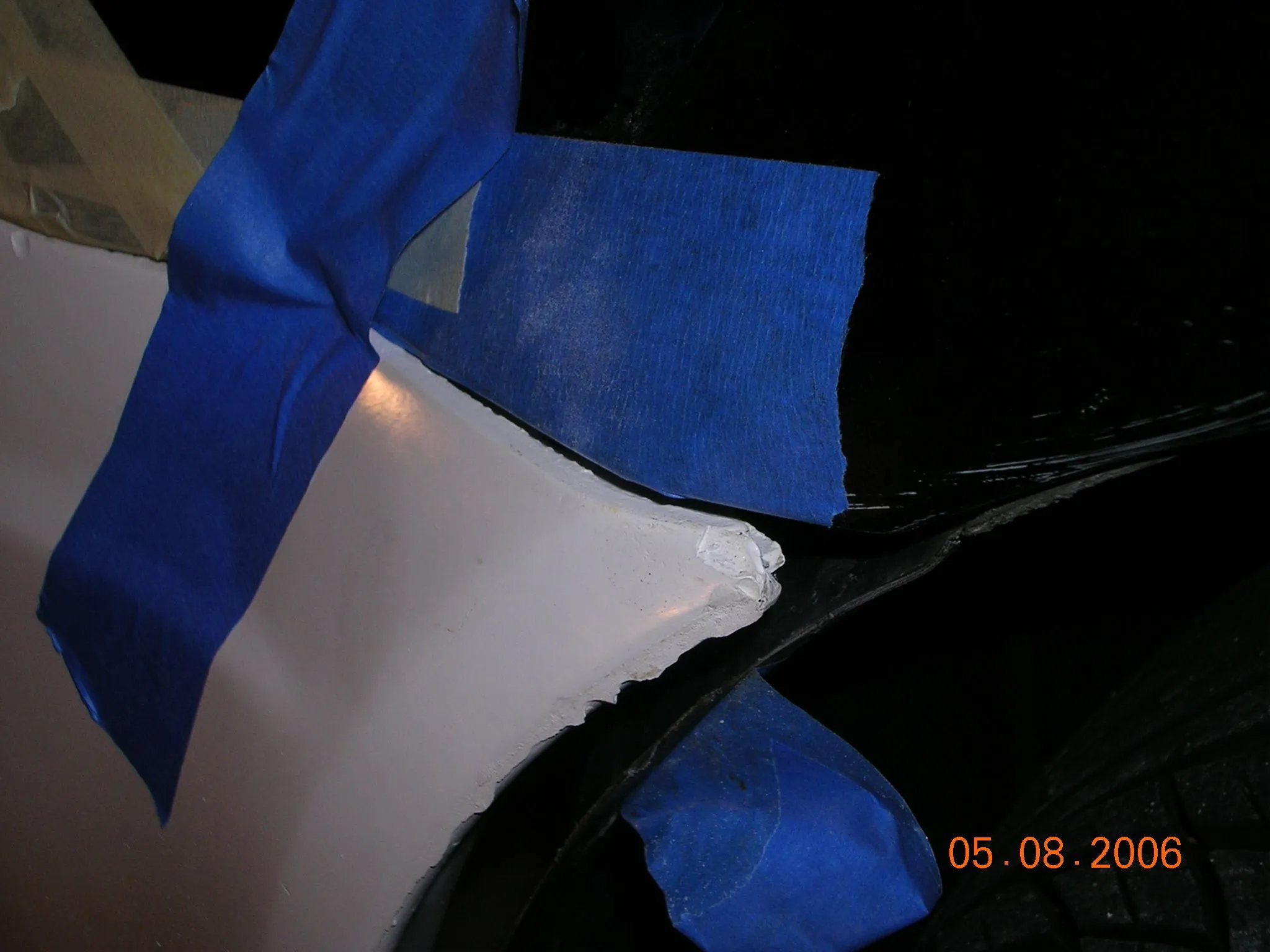

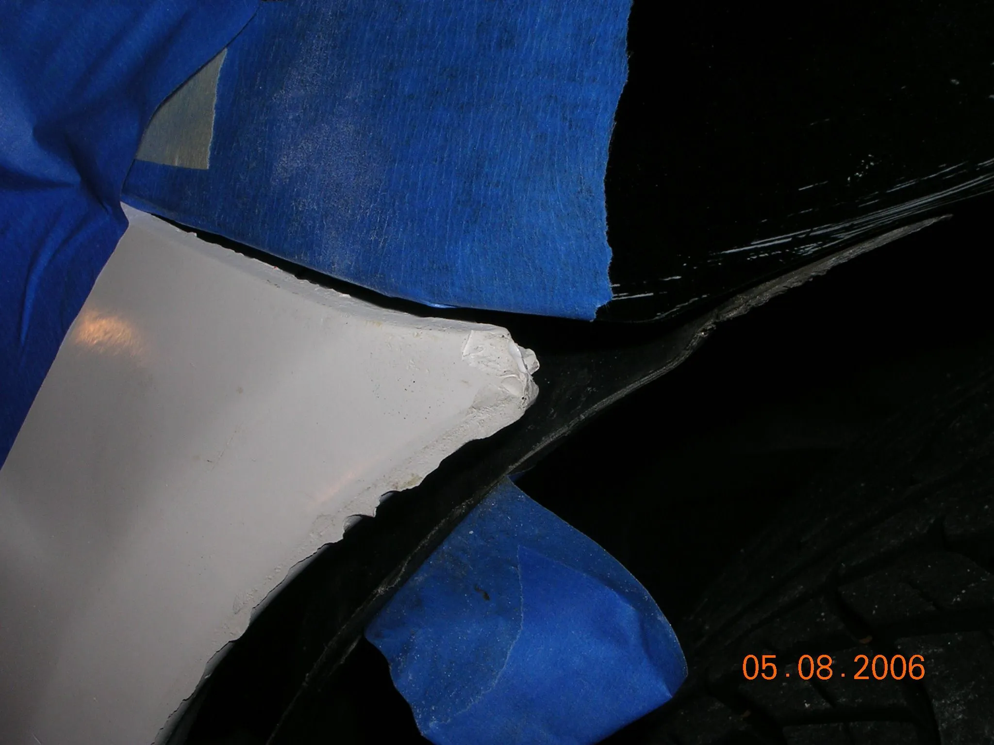

yeah so I get this bumper and right away I see where they pulled it off the mold and didn't clean it up. On top of that they primed the whole thing which was pointless cause I gotta bondo the s*** out of the edges to fix that not to mention the corners that didn't come out of the mold.
I can tell the chips were there when they shipped the thing cause they primed right over it. I planned on glassing custom scoops where the studs are next to the fog light pockets so it's not a huge deal. I'm just worried about the corners holding up and the mounting tabs on the side being made out of glass. I am definately going to re-inforce those bad boys before I do any hard driving.
pic 1: chipped corner, yeah I'd love to know who didn't notice that one.
If anybody had done any body work of this type I'd love some advice on glassing around edges and corners. I have body filler, bondo glass, glazing cream and real deal resin and matt. Can't say I am any better at one or the other but I've used them all.
