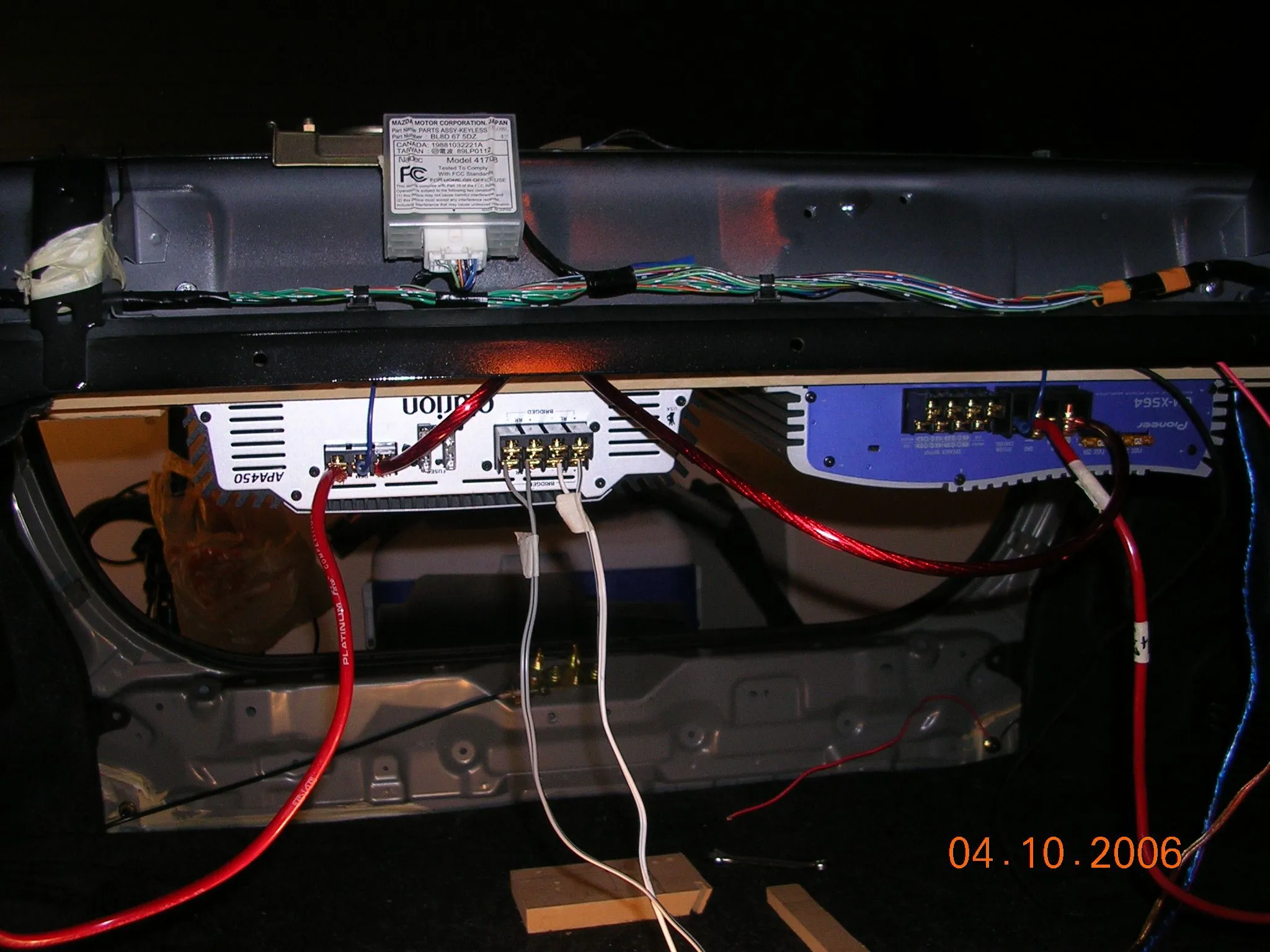

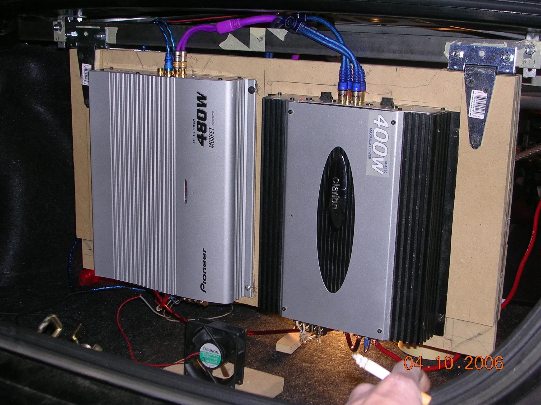

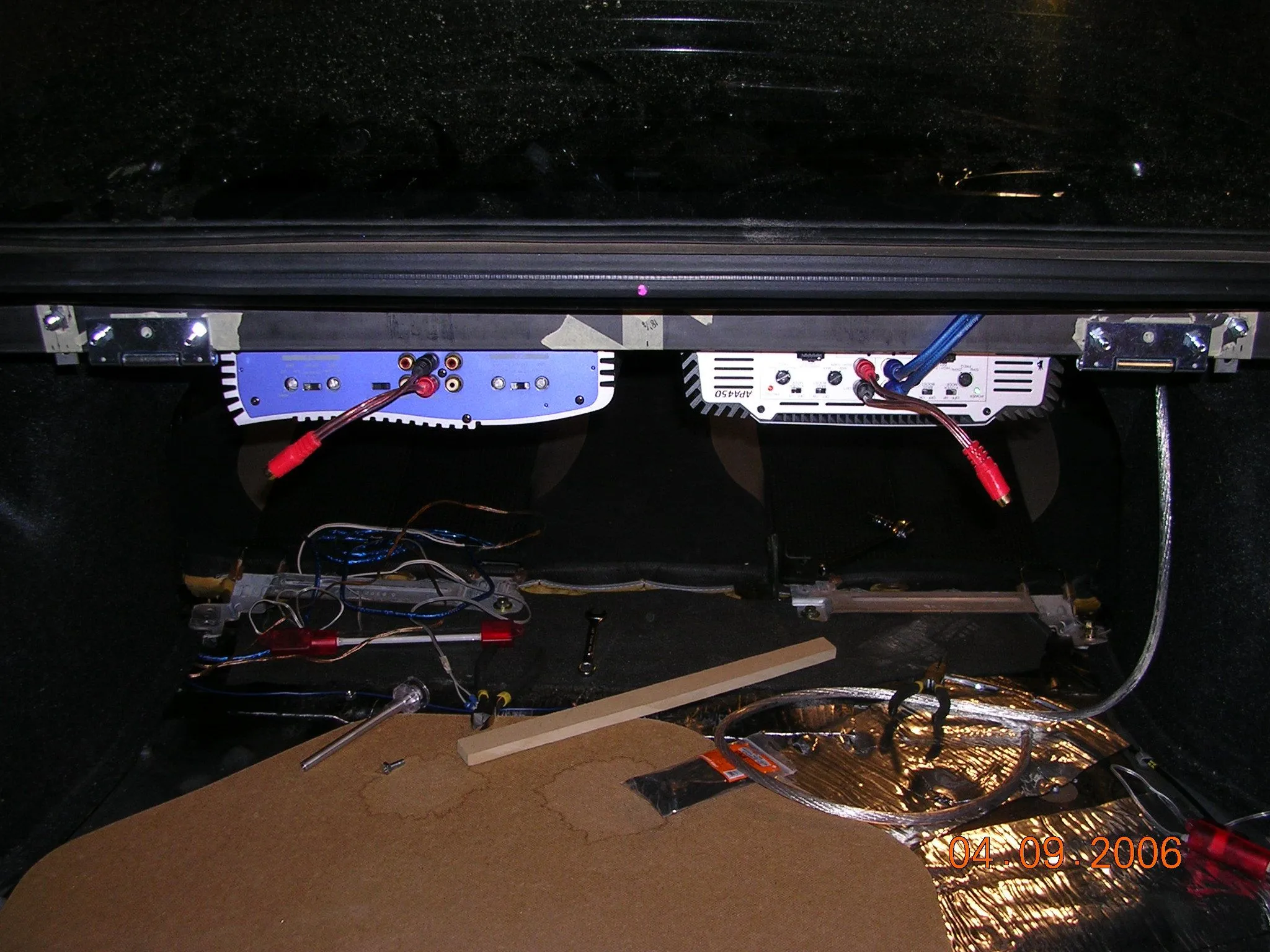

Awww yeah shawty. Amp Rack phase one complete. The b**** is mounted and temporarily wired up. I am going to leave it alone till I take care of some other things that need my attention. (if you didn't notice already my car lacks an interior right now)
However I would like to pat myself on the back for this one cause it's pretty much the coolest thing I have ever built.

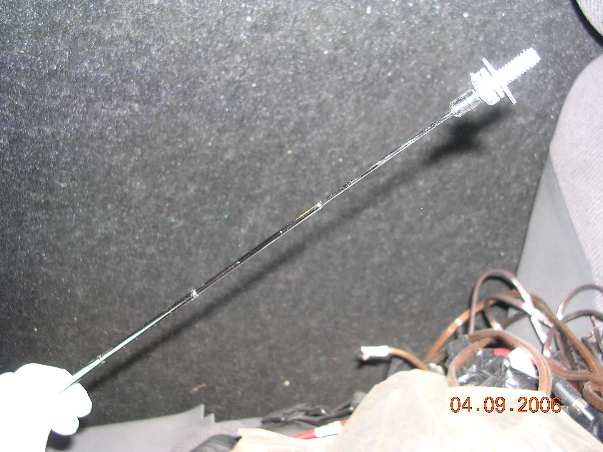

Favorite Tool (Pic 1) - the magnetic retractable bolt getter device. It is so tiny yet strong as hell. It held my bolt a lock washer and a regular washer up against the bolt till I could fish that thing down in the vents of my rear deck skeleton.

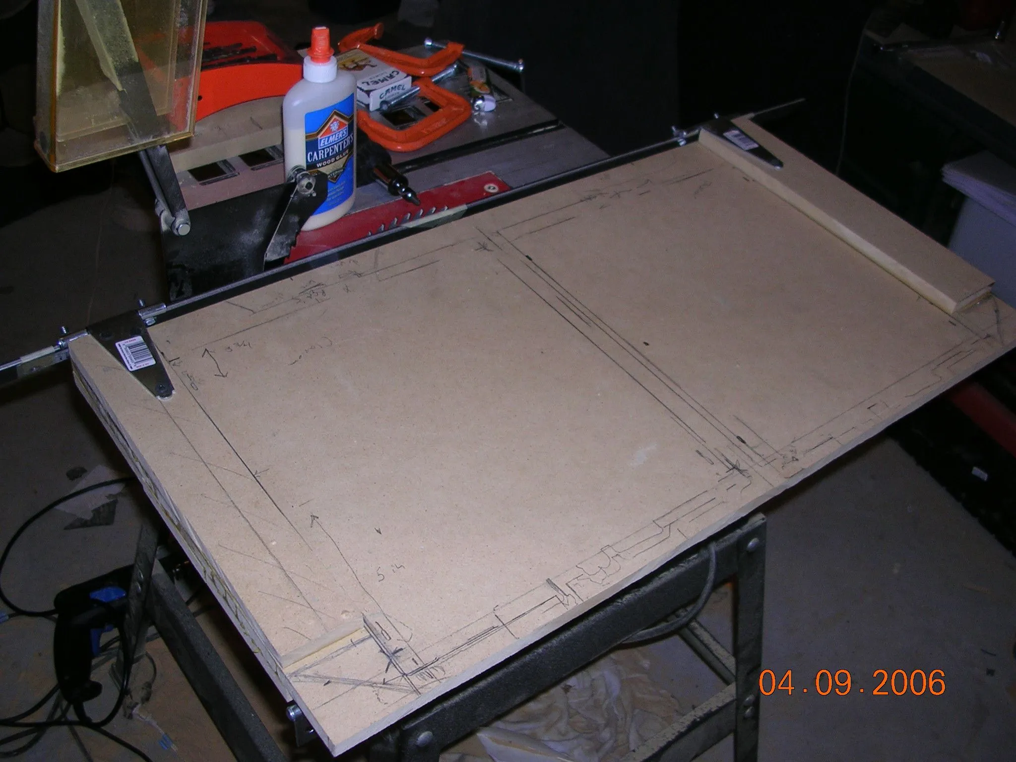

The Concept (Pic 2) - build a big door and flip it on it's side, chuck the amps on there and fasten it to the roof of your trunk. This was my inital sketching/placing of the amps. I hadn't intended for them to be mounted sideways (Pic 3) but that is how it seemed to fit with the airflow setup I am going to build later. This will be phase 2 with all the fixins.
I had to put in a 2 inch steel bar across the back and bolt it to the trunk. It is solid when everything is tightend down (almost too solid) I have a feeling that it will shake itself loose after some hard driving so this mount setup is temporary till I find somebody who can weld my brackets and maybe fabricate some sort of lift system.
More pics below of the mounting...

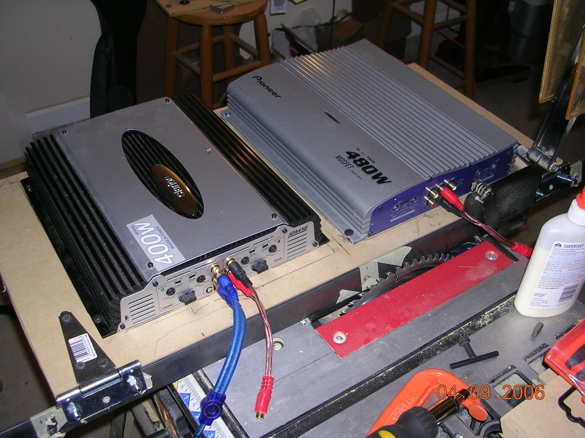

Amp Rack Continued...
Pic 1 - Amps hanging in down position. This is for wiring purposes and hopefully for display. I found it was easier to use a hinge for mounting then try and figure out how to make some level setup with the odd angles from my rear seats to the trunk. At the bottom you can see one of the fans I got for airflow. Those things are powerfull as hell. I got cold in my garage for the breeze it was kicking outside the trunk from there.

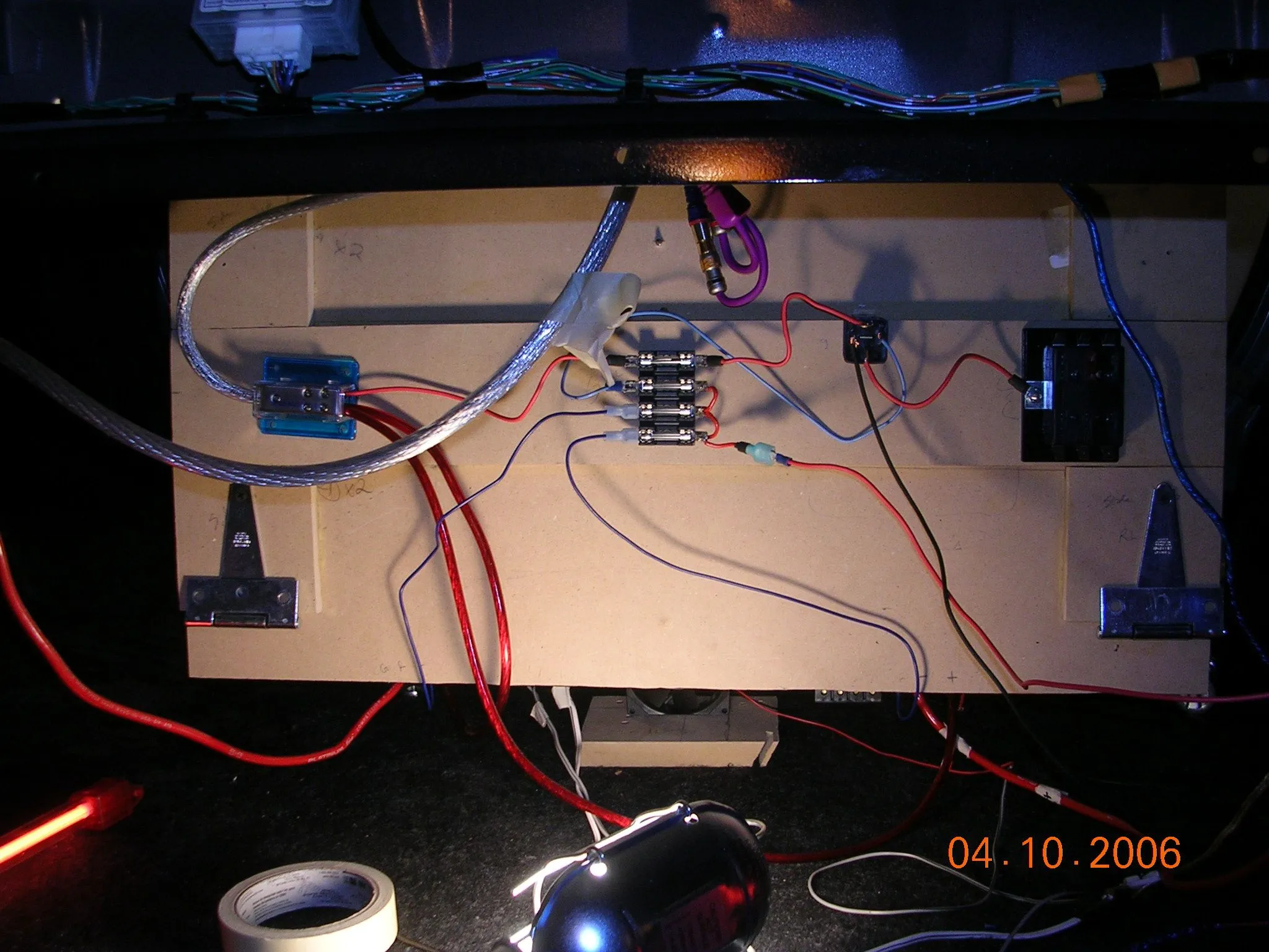

Pic 2 - Down on the backside. All of this was accesible from the rear seats. None of these devices are screwed down, just 3m sticky for now. Got my Borsch relay up there for display. When I'm done with all the wiring I want to make This side look pimp. display is good but the best thing about this rack is that all my connections to 90% of my devices are self contained. All I have to do is disconnect the main power and ground wires and The whole thing comes out.
Pic 3 - Rack closed, trunk view. One of my favorite parts about this configuration. I can tune my system from one spot, standing up, and in a position to hear changes from a relatively neutral spot. I made sure any switch or dial was exposed and that will continue with the beauty crap if I ever get to it.
Pic 4 - Seat down view. Another plus is having all your speaker/power crap in an easy to get to spot for installation. and the little plates that the wires are supposed to tuck into (or connectors if you are fancy like that) anyway those plates are now resting against the top of the screw which is now upside down. No get annoyed with the wire and plate game here folks.

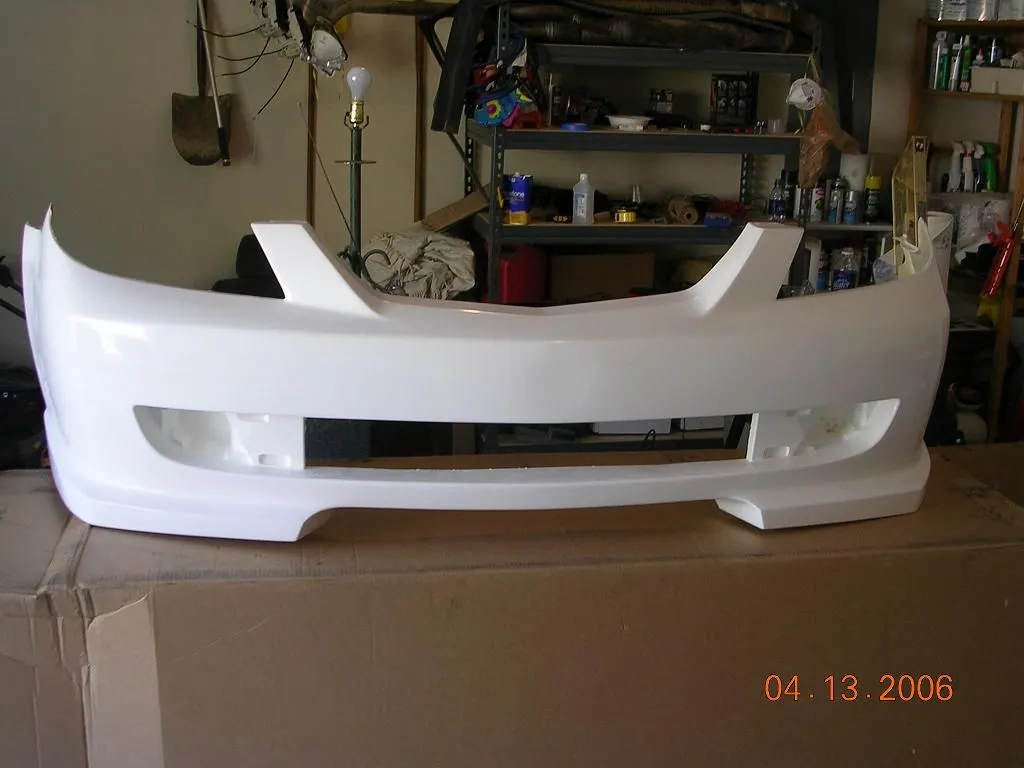

Bumper
Awww hell nah. No he didn't.

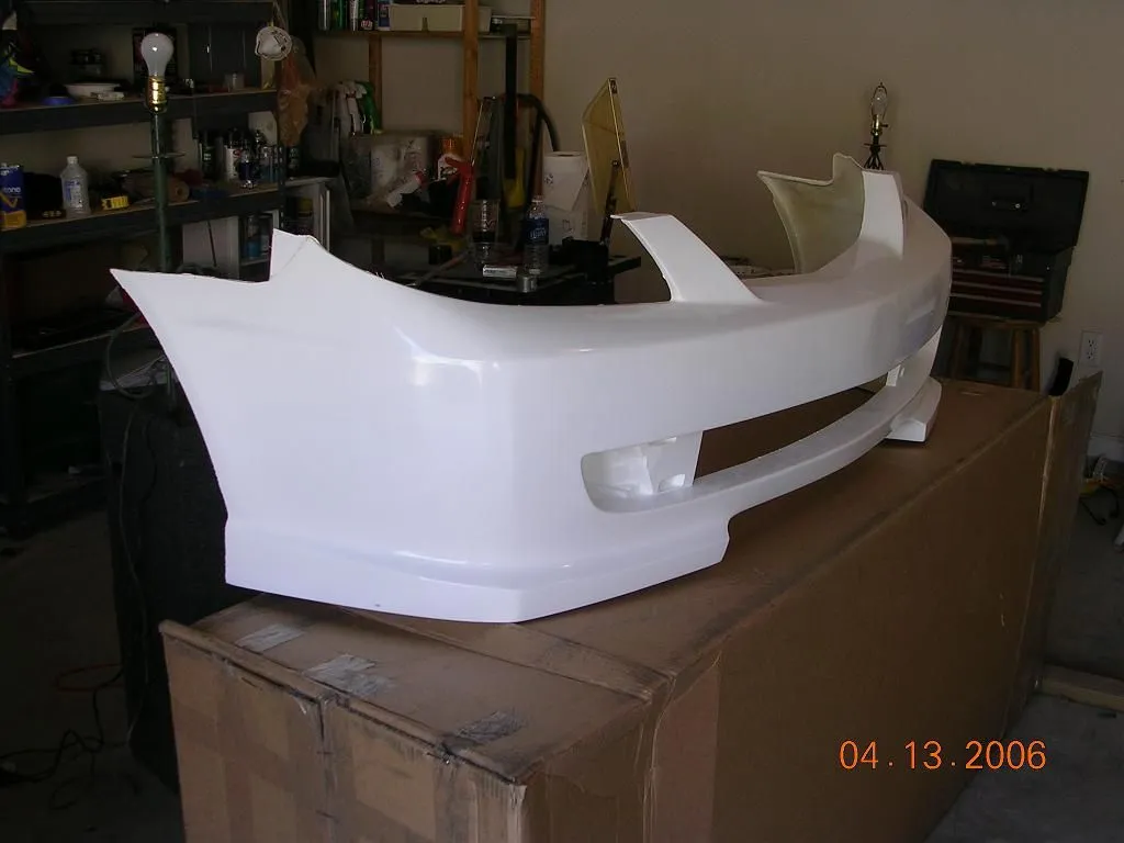

New toy arrived today. Probably going to have this one painted by a pro if I can't figure out this painting thing. I will give the rear lip i just got (in the background) a shot with the paint.
Probably could have gotten a msp setup for what it cost to ship this thing but I wanted to keep the theme of suped up LX rather than LX to MSP. So I chose this guy from Corksport. Pretty much the sedan bumper with a lip all in one solid piece. Might try and make some scoop pillars next to the fogs similar to some of the aftermarket second gen bumpers.

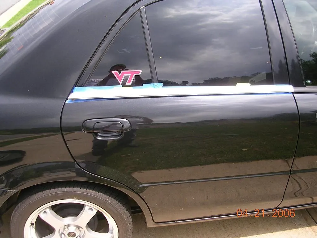

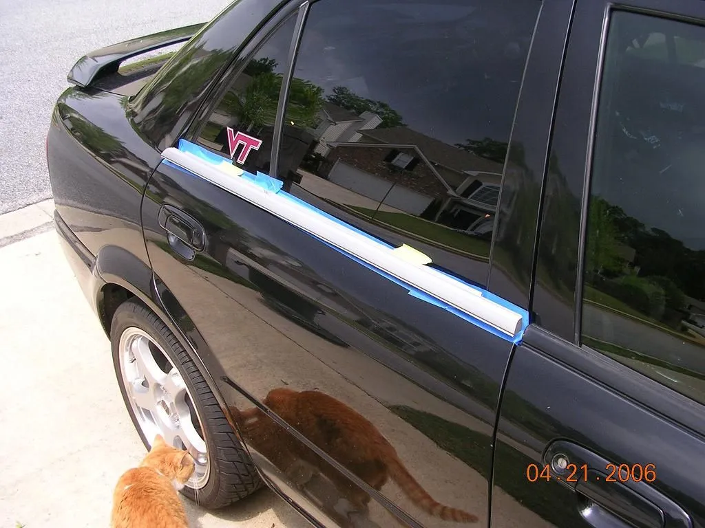

Project Silver trim has begun:
I've already painted some of the interrior silver but I had a thought on the exterior. My rims are silver. I honestly think black rims look good on a black car but I wanted a 16" wheel that looked good and there just wasn't anything that size that fit the bill. So I went with the silver drifters. After that I decided to paint the trim the same color, silver charcoal looked about right and so far it's close enough for me.
The Silver es has black accents in the trim, grill, headlights and so on. I figured I would do the reverse on my black sedan. So the door trim, upper grill trim and my headlights will be silver. rear valance and emblems also. Gotta get that chrome off my car with a quickness.
I have painted the first piece, hasn't been sanded or clear coated but i wanted to make sure I was going forward with it after the pics. Also posting a real rough sketch in paint of where the trim will be including the mirror cover I am painting.
Edit: By the way I did take the piece off to paint it. I don't recommend just masking and going at it if you can avoid it. The tape is to stop the rain while I do this. And GO HOKES!! The hokie nation will be upset to know that I am removing my stickers but I will have VT on the car but it's going to be more descrete. (I know I know the definition of a hokie is not descrete)

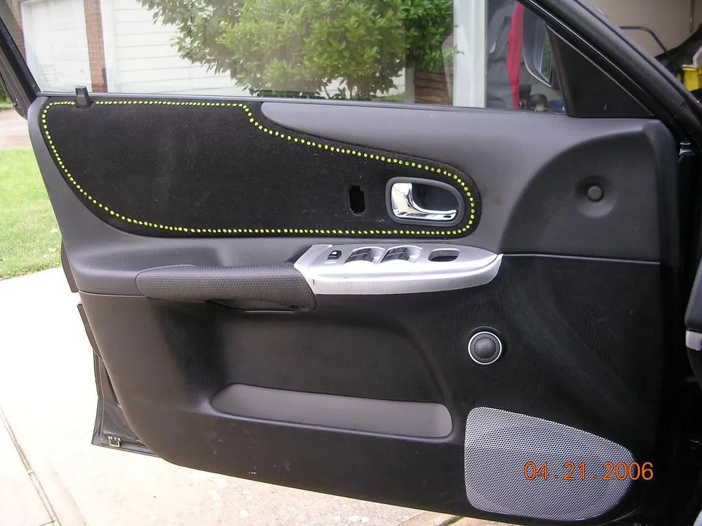

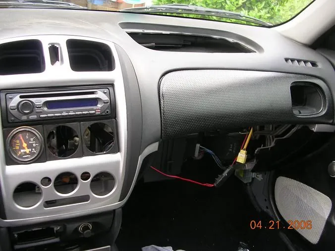

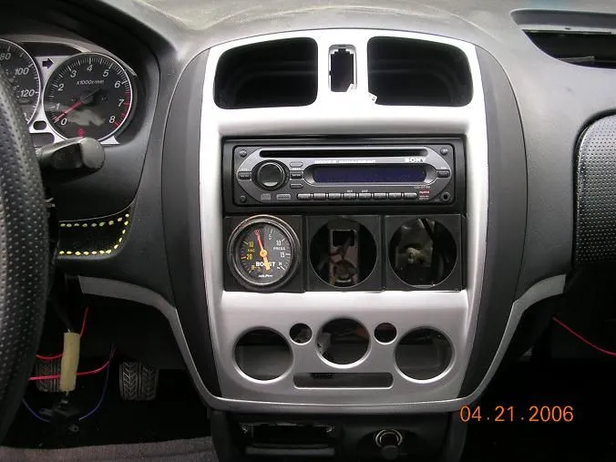

Interior Update
I hate myself. I don't know why the hell I think I can do something off the wall and make it look good. My advice if you are just starting out is stick to the basics and get good at that.
I will post some pics but I am repainting the dash all over again (3rd time) 1st time didn't look good in the low areas. Now I just don't like it. The Doors are the same thing. the yellow dots were a retarded idea and wasted way too much time. I do think if i had just painted the door fabric black to begin with it would have been good to go. So if you are thinking about painting the door fabric, dupli vynl fabric is the way to go. I've got a post around here about how to get that color to stick and look good.
I do want to have yellow accents in the fabric so I will have to take it to a pro. Want to get a black fabric with a sewn edge in yellow like the seats.
The speaker grill I have hated since i got the car. I thought painting it would help but now it just looks stupid in a different color. it highlights the pointless shape. Going back to black baby.
The upper part of the door I tried yet another silver accent but it looks dumb because I am paining something that isn't a different part. it chipps and is really noticable. back to blak.
The control panel is a perfect piece to paint. comes apart and you can go to town, however i really messed up and sanded the crap out of my mistakes and eventually it turned smooth while the other parts have texture. Nothing to do now but sand the whole thing down till I can get some high build primer to make it look flat and then gloss it up.
The final crappy messup was the silver line across the dash. I had intenede it to be a seporator for the upper grey and the lower black but it doesn't adhere very well to the texture so I've gone completely to KRYLON FUSION satin black. This stuff is such a time saver and money saver. I can't afford to go through all this again on the textured vynl. Krylon is no sanding prep, just clean very good. i sanded a bit to rough things up and to improve adhesion but either way. No clear coat required. it looks good on the pieces I've done (dash pad was the only one i have a pic of)
I decided the transition of grey to black would look better than the grey eventually chipping line that I sucked on. plus most older sedans with black interrior have already faded between the cloth color and the plastic pieces. almost looks the same. whatever i am just ready to be movin on.
comments good or bad are always welcome on this project.

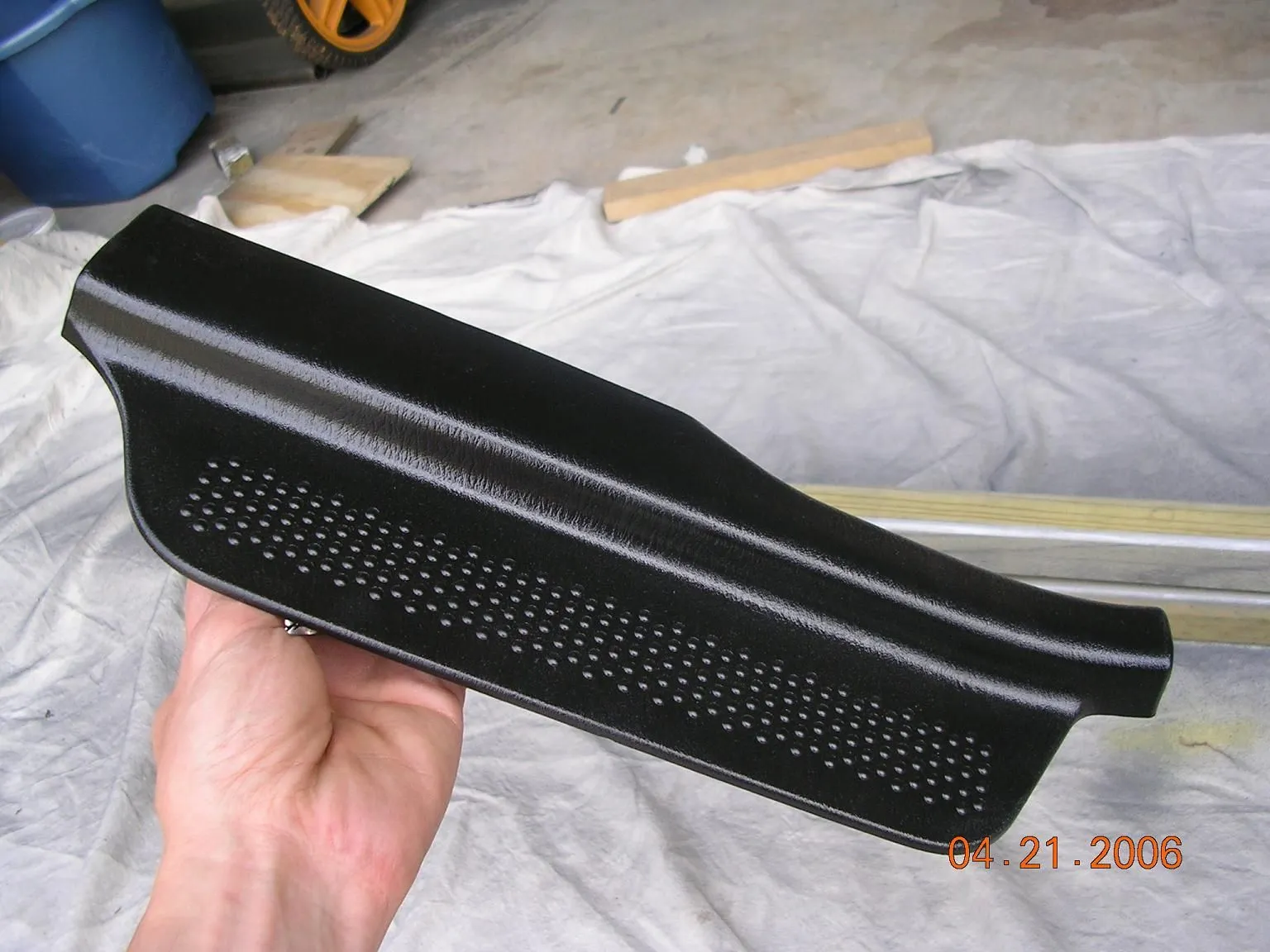

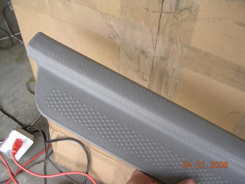

Krylon Fusion
Ok I promise no more long winded crap for a while.
I wanted to show what Fusion Black (satin) looks like on a painted piece with texture. I am very pleased with the results. Even though this is a flat black I don't feel the need to clearcoat. If you wait a week your first run will cure in 7 days. i've been punching this piece with my rings on and no chips. You can add more coats then. I only feel the need to do this on a few pieces. This particular one hasn't had the second coat but you can see how it gets in the grooves.
I kept the pics big so you can get a good look at the piece so if you got rats running on wheels in that machine don't even bother.
Pic 1: Color before
Pic 2: Painted piece
