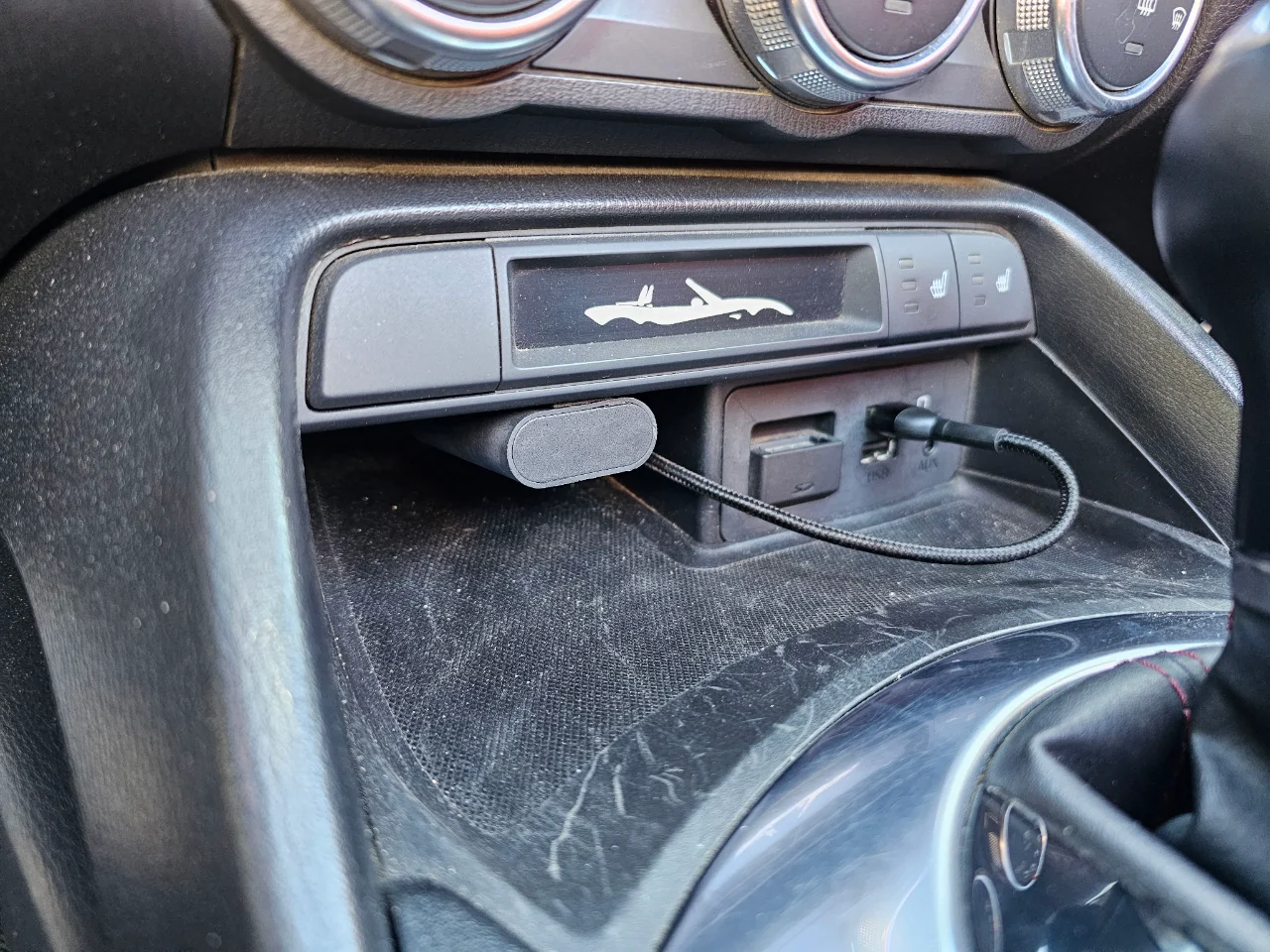

For reference, here's a pic of the AA Wireless Two dongle in my Miata to show how discrete they can be.
Appreciate you explaining the process even though I lucked out not needed to modify my car’s USB hub!
