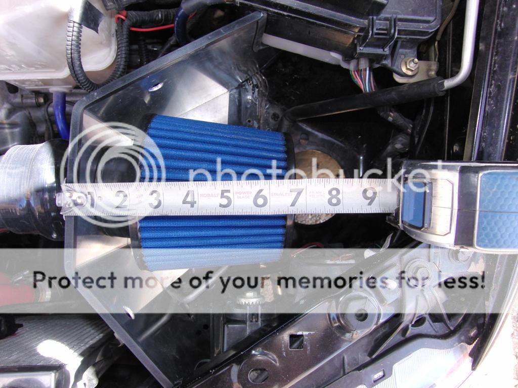

Edit: Will a 5-1/4" od filter fit the box?
5-6" filter should be able to fit with no problem if you relocate the MAF
also i feel Rich should show a birdview picture and mark the dimension of the box
i can get the 5-6" filter easily, but i just saw a 8" length filter with super good price, i wanna know if that would fit in there or not
Yes.
8" filter will fit if it starts at 6" diameter and tapers. Larger than that and you might have to crush it in against the back of the headlight.

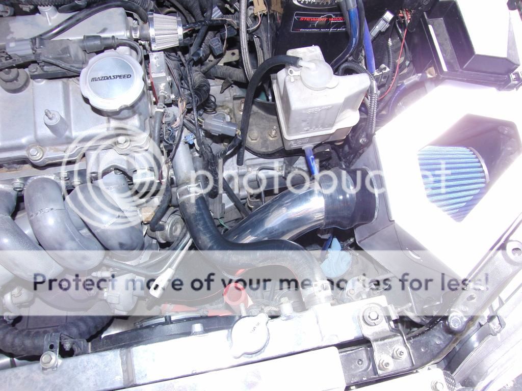

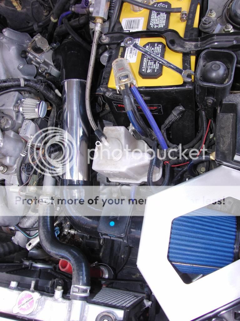

Finished N/A kit routing:
Finished 3" routing:

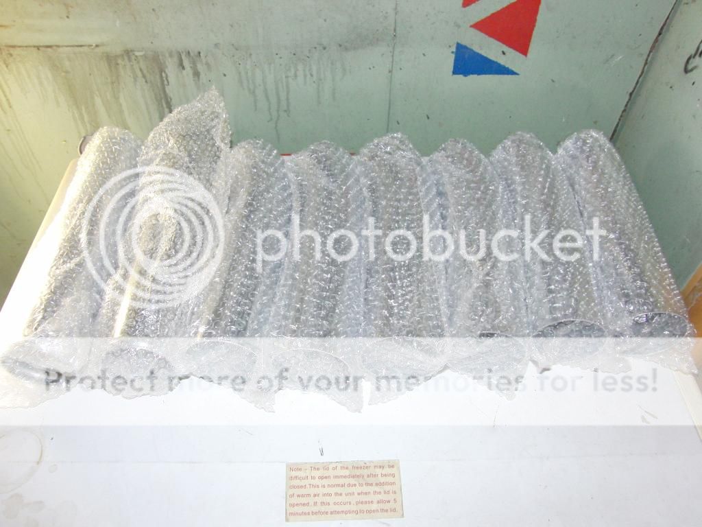

Piping all cut to length and ready for VCB & BPV ports:
guess i would need to angle the filter roughly 10degree to make it fit with OE light
but my HID wire end are much longer might make it even difficult to fit
maybe 2nd batch Rich could move the hole few cm away from the headlight, that case we might be able to fit a foot long sandwhich in there.

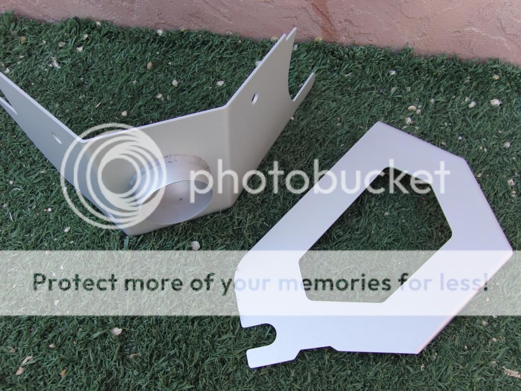

I just realized you made a kit for Lewis7789 with no cutouts in the lid for AC lines... Any chance you made an extra one like that?
ALL piping kits are 100% fabbed and over at Wes' place for VCB and BPV port welding. Should have those back by Wednesday.
