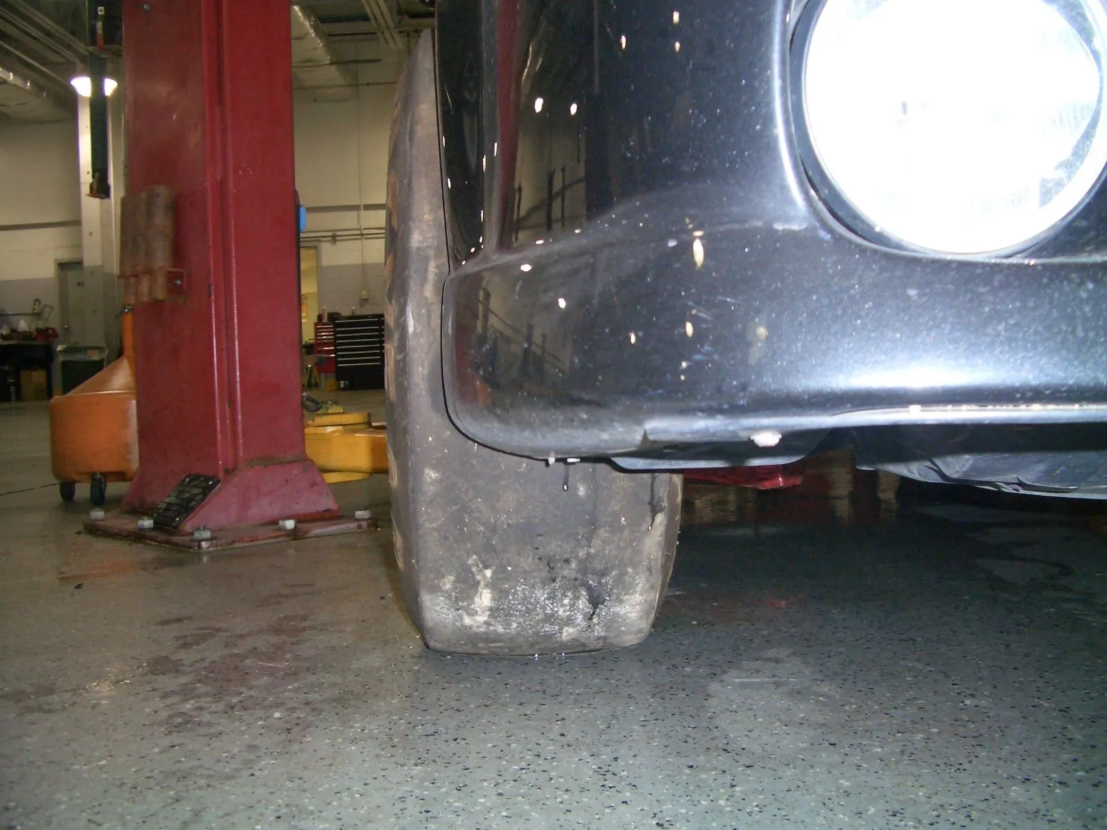

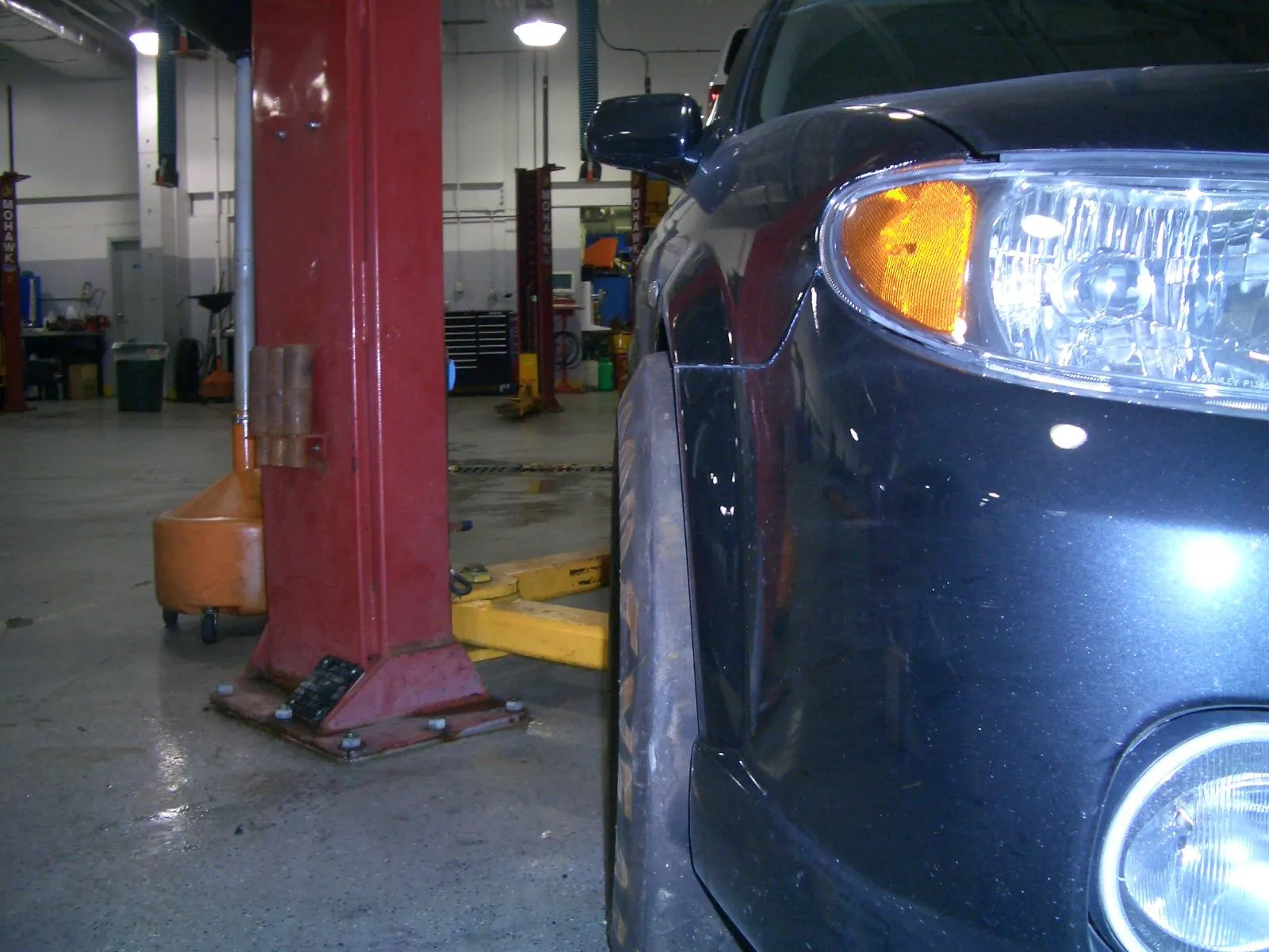

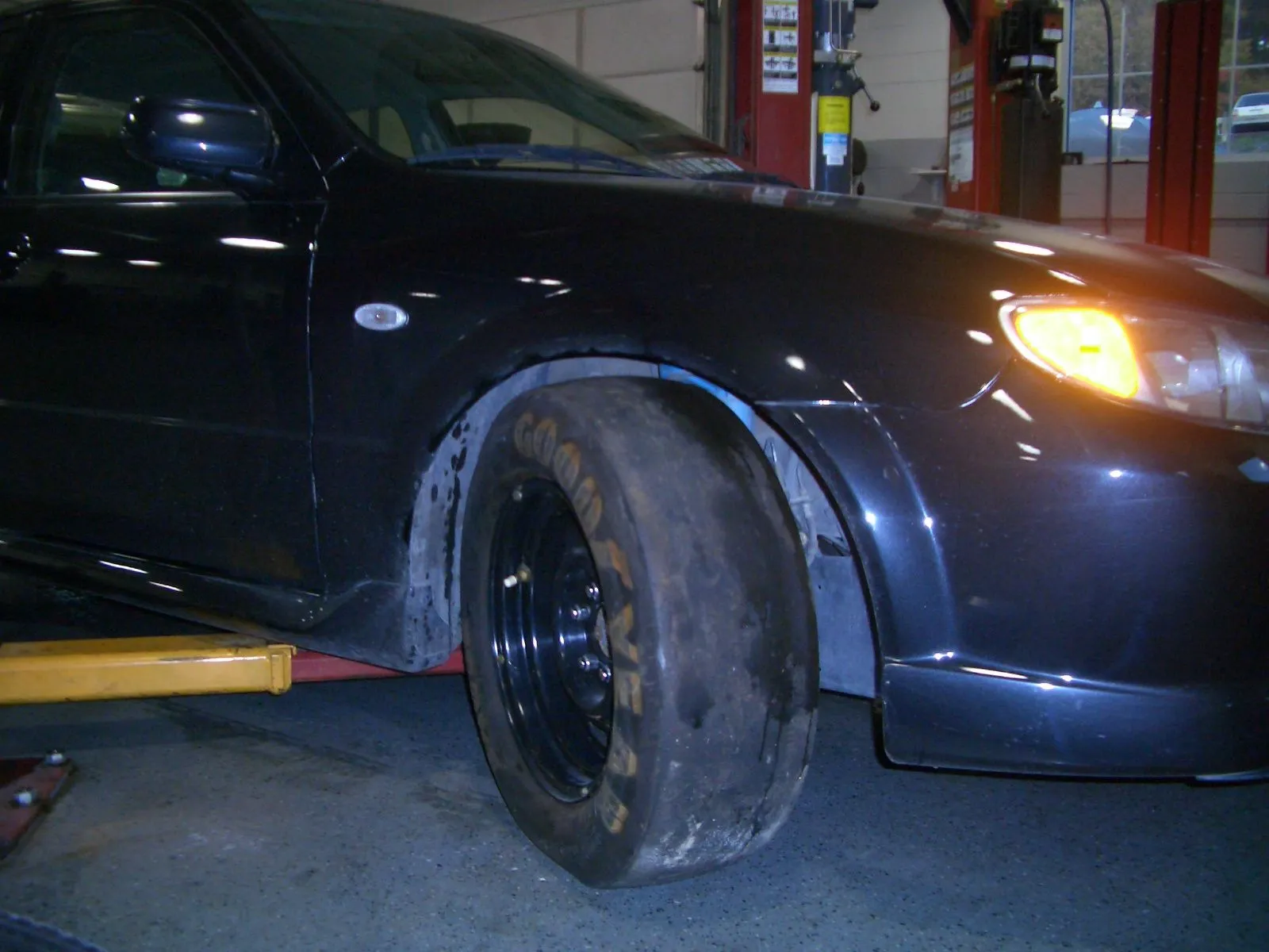

Instead of worring about gear ratios, just put taller tires on. 26/9/15 slicks fit good with the right wheels. PLus the slicks grow when at speed. You would be able to go 122mph in fourth and only be at 6500rpm.

How big can you go before you hit the strut anyway?

26/9/15 will never fit. The biggest that will fit are 24.5/8/15
really? I thought they fit rather well.

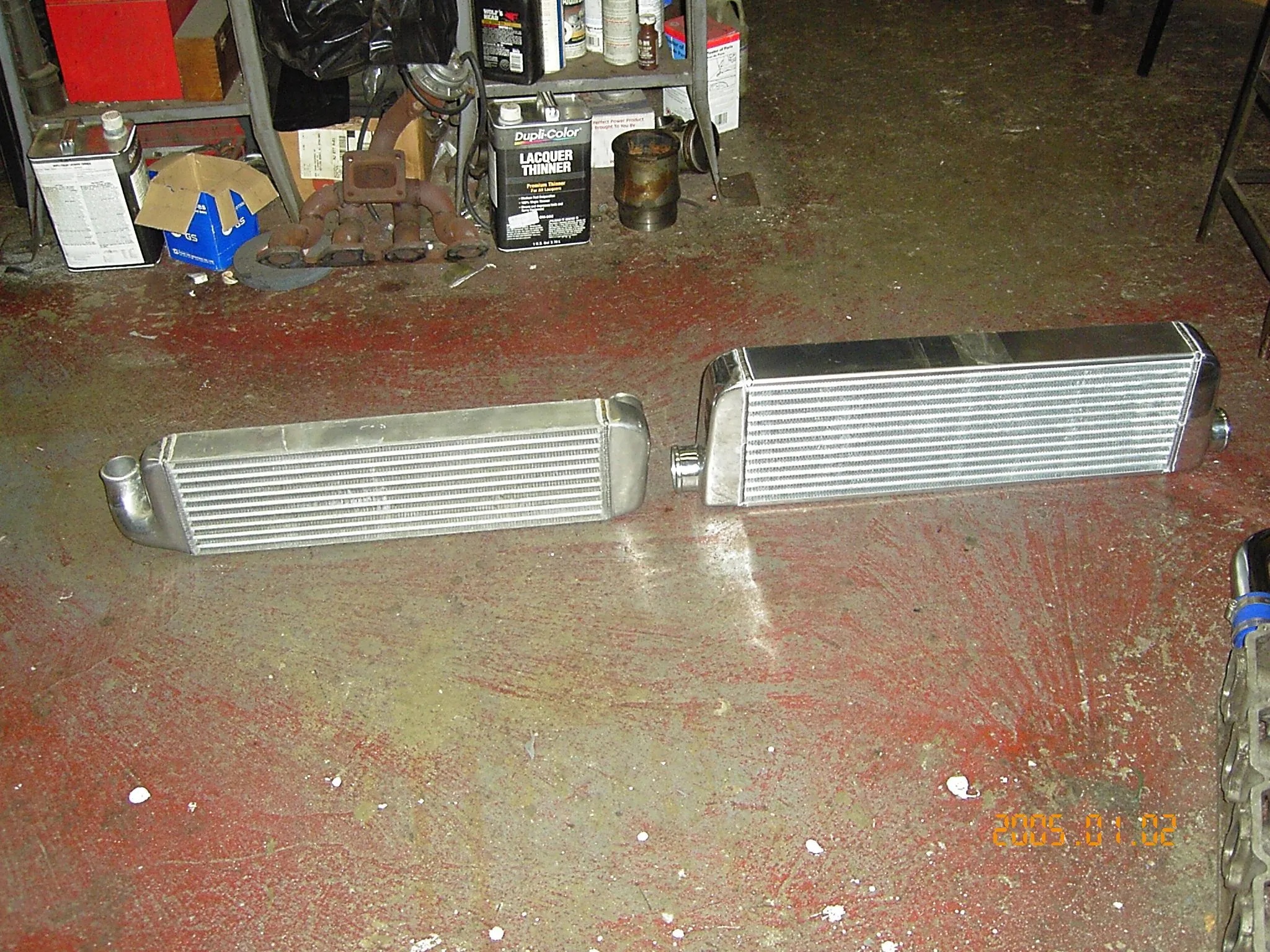

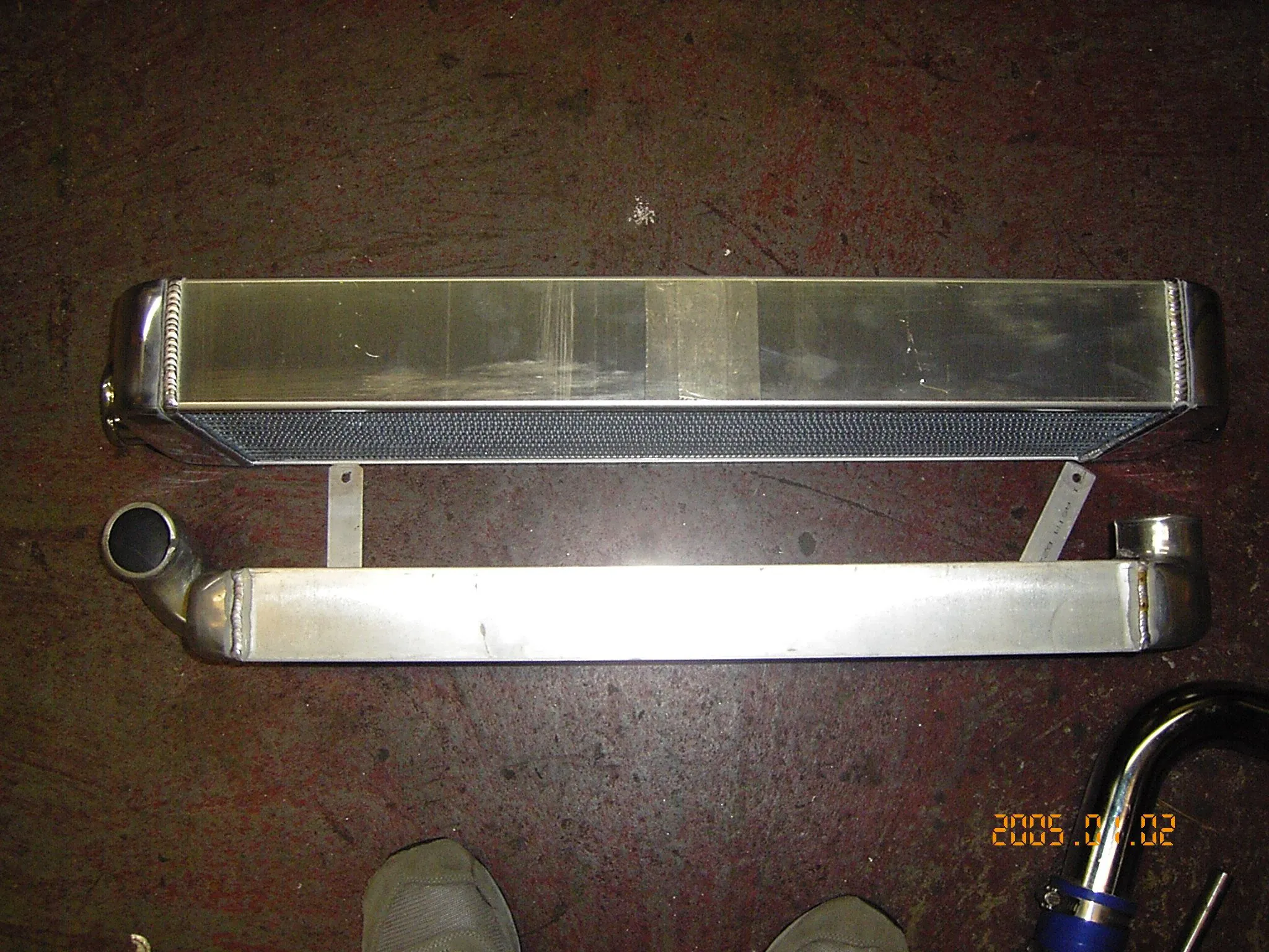

Well friday we recieved the new PWR intercooler, and i thought i would show you some pics of the core compared to my hiboost kit..
The PWR has an extruded tube and fin design, as opposed to Hiboost bar and plate,the new core measure 24x7.87x3 which should be good for around 415whp, ant the Hiboost was 22x6x2.5.
Heres some pics:

Yeah those are mounted on old chrysler cop wheels. I got lucky, just don't try to turn at any kind of speed.
That intercooler is huge...
The new core is 75% bigger then the old setup. Need all the tricks we can get out hands on with all of the stuff being done up north.
