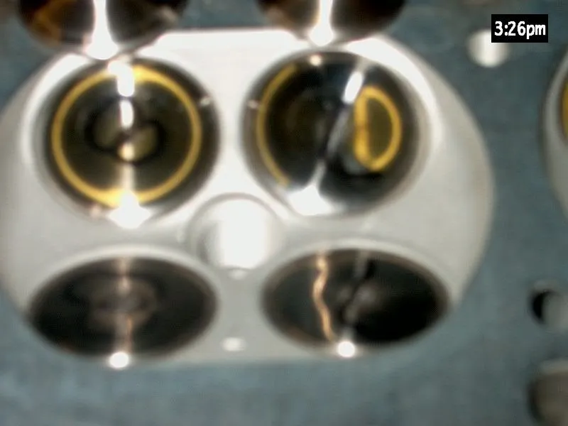

Other then bent valves I have not see any problem with stock valves. Were your valves bent, pitted on the face or the seats pounded? The exhaust are an alloy stainless steel from Mazda. Hard to find better set up for a turbo.

The intake valves look fine, but there is a lot of pitting and bubbling on the edges of those exhaust valves. They are pretty cooked.
Save your money, just do a 4 or 5 angle valve job on your head.

Did you clean them up first and look at them? I cannot tell if they are bad or not. I see the the chamber and valves are coated with both oil and carbon.

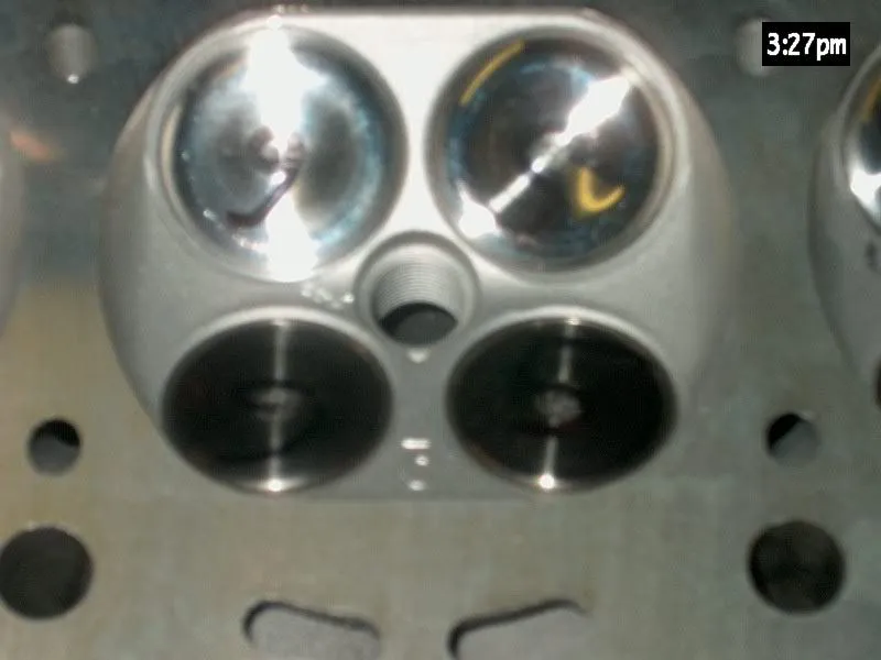

Are you looking for valves like this for your Protege?

Nice Nick they look even better than when i saw them the other day.(rockon)...also you got the other pic of the core?
Yeppers. You got options for me??? As of right now my only known option is custom Ferrea's.
If you can get those things in a timely manner Nick I'll place an order for them first thing tomorrow. Just let me know!
so their the stock ones you re-worked? or they were bought like that?
They are stock valves that we remachine. We can do for anyone, send in your valves and it will take about three days to do.
