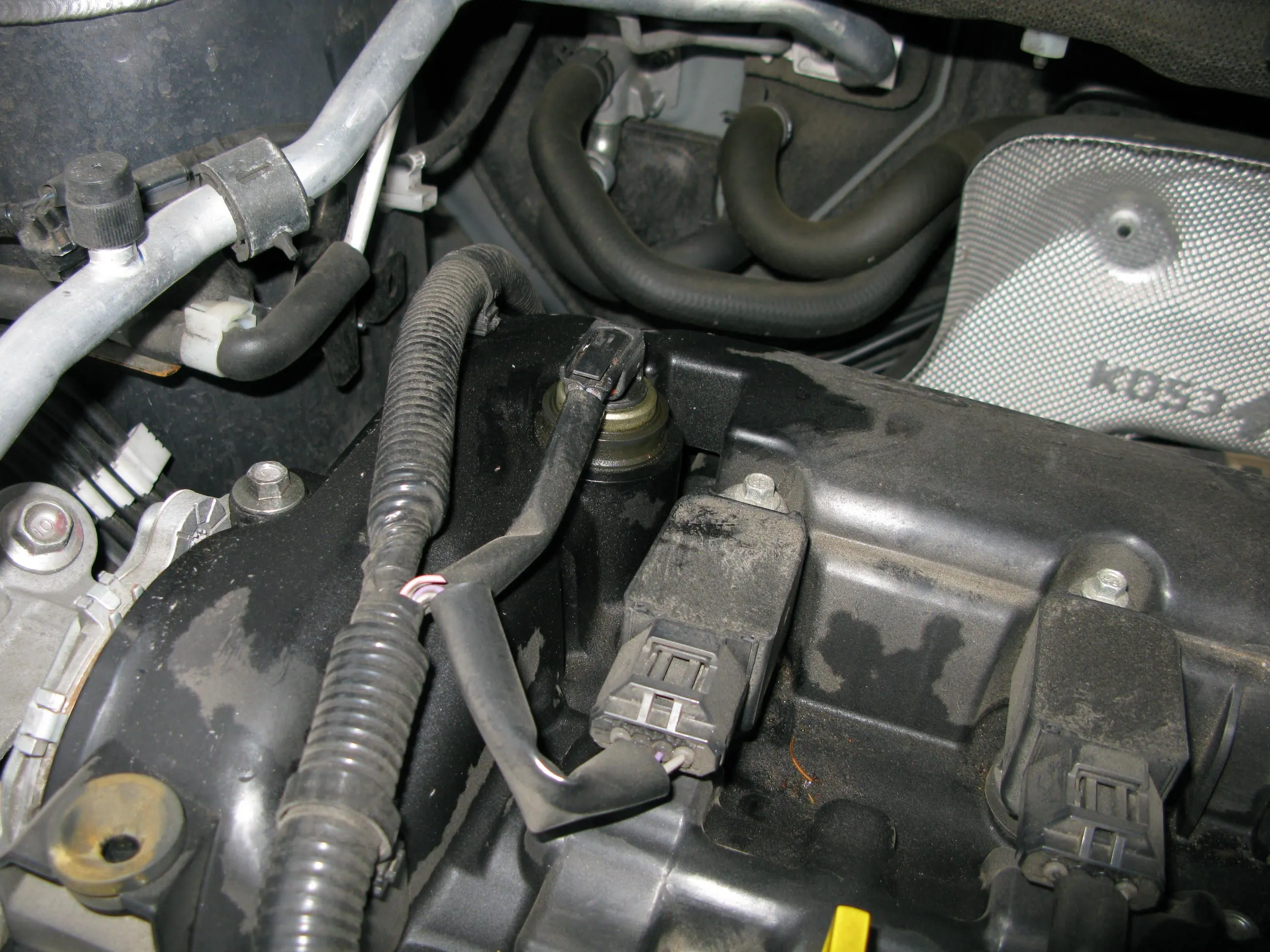

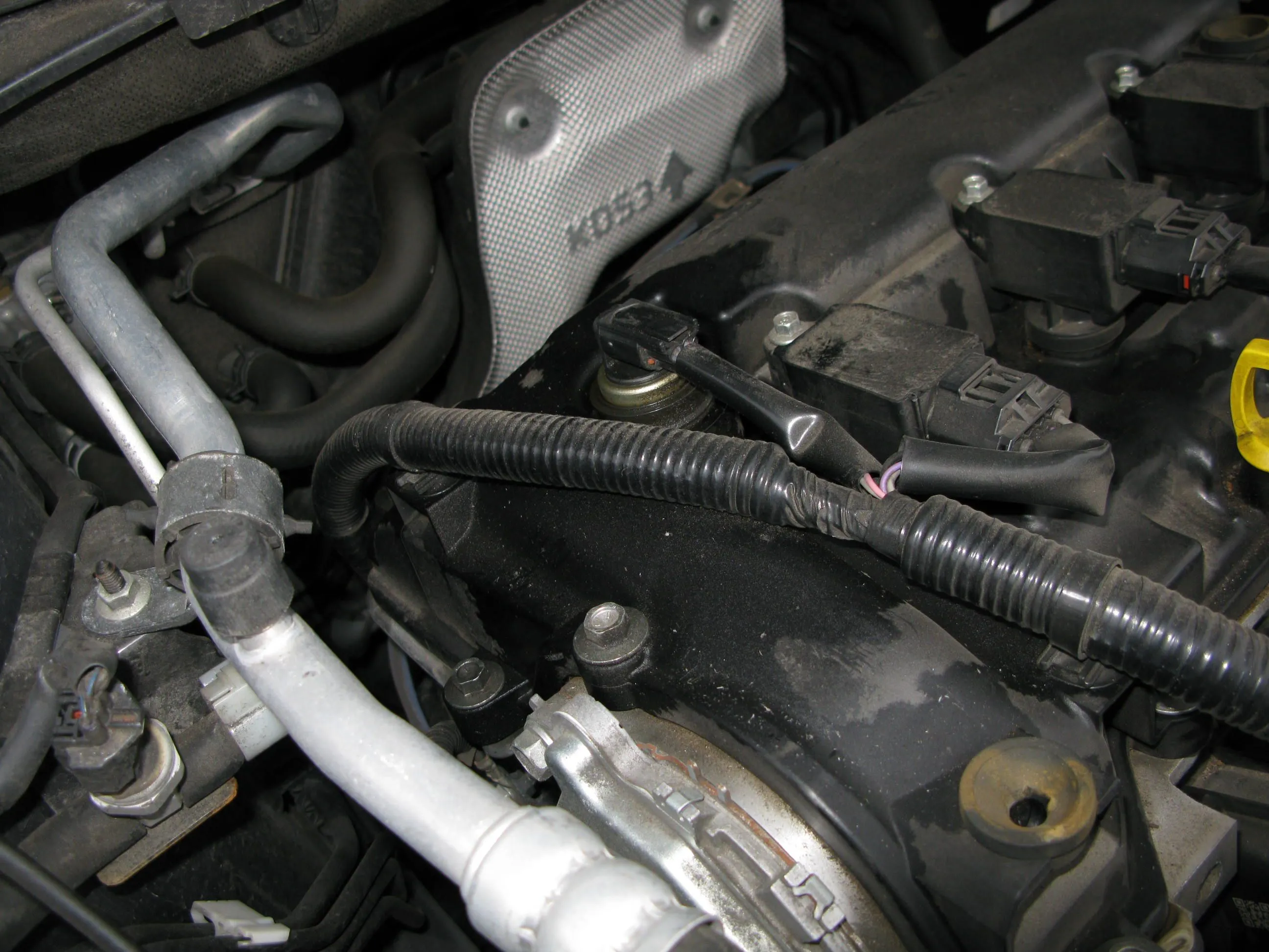

Top passenger side, there's an electrical connector to something about an inch in diameter into the valve cover, saw some one else post it on here a while back. I also noticed it on my stepdaughter's 2014 CX5, looks like a common problem area to me. I'll try to get a picture posted later.
attachment.php

It could if someone didn't pull the cover off to confirm. Mine was dry up on top though when I pulled cover.
That leak is caused by the pos early model of the OCV for the VVT. This is specifically addressed in a TSB. It is caused by a poorly engineered plastic to metal seal at the top where the electrical connector is. I just replaced my wife's with a new OCV, valve cover gasket and OCV to valve cover seal. Fortunately, this problem is big enough that you can buy the OCV seal separate now. Before you had to buy a whole new cam cover to just get the seal. My earlier silicone fix lasted about 10k, then the leak got worse as the valve seal deteriorated and the oil pressure on the silicone got higher. I got a good look at the top end, cam lobes, etc and everything looks like new. No sludge, etc. My OCI and M1 0W20 is working like a charm.
Good luck on trying to get any parts at all. My guy hooked me up with a couple dealers across the country that each had some of the different parts I needed and got everything in about 3 days. It's a b*tch to get at some of the nuts, harness clips, etc to move the main wiring harness out of the way to have clear access to remove/install the cam cover and remove the factory silicone at the 2 spots on the passenger side and the other 2 on the drivers side. I was gonna post a YouTube video, but was crunched for time and just wanted to get it done exactly like it was originally with no busted clips, etc. I can only imagine the Mazda monkeys breaking about 6 or 7 clips, not cleaning the seal surfaces perfectly and applying way to much silicone and probably in the wrong areas. I followed the FSM to the letter and used a pair of calipers and a sharpie to make marks exactly where and how long each bead had to be. I also cut the plastic nozzle to get the perfect bead width of ~0.25". Yeah, I'm a little OCD, but I only want to do a job once and do it right. Just turned 70k this weekend. Need to replace the alternator belt and water pump stretch belt and she should be good for another 70k.

I cleaned the top of the valve at the connector interface with brake clean and then put a healthy bead of permatex grey silicone around it. It worked well for about 10k, then started leaking through, so I did the repair. All in I paid about $250 or so for parts. Other than my first car, a new 80 rx7 and a 78 grand wagoneer college beater, I've never put more than 50k on my daily drivers, but I've had pretty good luck with the wife's 2015 CX5, so we'll see how it goes. She wants to get a new vehicle, but I keep convincing her to stick with it for now. I might just give her my 2012 CX9 GT AWD, as it only just turned 17k and I've changed rear diff, xfer, etc to full group V synthetics and it looks and smells brand new. Has full Weather Tech floor liners, full front coverage and mirrors clear bra, hard wired V1, upgraded tires, rotors and pads, etc. She just won't like the fuel mileage!
So yours actually started leaking around 60k, I think my stepdaughter is around 59k, noticed mine a few hundred ago, right now I'm nearing 71k. $250 in parts? Wow, can't imagine what a dealer would charge with labor.
