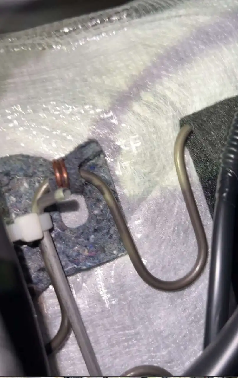

Started looking at the seat bottom and found something interesting with my 2022 seats.
The cross support beams connections below the seat cushion foam are not using the usual "straps" but Mazda used freaking zip ties which were not even tight enough. Its crazy.
Can somebody with 2023 check theirs? its tough to see it because of tight space..its seen from the bottom with good light and some poking between the cables.
May because of shortages or whatever the seat vendor did. So the seat foam bottom support flexes more than expected (uneven) if those zip ties are not tight enough. It puts your position out of wack for certain people body types.

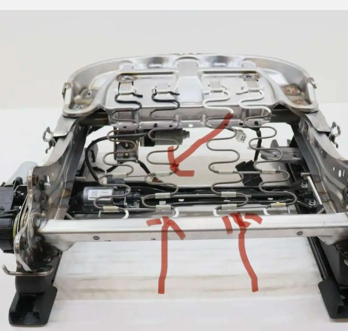

I did check my 2018 and they dont use zip ties but use the usual "strap holders" as in the picture below.
Also the support perpendicular thin metal bars are at different places on my 2022. dont know why. But may be thats ok.
here is how it supposed to be. the white parts (plastic straps). Tried to put arrow to some.

thats what I got which is not right. Its a long post :) So much for japanese quality control.
And this is the reason the seat cushion sagging on the left over time and then getting seat discomfort hitting the left bolster more vs having a more balanced/level position on the cushion.

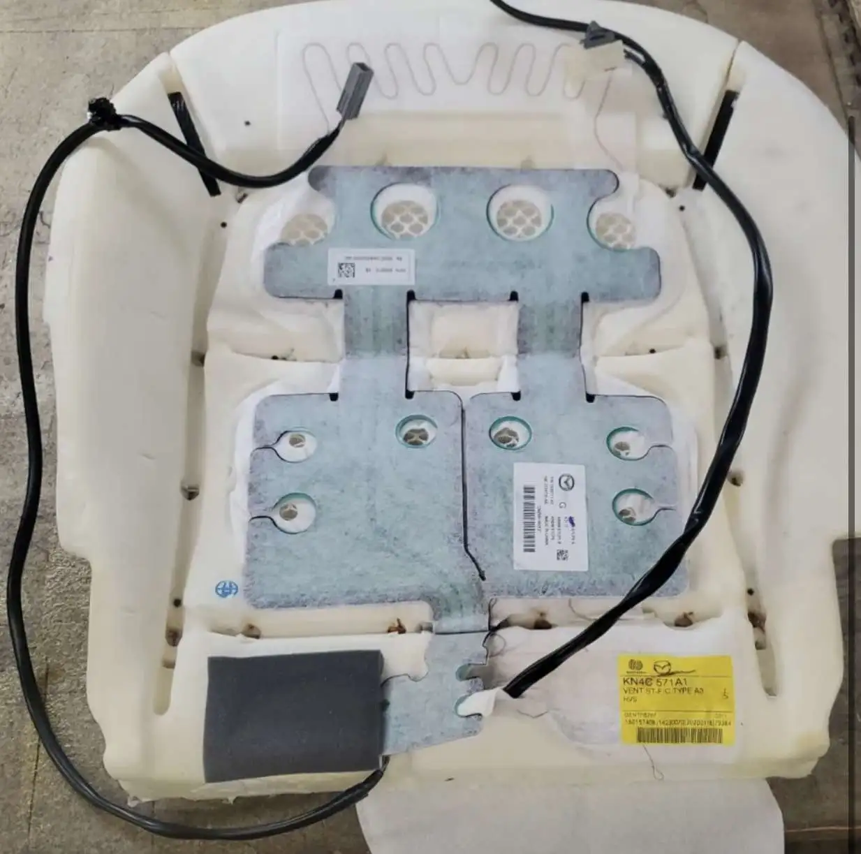

upong digging further its interesting to see that the ventilated cushion is totally different than the only heated ones. For those curious ventilated cushion has handful of larger holes in the structure for the exhaust fan tubes which probably makes it less resilient over time.

I have fixed the seats with the right clips. The purpose of the cross section is to keep all zig zag springs from bottoming out. If you bottom out you start hitting the bolster more because the seat is too narrow by design. Certain body types will have issues, others never.
