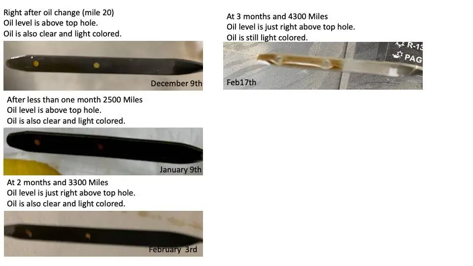

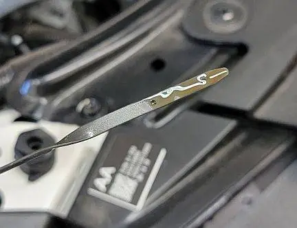

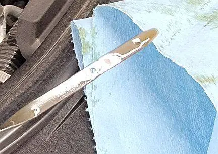

That sucks. I have been keeping an eye on my oil as well. For me, the oil use seems to have stabilized. Still slightly above the top hole. Sorry for the dark pictures. The oil is also still clean and can best been seen right at the top hole.
I see that you are close to 6000 miles from the last oil change. MY feeling was that the oil level dropped significantly after 4000 miles. My dealer said the same thing. So, I showed them the TSB and even printed it out and gave them a copy. They are doing 5000 mile oil changes now as well.
So, I am now at close to 4300 miles and just finished a 600 mile trip up the east coast. Beside averaging ~26 mpg I am happy to say, my oil level appear to be holding steady. Sorry for the bad pics, for some reason, todays picture came out much nicer! But basally, I can say that for some reason, the oil level has remained pretty much the same over 4300 miles.

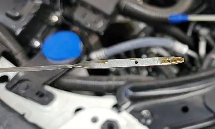

What would make the oil level be pretty good until roughly 4500-5000 miles? This is my oil level examination over 5000 miles. Up to 4300 miles, it looked good. A long drive south and at 5000 miles, it has gone from being right above the top hole to right in between the two. That is why if you try to do the 7500 mile oil change, it will not work. Everything will look good until 5000 miles and will go downhill after that.
There could be several explanations. What if you had been consuming oil but it was replaced with gas? Then a long drive could heat up the oil and boil off the gas.
But I think it's just as likely that the long drive just aspirated the oil. I think there is a tendency for that to happen and the reason you check your oil more frequently when traveling.
You could just add a pint now and it could last to 7500. Or just change it. I would wait until it's warmer as it's almost March now.
