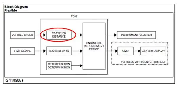

This just shows each car manufacture has its agenda to set up different parameters on OLM software. Most likely those OLM softwares are design some third party company features many parameters to twit. When Mazda just added Flexible OCI for 2016 MY, one of the bugs is when the 12 months duration passed, the OLM failed to display the notification if the miles accumulated is approaching 10,000 miles (Flexible OCI for 2016 MY CX-5 is 10,000 miles or 12 months whichever comes first). Mazda put out a TSB which updates the PCM to fix the following bugs:
• The oil change due notification does notcome on, even after mileage exceeded 10,000 miles.
• Oil life in the center display is still less than 40% even though the mileage exceeded 7,000 miles.
TSB No.: 01-008/19 ENGINE OIL FLEXIBLE MAINTENANCE NOTIFICATION DOES NOT WORK
Be aware that “this repair will be covered under Mazda’s Federal Emission Warranty (long term) or Calif. PZEV Emission Warranty.
So many 2016 CX-5 owners should be able to get free PCM update based on this TSB as this repair is covered under Federal Emission Defect Warranty which is 96 months or 80,000 miles whichever comes first.
