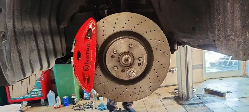

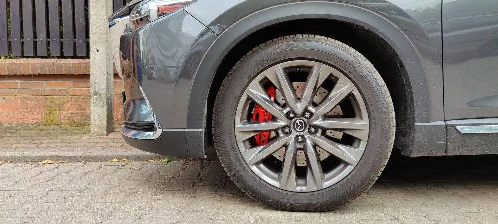

2020 CX-9 Big brake upgrade (similar to Brembo)
what set up is that? Please lmk. Love the wheels. Why you tease me this way šŸ˜¢šŸ˜€ lol
Tires are Falken Azeni FK510, 265/40/21, so wheels are definitely 21s. The rims look like HRE P111SC, which are monoblock wheels forged from 6061-T6 forged aluminum. I've never seen HREs with that centercap, which appears to say NEO or NSD or something along those lines. The finish also appears to be quite inconsistent, with it looking like rose gold in some areas and satin silver in others. It may just be the lighting, but I doubt it. There's a chance that these are replicas.
Not sure on brand of rotors, but they look legit (albeit way too aggressive for street use, probably). Calipers are not Brembo - if you look closely you'll see that they are just Brembo caliper covers.
In any event, the entire setup does look great! All it's missing IMO is a 1.5" drop.

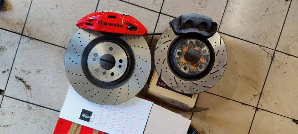

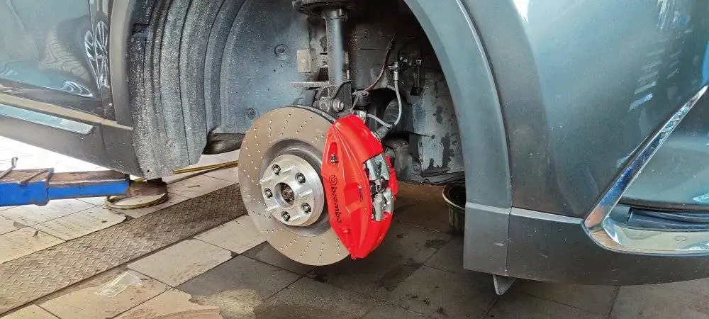

Thanks for the information. You have a good eye. The member did reply to me and sent me pics. I’m not interested in his wheels though they are nice. They are NES forged 21ā€ wheels he stated.
mad for the calipers I am highly interested in that. Do not want any cover but actual calipers.
he sent me a pic of the and the mm he used. Know noting about that but I’ll try to copy the pic on my tread here. Hope the gentleman doesn’t mind
they look like legit calipers from what what he sent me. He said no special brackets are necessary. I’m ready to buy A pair if I can get the correct configurations. Mazda should offer this option as an upgrade if anything. If not when I have more time I’ll contact Brembo to see if they can help me
I'll recant my previous statement about the Brembos not being real. Something about them looked a bit off, but it's not like I have a ton of experience with BBKs to really know what I'm talking about 🤣
Keep us posted on what Brembo says, and whether you can get a parts listing and price breakdown.

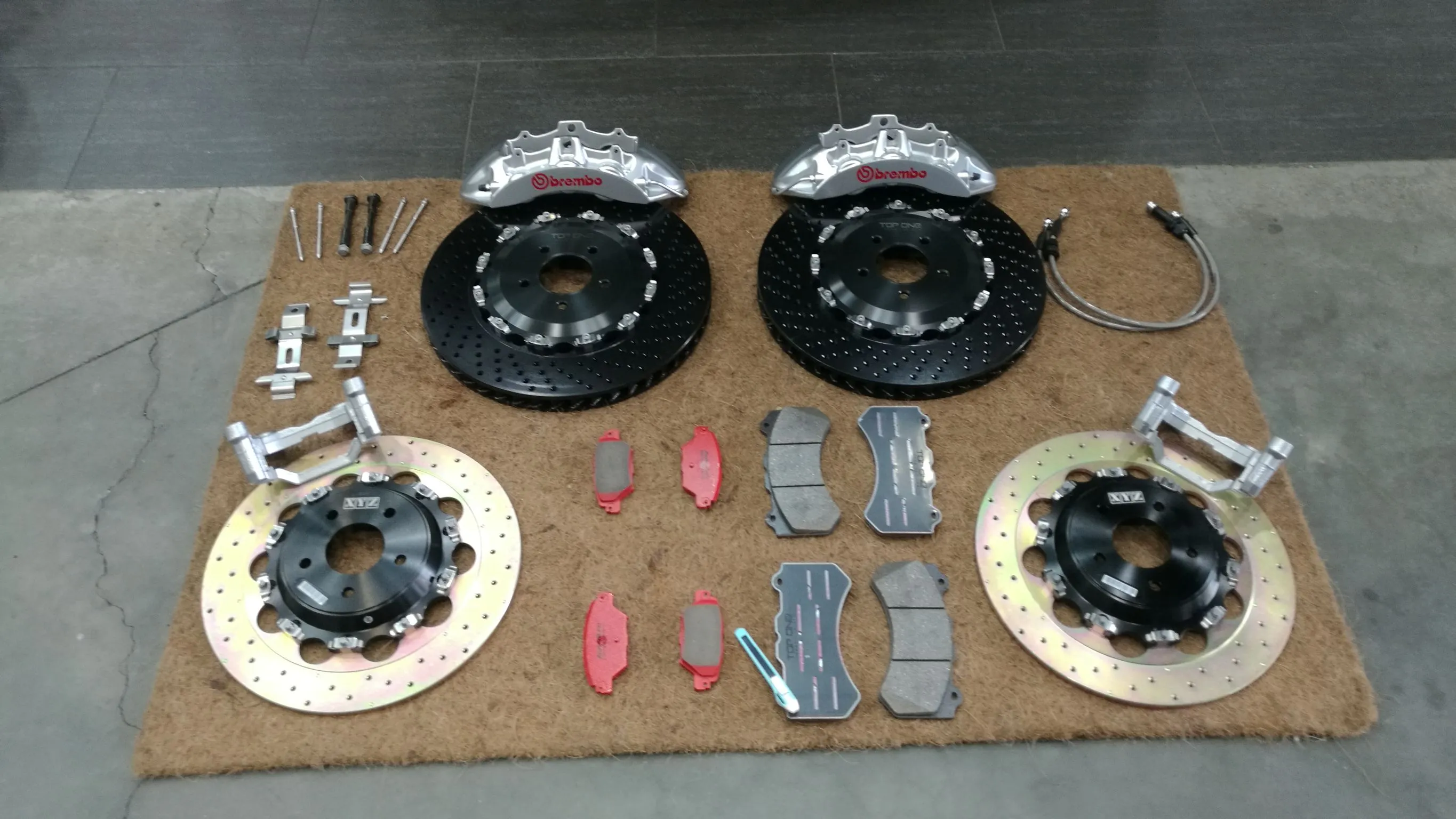

Nonetheless I have been trying to enjoy life family and this cx9. I purchased summer wheels for it that I never put on them to compliment this tread about the brembos. Contacted brembo and they were not helpful in the least. One foreign member fromChina gave me some tips but wouldn’t share which brembos he used exactly an/ or modified to fit. However cieka has helped out the most with providing templates and measurements that will fit my options on the cx9. Ceika is very expensive especially with the options I provided with oem 20’s and bigger am summer wheels. Though they Won’t really give me a deal despite haggling w them, again they gave me diagram/ templates I can share with you. ( will post soon once I take pics). Now I autocrosson occasion with my hooptee nissan, lol šŸ˜† and old bmw forum buddies, and a few very mechanically knowledgeable (not as ignorant as me w cars, lol), have toldme over the summer that with these template measurements and maybe a bracket they feel a brembo caliper out their might work for the front. The 1000000 Question is which one! I hope this helps and I’ll post the templates pics soon but overall I don’t know if I’ll get back on this caliper upgrade mission until after Christmas.
Thanks for posting that. I've also had zero luck getting anyone interested in trying to make something for this car. It's just not something most people want, apparently. I even tried to get a one off Wilwood set made, but got nowhere with that.
If you got the dough to get a one off maybe you can consider the following...
Grab a set of r35 gtr calipers, get some evo x 67.1 hub size rotors, get a machine shop to mill you the adapters. For the rear, get model s ebrake calipers to keep your ebrake function
Thank you for that info. Something to look into. Never thought the ctr caliper could work. For their price though I think cieka can through in the rotors and pads. I’ll start up working on this later on the end of the yr when I’ll get some off time.

The Nissan Akebono BBKs should be a more feasible route as they are readily available and reasonably priced at sub $1k. And then pair with Evo X 350mm rotors. Hurdle #1 would be machining the adapter for the front brakes. Hurdle #2 is needing to fab an adapter to mount the rear brake and also the Tesla e-brake. Hurdle #3 is figuring out how to wire from Mazda 3-Pin (I think) to Tesla 4-Pin plug for the e-brake.
I would imagine one can piece this together for about $2.5k. Hope this post can be an encouragement for someone to turn this into a reality.
