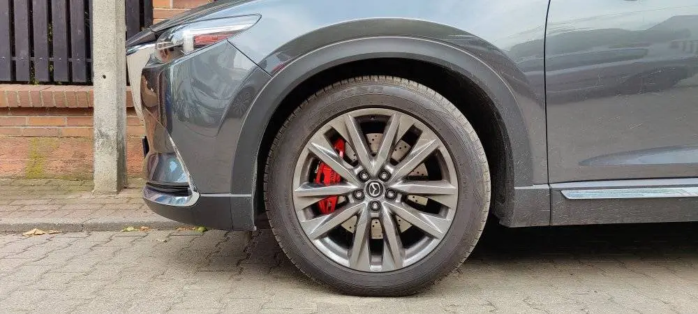

The biggest problem is with the adapter. A well-made adapter and matching caliper do the trick. Find BagCorp on FB. It already has everything you need to convert to BBK. Braking is a fairy tale! Now you have 375mm disc (~15in). For original rims, you must also use distances of min. 22mm (0.866in). I also put braided wires.
Price for this set is ~1400$
@Raceready that looks Fantastic! How is your braking now?
What about the antilock? Still good?
Also can you post some more pics? Maybe one from farther away..?
Now braking is not slowing down :) ABS is still OK, no issues or anything. Now another mod :) 299Hp and 470Nm on stock exhaust, air intake and intercooler but on PB98 / Shell VPower 100 (On PB95 264HP/470Nm) Pictures soon.

@Raceready Looks excellent man. Love your progress. Shops here in my region were bunch of delays and trying to milk more money out of me. Even have a set of new 23 in wheels to make the fab pop out when done but the project went to closet. Now your bmw calipers and the Cadillac brembos are what seems compatible for the cx9. And your right the bracket fabrication is the issue. Your project price was for all 4 wheels or just the front?
