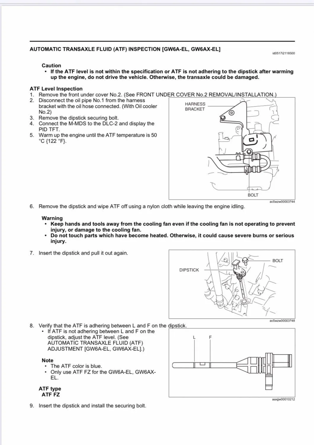

No you don’t really need a Mazda computer to check the ATF level. You can use the blue cold coolant temperature indicator on gen-1 CX-5, or use a cheap OBDII reader to get ATF temperature which is good enough while taking the read on ATF level with dipstick.
Now, if your 2020 CX-5 has the 2.5T, then you might just forget about the ATF level checking as the turbo plumbing is almost totally blocked the access to ATF dipstick!

Unfortunately many 2.5L owners who did the ATF change and found the ATF level from factory was low.
If you have a 2.5L, it’s not that difficult to check ATF level.

I'm wondering if anyone owning a 2.5T has tried to access the ATF dipstick via the coolant drain service hole, located on cover #1 (driver side). During the oil change I did last week, I removed that service hole cover and discovered that I can easily reach the ATF dipstick on my 2020 2.5L. And my daughter's 2019 2.5L has the same configuration as well.
Although accessing the dipstick via this service hole would be blind, I don't think that's an issue because it can be pulled straight up, and then out the hole for observation. No idea if there's something in the way down there on the 2.5T, but it's a clear pathway to the dipstick on the 2.5L. Wouldn't take more than 5 minutes for someone with a 2.5T to check it out.
