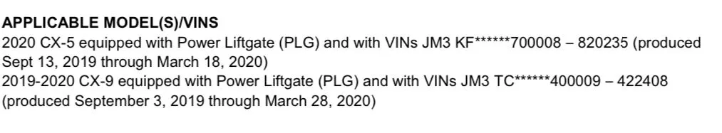

Special Service Program (SSP) C2 - 2020 CX-5 and 2020 CX-9 - Power LiftGate (PLG) Control Unit Concern
September 2020
What is the reason of this notice?
On certain subject vehicles, the Power LiftGate (PLG) Control Unit may not switch to the power saving mode even after pressing the push button start and setting the ignition to the off position, due to improper control logic of the PLG Control Unit. In this condition, if the vehicle is left unused for a certain amount of time, the battery may discharge and run out.
Service Alert No.: SA-049/20 (4/30/2020) ENGINE NO START DUE TO LOW BATTERY VOLTAGE
Service Alert No.: SA-049/20 (7/31/2020) ENGINE NO START DUE TO LOW BATTERY VOLTAGE

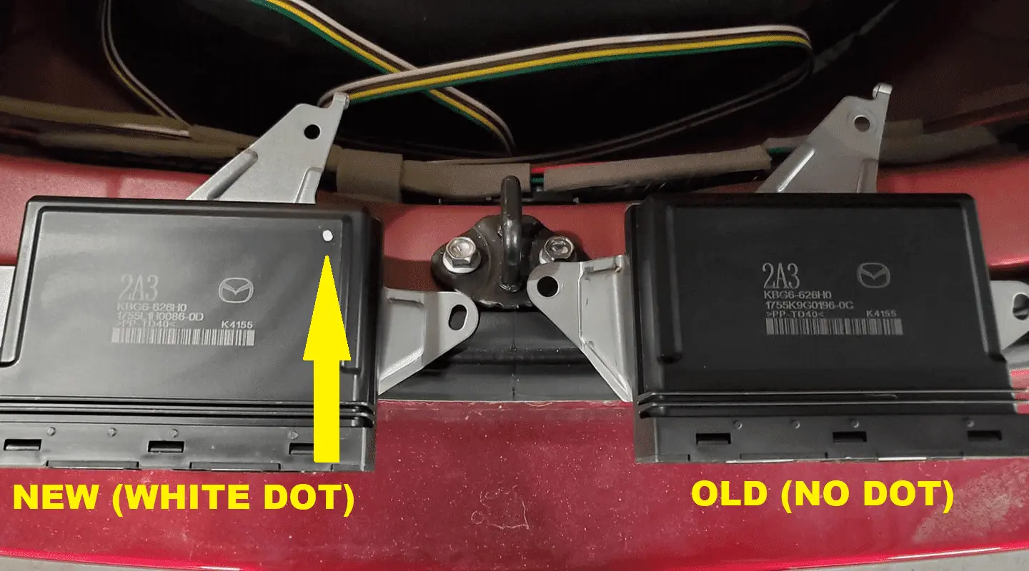

They got a bad (defective) batch of modules from their supplier. Also effects some 2019-2020 CX-9s.
They got a bad (defective) batch of modules from their supplier. Also effects some 2019-2020 CX-9s.View attachment 229032View attachment 229033
But Mazda’s SSP C2 said it’s software issue in PLG control unit. The revised PLG control unit has a white dot with updated firmware in there.
September 2020
On certain subject vehicles, the Power LiftGate (PLG) Control Unit May not switch to the power saving mode even after pressing the push button start and setting the ignition to the off position, due to improper control logic of the PLG Control Unit. In this condition, if the vehicle is left unused for a certain amount of time, the battery may discharge and run out.
