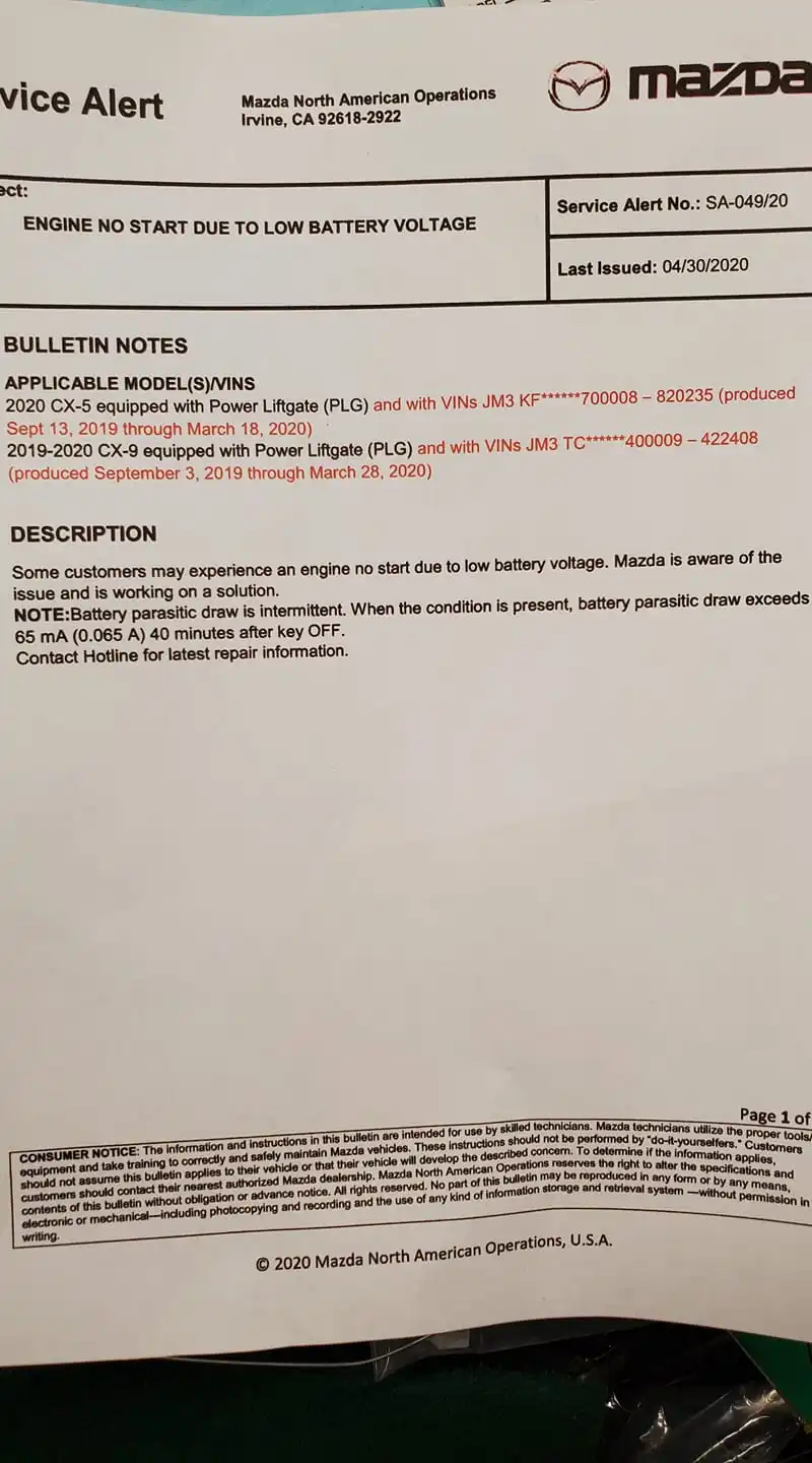

My thanks for posting the TSB as well. My battery has failed twice. Once in the first week of ownership and a second time 2 months later in late April just before this TSB was issued. Dealer found nothing at that time but this TSB will certainly help. Hopefully Mazda has or will come up with a permanent solution.
Here you go...
The TSB simply refers dealers to call Mazda if a 2020 CX-5 or 2019-2020 CX-9 with the power liftgate won't start due to a low battery.
TSB SA-049/20 has been updated with production dates and VIN ranges.
The following 2020 CX-5s equipped with a power liftgate are potentially affected:
VINs JM3KFxxxxxx700008-820235 produced from September 13, 2019 through March 18, 2020.

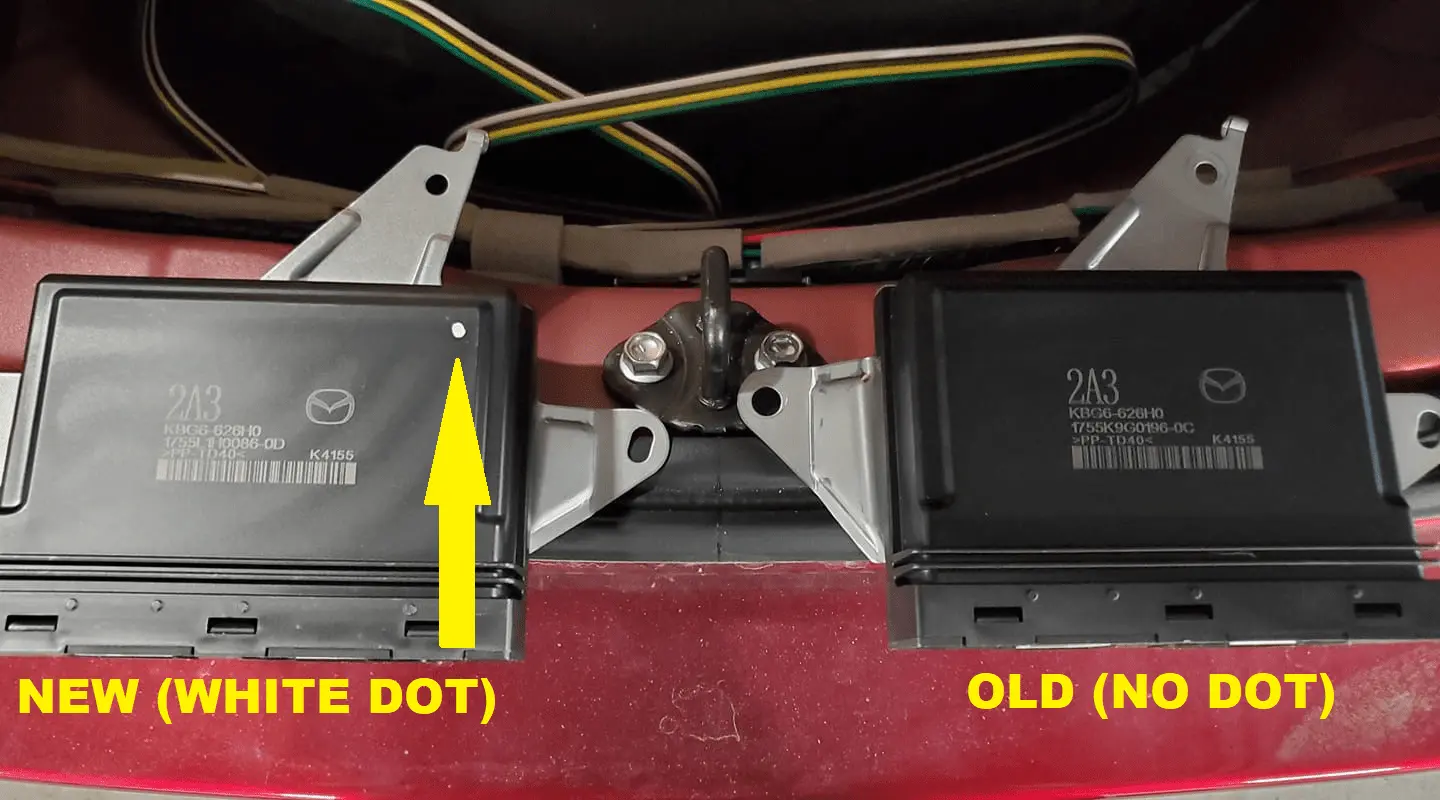

Mazda began installing the updated part after March 18, 2020. All replacements ordered will be the "new" part. The "new" part has the same part number, but will have a white paint dot.

Why can you just show Service Alert SA-049/20 posted in post #23 above by zroger73 to your Mazda dealer, and have them to get Power Liftgate Control Module KBG6-62-6H0 and even the battery replaced?
I did, that service alert says mazda is “working on a solution”, so my dealer isnt convinced the powerlift gate module is the root cause of the issue :(

Well that’s pretty uncooperative and unhelpful if you are experiencing the parasitic draw / dead battery problem. I’m the original poster who did have this problem in late April / early May for a 2020 CX5 Signature and my dealer after not being able to figure it out themselves did call the Mazda hotline who advised them that the solution was to replace the rear lift gate control module (part # KBG6626H0C/1). That solved the problem. It’s been 3 months since that was done and we’ve had no dead battery problems. Keep on your dealer and don’t be shy about politely elevating it.
