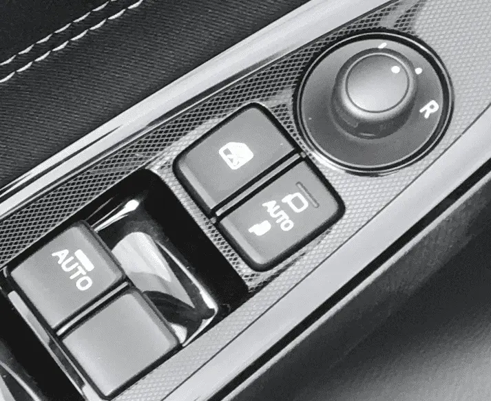

Some models/markets have that switch where you can select 3 modes:
Unfolded, Auto or folded, it is convenient for manual control or for example keep them always unfolded.
