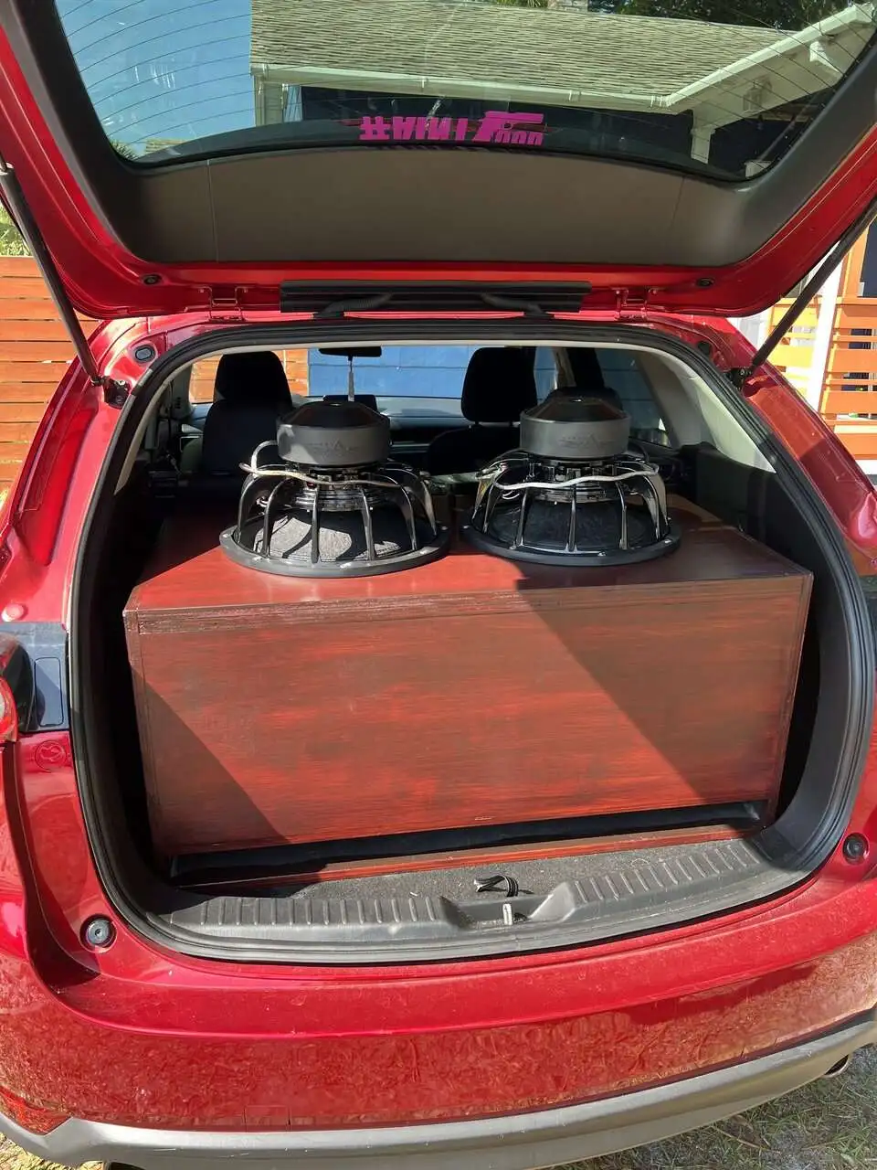

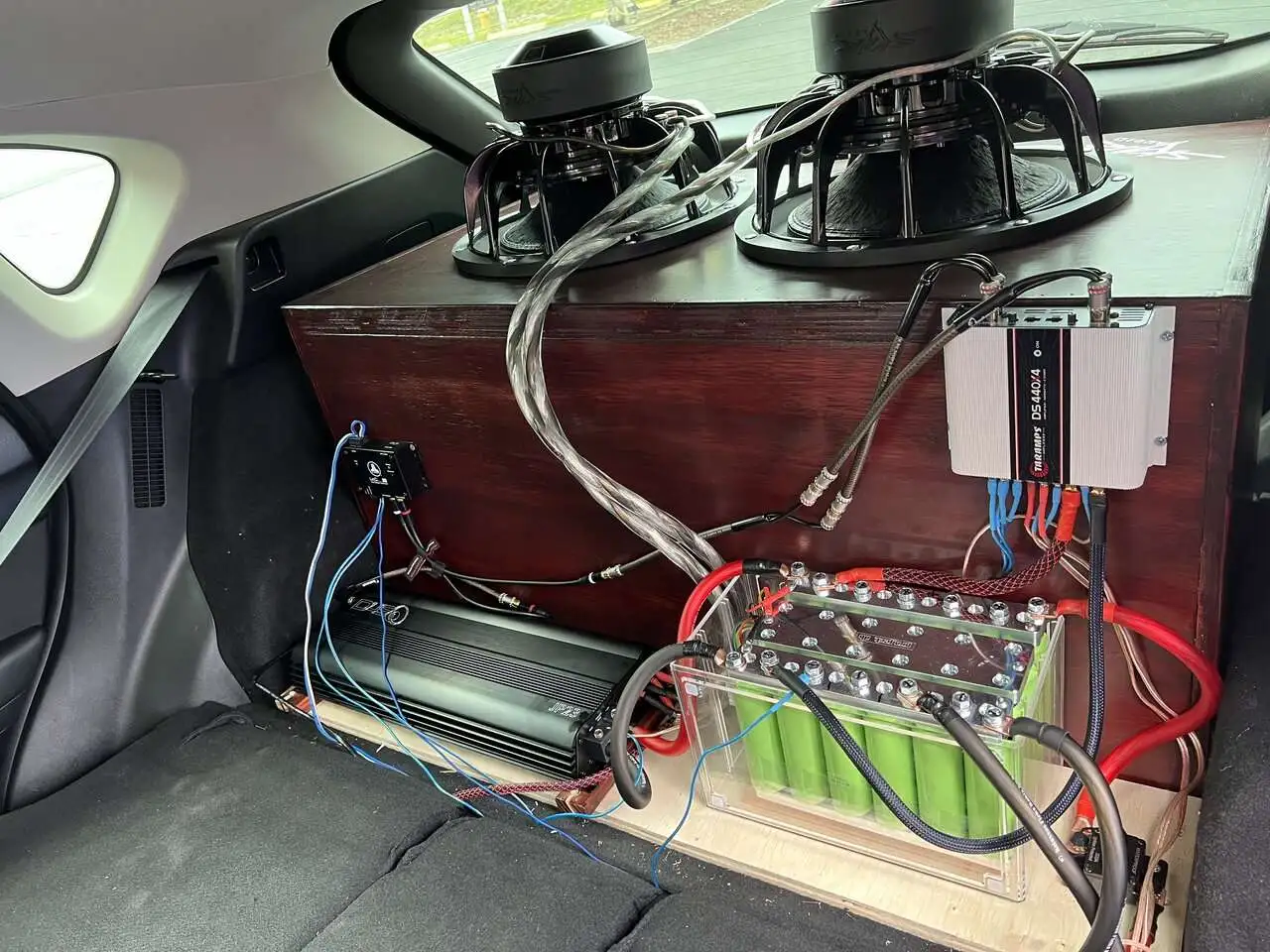

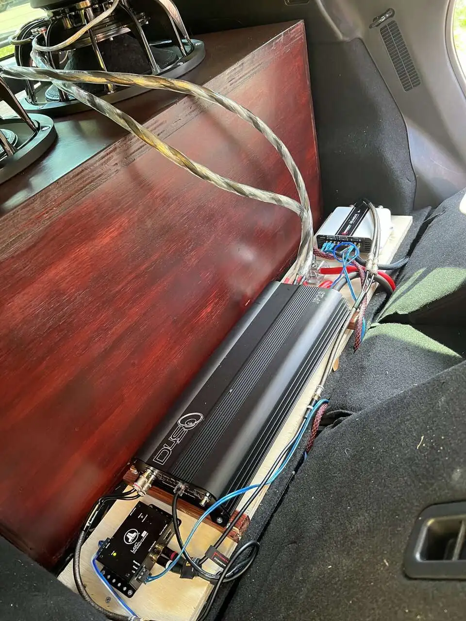

I’ve actually taken a different route at this point. I’ve ordered 48ah of headway lithium, and an Ioxus Supercap (mostly for its battery starting option in a case that the lithium over discharges and leaves me stranded) and am doing a full battery delete. Still waiting on everything to come in, but this should get me to being able to run roughly 6k watts and stay around 13V. I could probably push it to 8k if I was ok with dropping into low 12s again. Also, another upgrade on my system since the last time I checked in here.
Updates: Removed my stock battery now, and am running a 4S6P Headway lithium bank (48ah) using red headway 38120 cells (24 of them) and projectdb busbars. Previously my voltage would drop into low 11s with the JP23, now my absolute lowest drops are at 12.9V and that's under heavy load (Floating at 13.3, peaking around 13.8V). This made for a HUGE upgrade as far as available power. Now looking for a way to bypass the voltage regulator so it will charge at 14.4V all the time.
